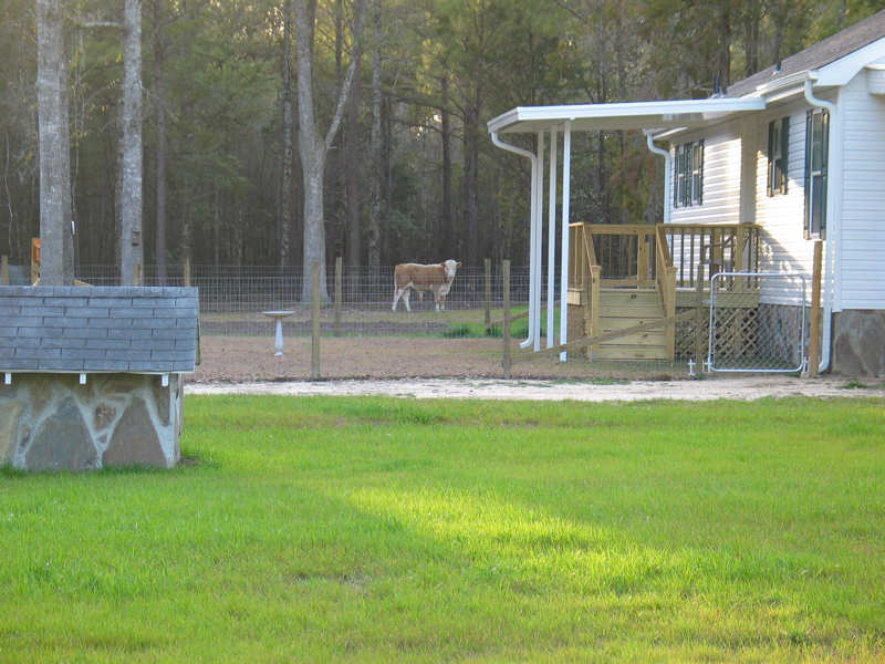

David,
In the picture I attached you can see most of the pump house I built for our well. I just dug a footer and poured some concrete, used some left over block I had, and then covered the block with some stone I had left over that I had used to cover my foundation block walls.
I also made the roof removable and added some insulation. Here in the Panhandle it gets into the 20's during the winter.
It works well to cover the pump controller, pressure switch and tank.
If you have any left over block and brick from your new home that might be something to build with.
Stu

PSDStu,
That is about the size well house I need, maybe even a little smaller. My tank and controler is in the basement, all I have exposed is about 3'of pipe. So I hope this temporary fix hold up until spring or at least till cold nights let-up.
