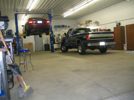

I’m looking to insulate my ceiling and was looking for some good ides. My thought right now is to just use faced insulation and then drywall. Anybody have any other ideas? My trusses are 16”oc.

I used foil board insulation screwed to the trusses. I taped the joints with foil tape. I put the fiberglass insulation above. It is a great insulation and it reflects light great. I didn't have to deal with the finish and paint. If you want pretty go the other routes. In my " pretty " shop I used metal roofing as a finished ceiling. Not cheap, but tough.
   / Insulating my pole barn ceiling #10
I used the same metal thats on the outside for my celling
It comes painted /forums/images/graemlins/smirk.gif then blew the insulation in on top.
I had thought about droping it down to 10ft, glad I didnt
the new lift will make being me a little easier /forums/images/graemlins/tongue.gif
