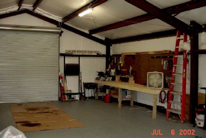

I put up a 30'x40'x10' metal building a little over 3 years ago. I bought a prefab building kit with an insulation option. The insulation came in rolls 6' wide precut to length to go from eave to eave. I just rolled out the insulation from one eave to the other, layed the metal sheets on it, and screwed them down. worked out great. The insulation was backed by a nylon (?) reinforced white vinyl backing. Picture attached.
