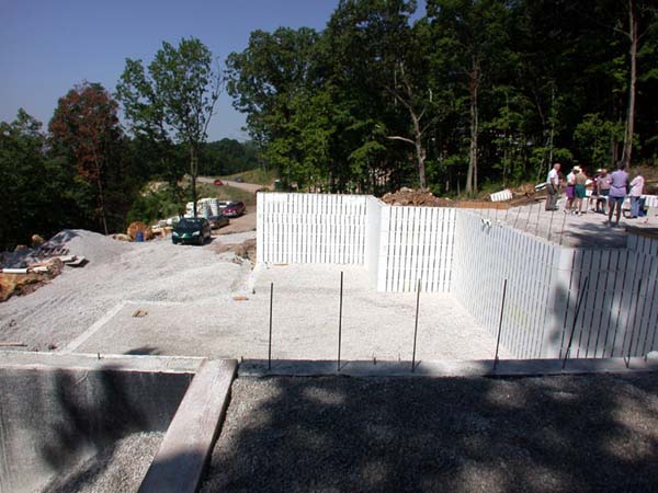

Here's a shot of an ICF foundation that is almost complete. It's a complicated layout that would be difficult with conventional forms. Notice the varying wall heights.

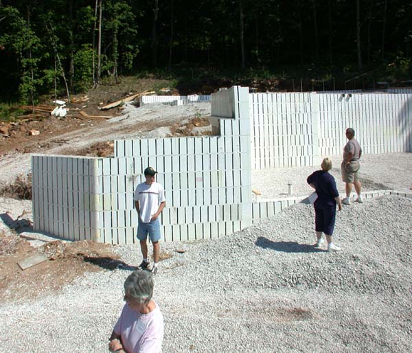

This is another view, back down the driveway toward the entrance road. BTW, this is NOT my place.
