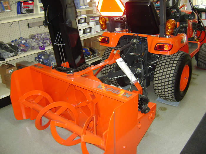

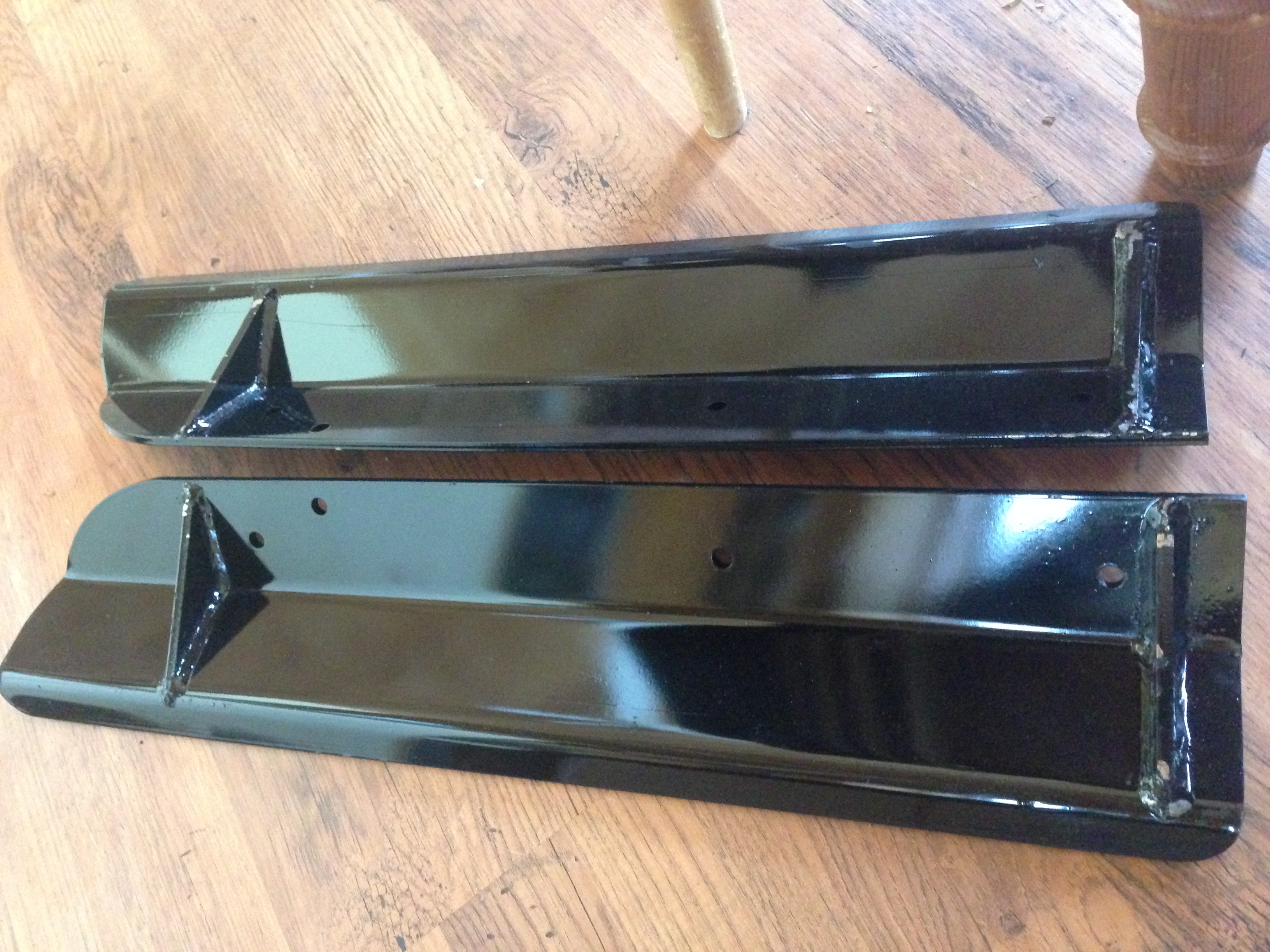

I recently bought bough wings for my B2789 blower, and they came with no hardware and no instructions, not can I find anything on the Kubota website. here is what the parts look like, and here is what the blower looks like.
Does anyone have these, and/or know how they are mounted? Any advice would be much appreciated!

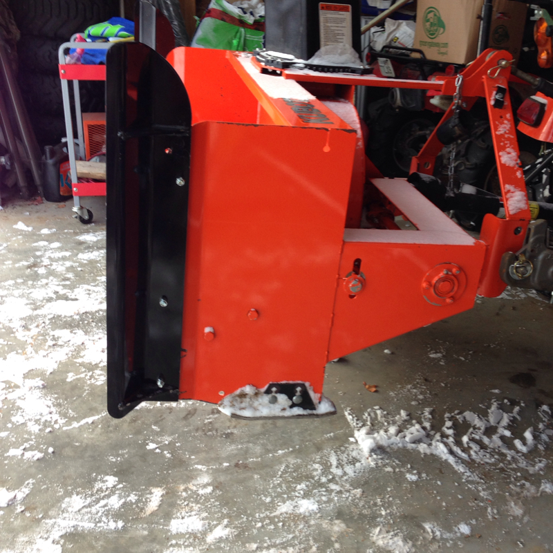

Odd it didn't come with the directions or bolts. Mine did a couple years ago.
Assuming it is the L2177 kit that I put on my L2674 blower you need six 3/8" by 1-1/4" bolts and serrated flange nuts (or a washer and locknut).
I started with drilling the the middle hole. Dimensions for that according the the paper I have; from the top edge of the blower the middle bolt hole is 13 3/4" down on a B2789 and 16" on the BL2664 and L2674. From the rear most edge of the blower the bolt hole is 1-1/4" toward the front of the tractor/blower on B2789 and 2" on the BL2664 and L2674. Get the drift cutter parallel with the blower and drill the remaining holes. Pretty easy.
Below is a mounted picture.
Hope that helps!
