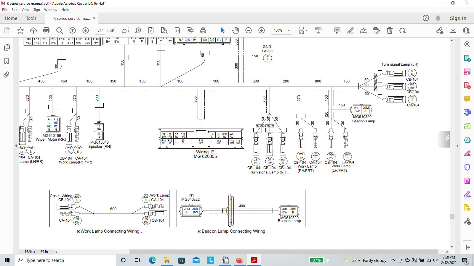

I have a manual for a K78 in the electrical section it seems that the beacon gets power when the left front work lamp does.
So the beacon would only work when the front work lamps are turned on.
Have you checked for power with them turned on?
Also I think I have to have at least the parking lights on to be able to get the work lights on.

Thanks LouNY. This is invaluable. When it gets above -23C here, I'll go over to the shop and try that out. Seems strange that it is linked to the work lights instead of the Hazard lights. Still, now there is a chance that I don't have to run a new circuit. I'll let you know how/if it works.

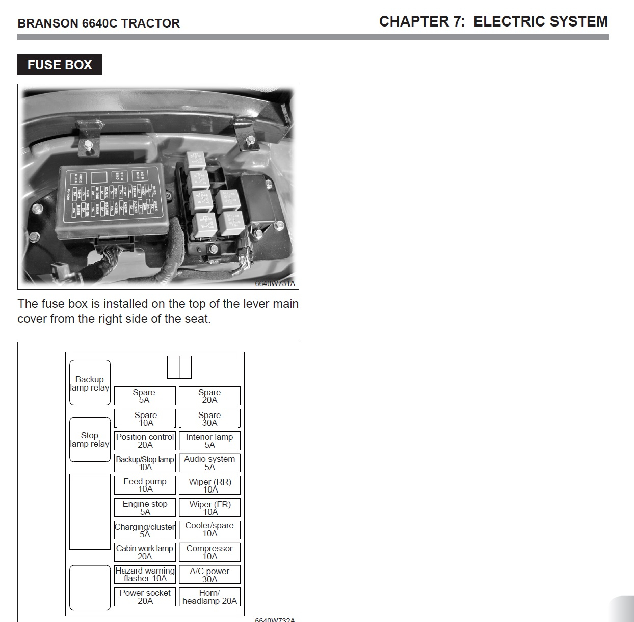

Well, the saga continues... Blew the Main Lights and Work Lamp fuse. May not be related to the safety beacon because I had no connected it yet. However, the 6640c operators manual does not show the location of the fuse panel. I have searched everywhere I can think of to no avail. So, does anyone know where the main fuse panel is on a 6640c?

Here is the location of the fuse box. I took a couple screenshots of the service manual.
And here is the link to the service manual in case you don't have it yet. 6640.pdf
I couldn't find anything about the beacon on this manual though.

ptsg, can't thank you enough. Branson documentation could be improved a lot and no one would complain! Of course my 6640 came with the fridge/food warmer and the fuse panel had to be located under a panel, under the fridge unit didn't it?! Well, all back up and running now but still a bit of a challenge with the beacon. With serious weather coming in tonight that is a problem for another day. Thanks again everyone for your kindness and help. Ptsg; thank you especially for the service manual. I'll let you guys know how the beacon install goes when I eventually get it working.
