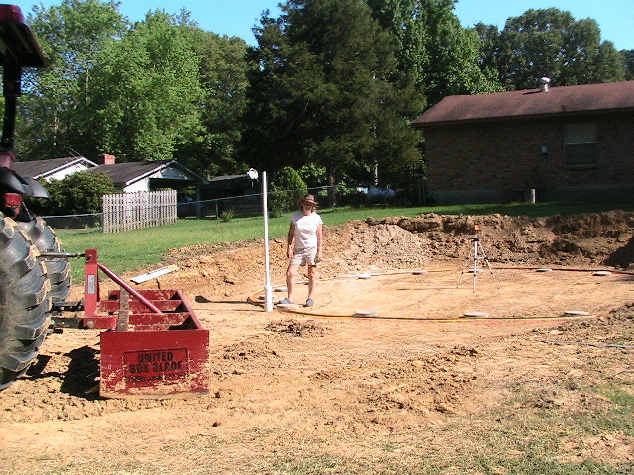

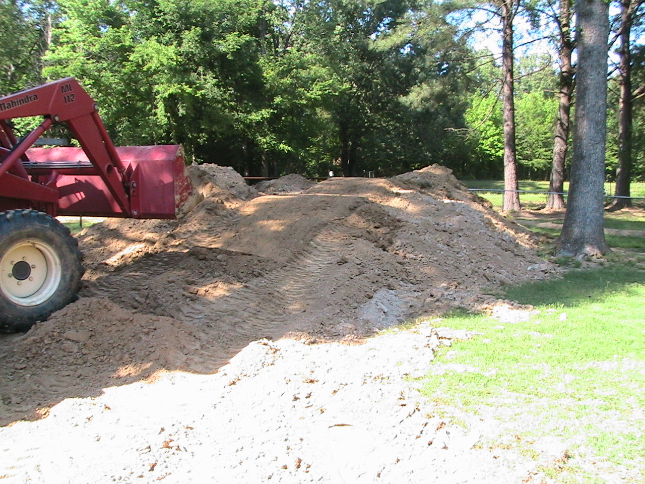

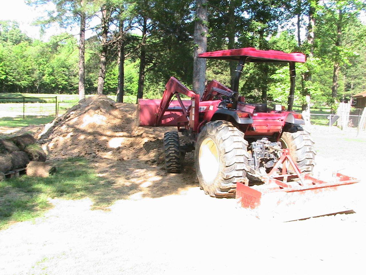

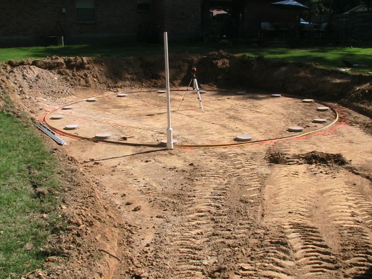

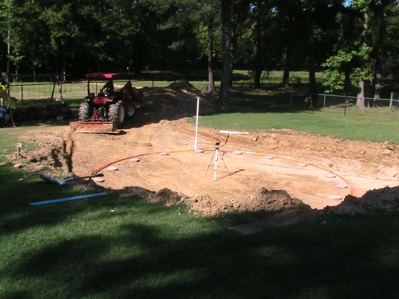

My wife dug this 4' deep by 26' hole with our Mahendra. She used the box blade and front end loader to level the area within 1/4".

Boy, the only way I could see that much dirt and no rocks on my place would be to truck it in.:)

Great looking job from a guy who used to install AG pools. Only one tip is to cut back the banks a little bit more and also to place some landscape fabric and gravel between the pool wall and the cut bank. Just helps drainage and prevents weeds right at the base of the pool wall where it's a pain in the rear to get to.

Great job. Nice looking place you have there. Did she cut and roll up the sod by herself?
   / Installing New Pool with Mahendra
#9
yes she did, rented cutter from home depot,rolled and stacked on pallets.
