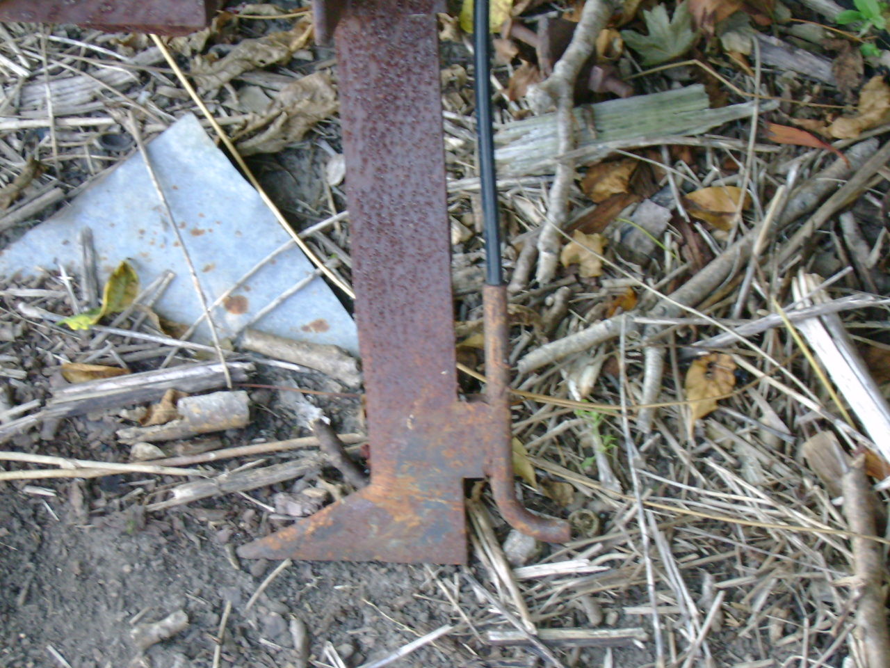

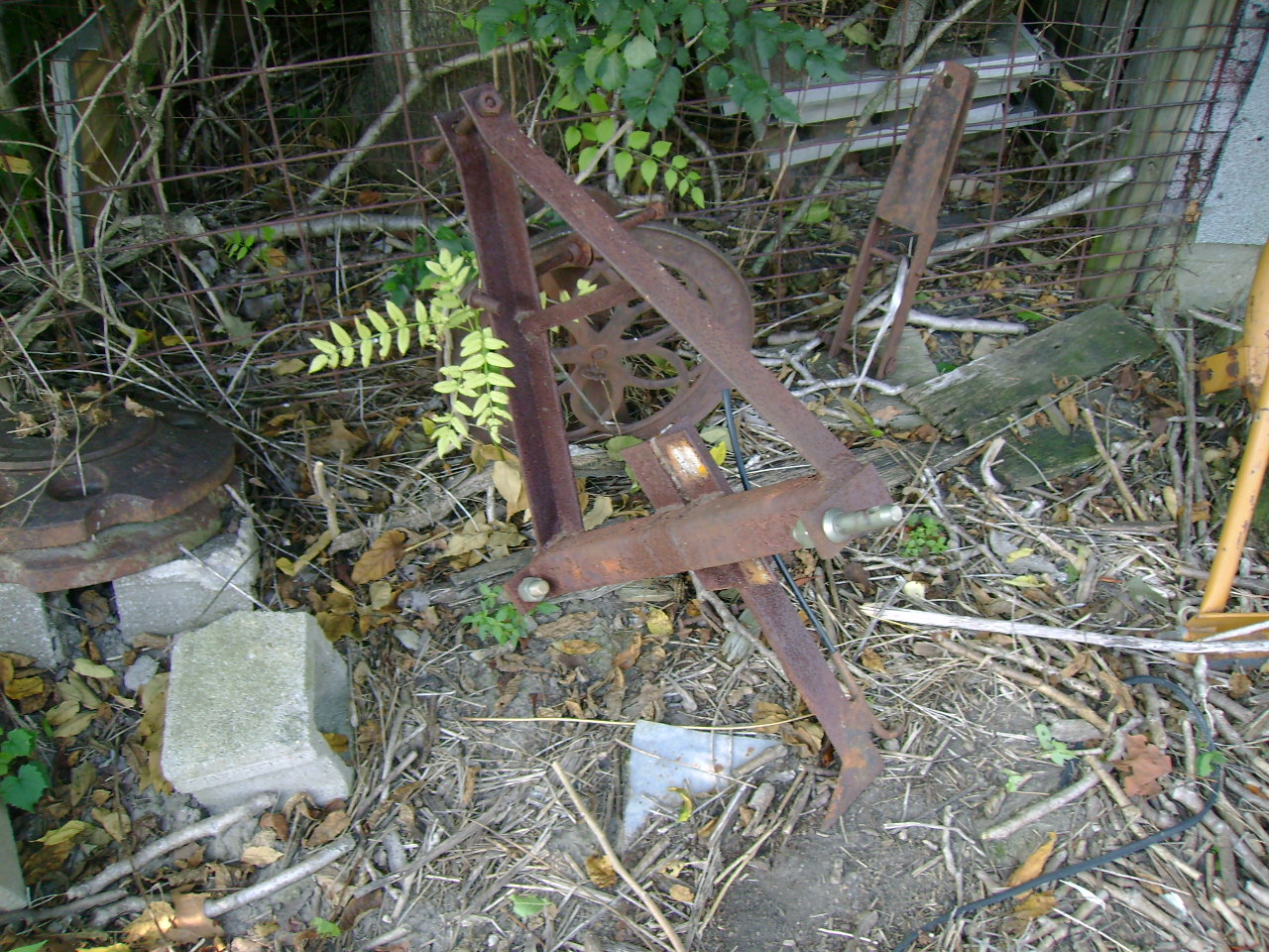

Here's a couple of pics of my cable knife.
As you can see, it hasn't been used for a while. If I ever have another big project for it, I'll add a coulter to it to cut the sod, as the roots have a tendency to ball up in front of and around the shank, and lift the knife out of the ground.
It took me probably 1 1/2 hours to build, all out of scrap metal I had laying around the shop. I had to buy the lift pins, so Iguess I've got about $5 in it ;)

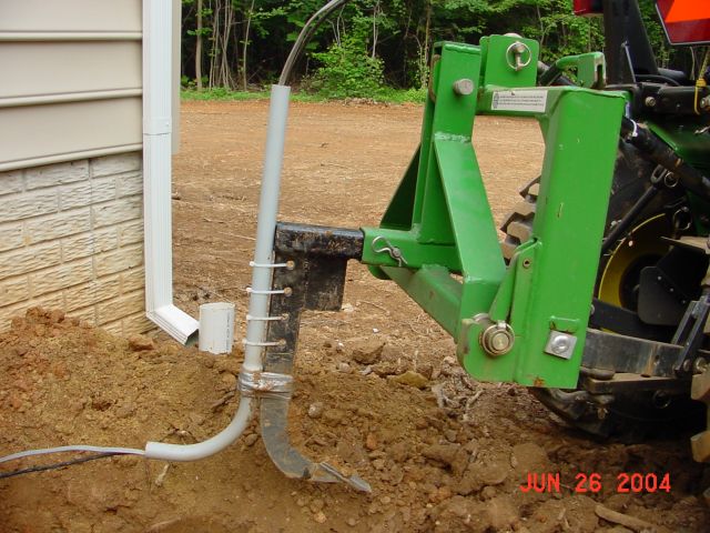

Very cool cable knife. Has the feeder too. Did you install a place to hold the reel. I wish I would have seen this ad before I installed my fence. I could have prevented a rental fee. Thanks for posting your ideas.

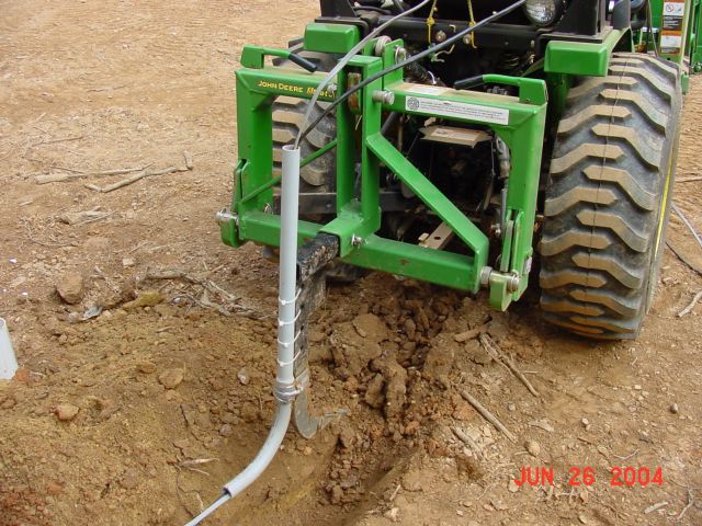

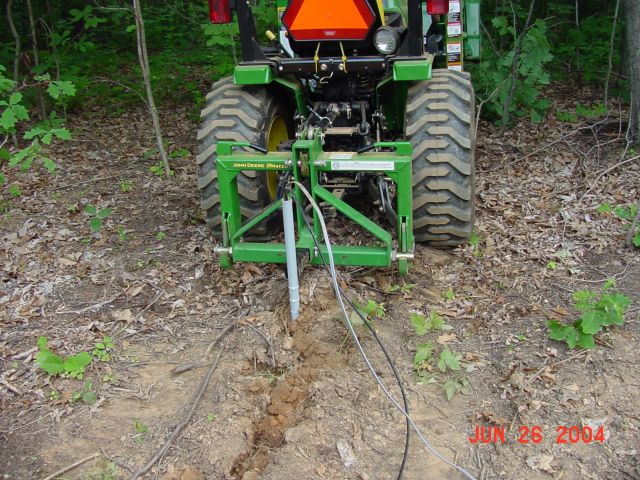

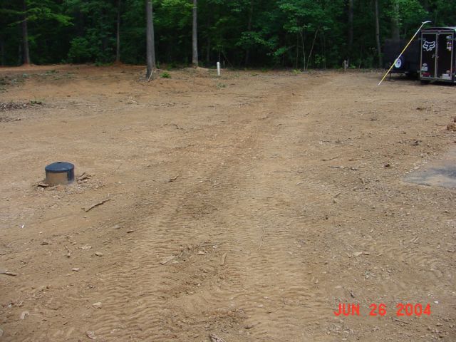

Here is a couple pics of the one that I made from a box-blade ripper. I only used it once...if I was going to use it more I would have made the conduit more permanent, but it worked flawlessly as is:D
