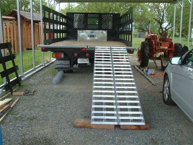

I did something similar for my 2004 Isuzu NPR stakebed (8x14 ft bed). I need to use the stake pockets for the side fences, so I got some of those 12,000 lb rated D-rings, some 1/2" steel angle, 1/2" grade 8 hex bolts. Used 6011 root pass and 7018 cap pass to weld the D-ring retainer to the angle.
