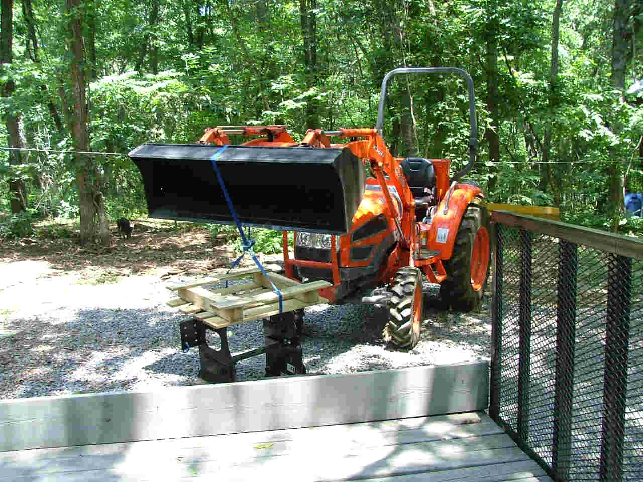

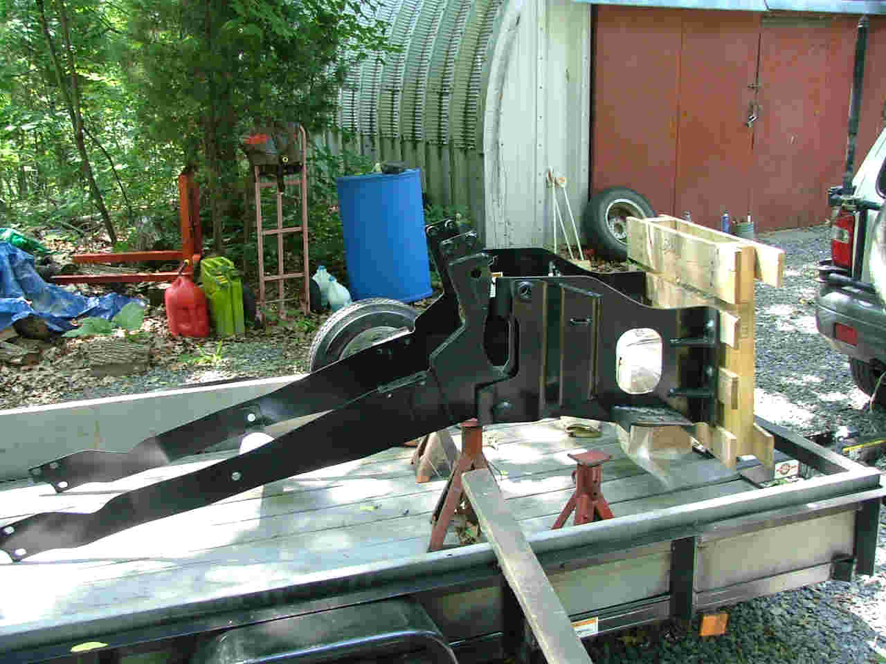

First, there is no need to remove the rear wheels as Woods instructions say (Kioti said to remove wheel for Remotes installation too, what is this "remove wheels" thing?).
If you are new to this, REMEMBER EVERYTHING IS VERY HEAVY! Many opportunities for smashed fingers etc. or more.

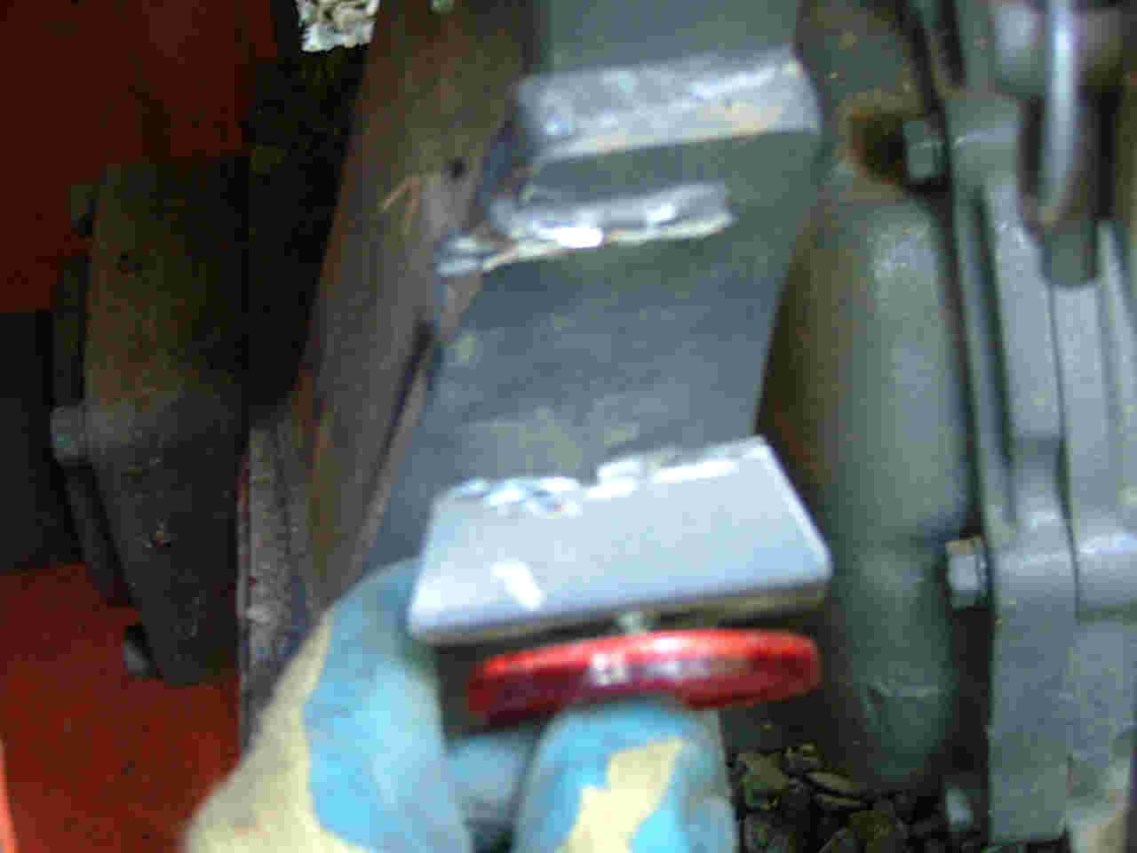

I had to cut off the two rear reflectors to fit the subframe; this is only on earlier models.
REMOVE all rubber plugs from mounting holes before you start so you don't get something half way in and have to take it off! I also cleaned out mounting holes and sprayed a little grease into them.
CHECK BOLT SIZES TWICE! I can't imagine what you would do if you somehow stripped one of the holes in the tractor.

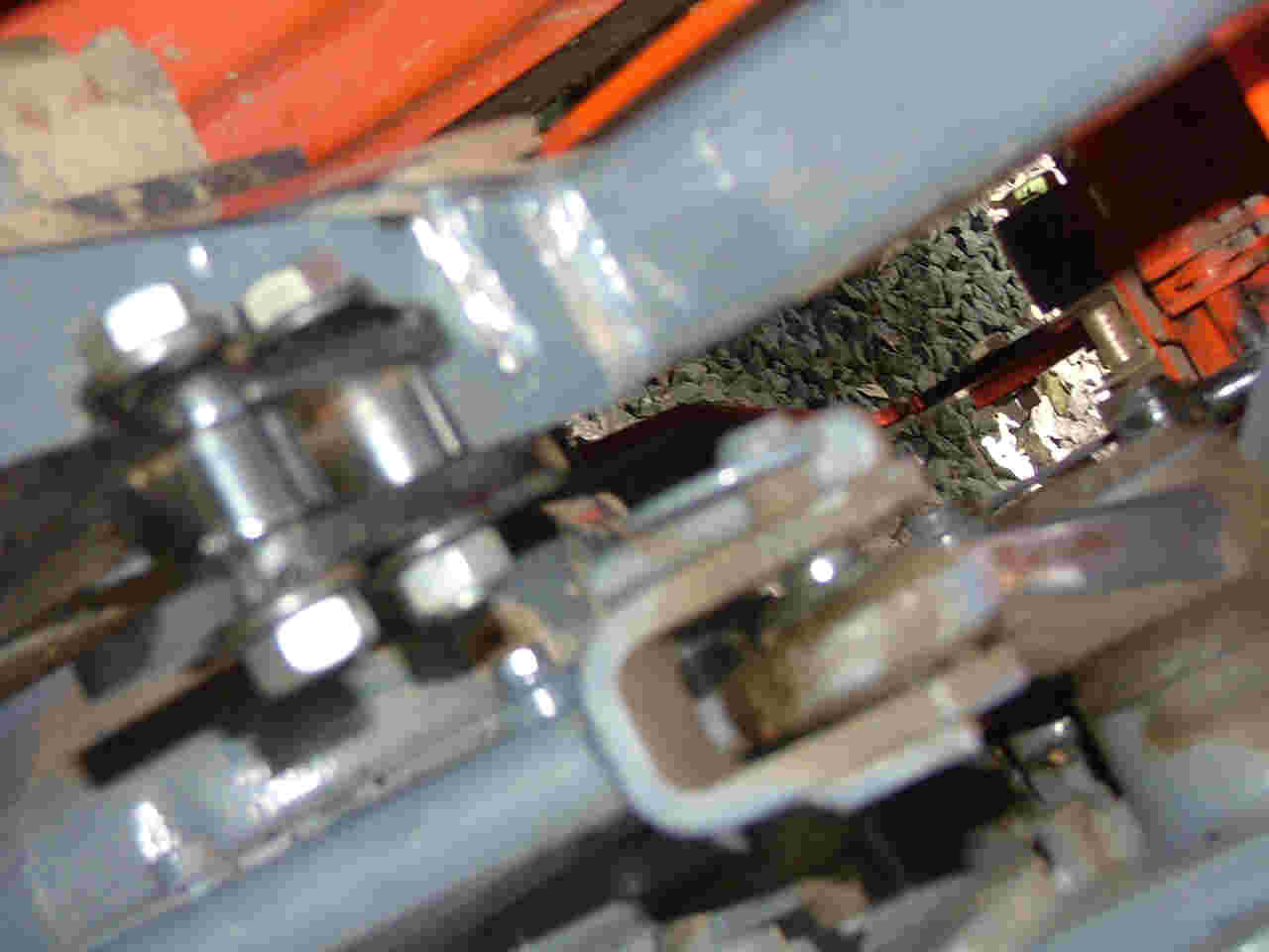

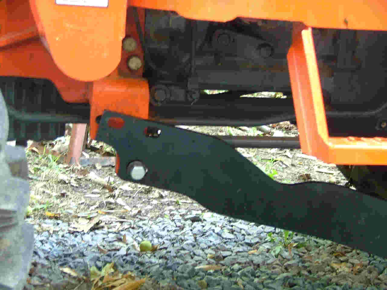

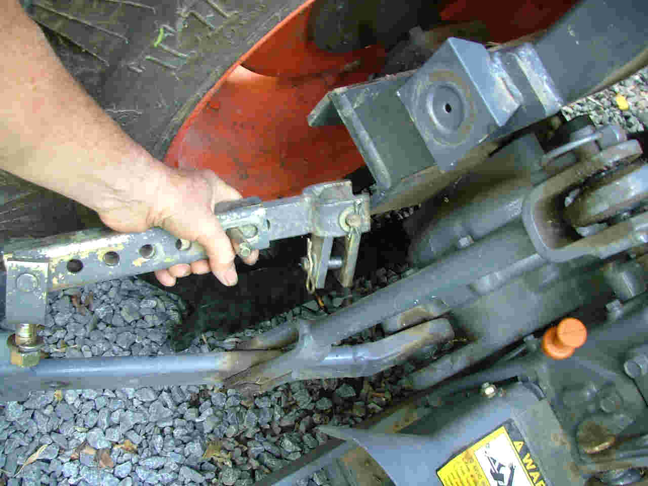

Basically I brought it home on a trailer, took it apart to get it off the trailer, cut off the reflectors, installed each side with ONE BOLT in front first acting as a pivot, lifted up the rear with a strap over the ROPS to get it near the holes, bolted it in with bolts loose, then bolted on extra rear reinforcement and put the remaining bolts in the front.
There is a center brace between the two sides as shipped; however this will not fit on the installed subframe because it is too close to the hydraulic filter under the tractor. However, I'm pretty sure I can install this across the front mounts where it will act better as the beginning of a shield for protecting the underneath of the tractor; I'll post a picture when I do it. The whole subframe is a wonderful start for a protective pan; if you put some bars or a panel across it it will cover all delicate parts back of the front subframe mounts.
