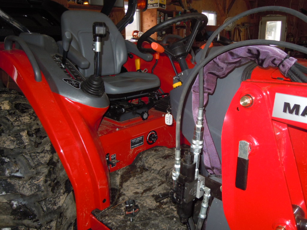

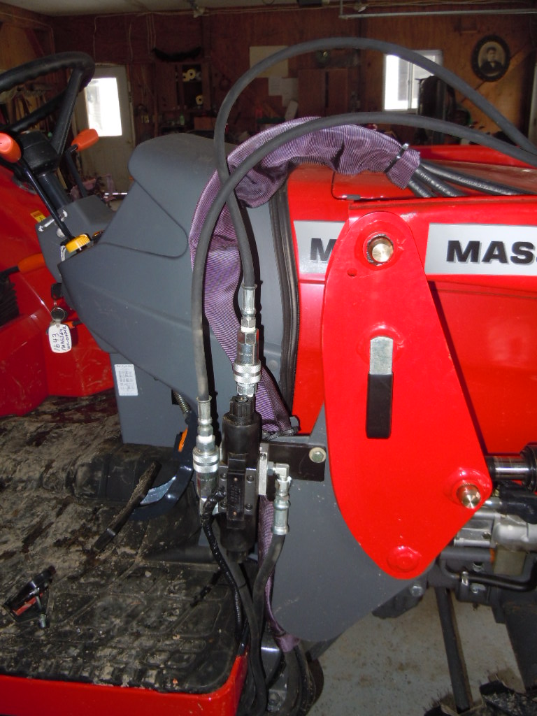

1. Locate the loader post that is bolted to the right side of the tractor. It is painted black. There is a bolt that holds the strap that is used to hold the 4 work hoses. Using this bolt mount the bucket valve bracket so that the tab rest on the back edge of the loader mounting bracket. See photo #1

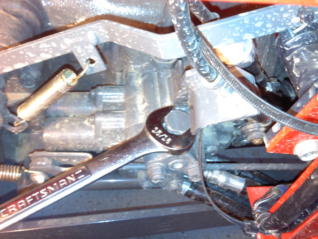

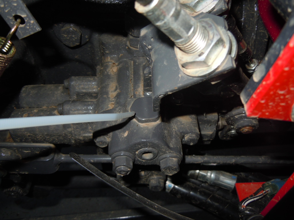

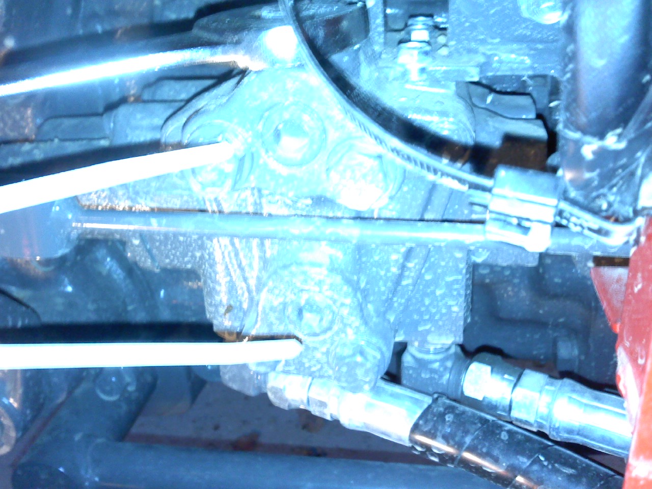

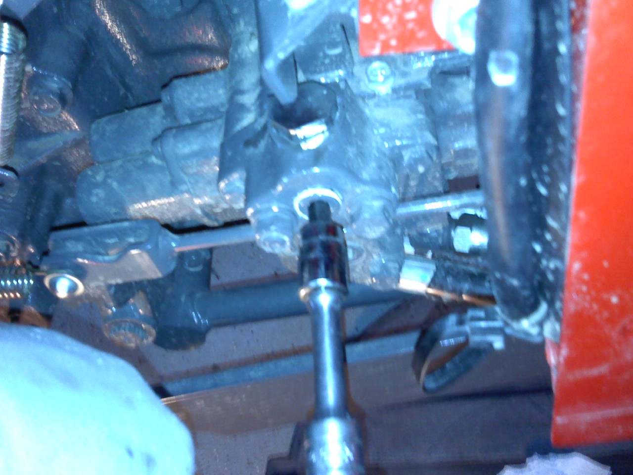

2. The loader valve is located just in front the right rear wheel axel. It is behind a sheet metal panel on the wheel well fender. Remove the four bolts that secure this cover to access the valve. See photo # 2 and 3

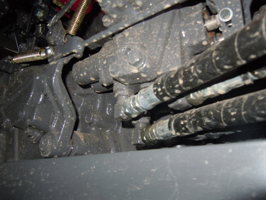

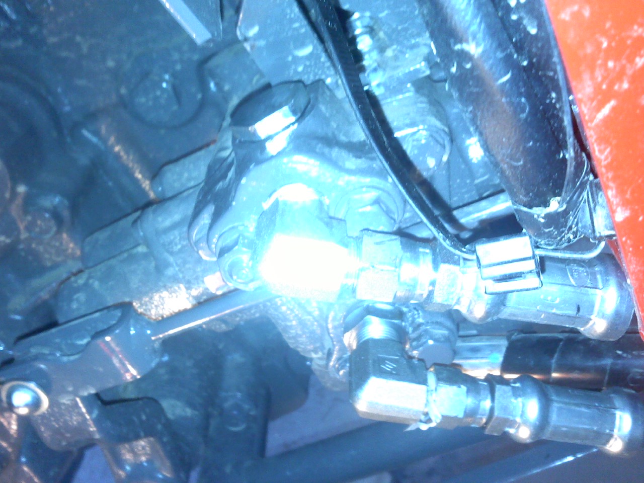

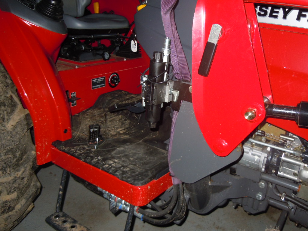

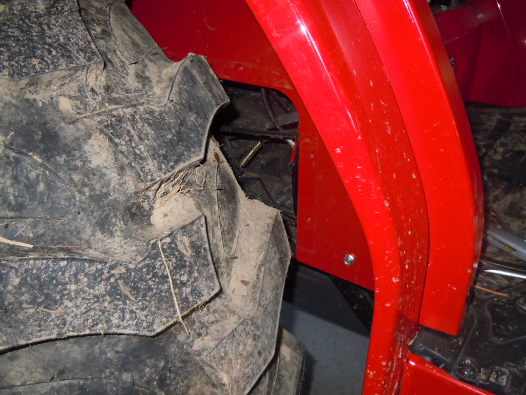

3. Remove the plug on top of the valve and install the (Dealer Provided) diverter plug and o-ring. See photo # 4, 5, and 6. (the longer plug on the left in picture 6 is the Agco dealer diverter plug, and the one on the right is the stock plug that has been removed)

6. Using one of the ス hoses, attach one end to the adaptor that was just installed to the top port on the loader valve and connect the other end to the 撤 port of the W. R. Long valve.
7. Using the other ス hose attach one end to the adaptor that was just installed to the bottom port of the loader valve and connect the other end to the 典 port on the W. R. Long valve.
8. Install remaining 2 hoses to the W. R. Long valve and the other ends to the back of the bucket.
