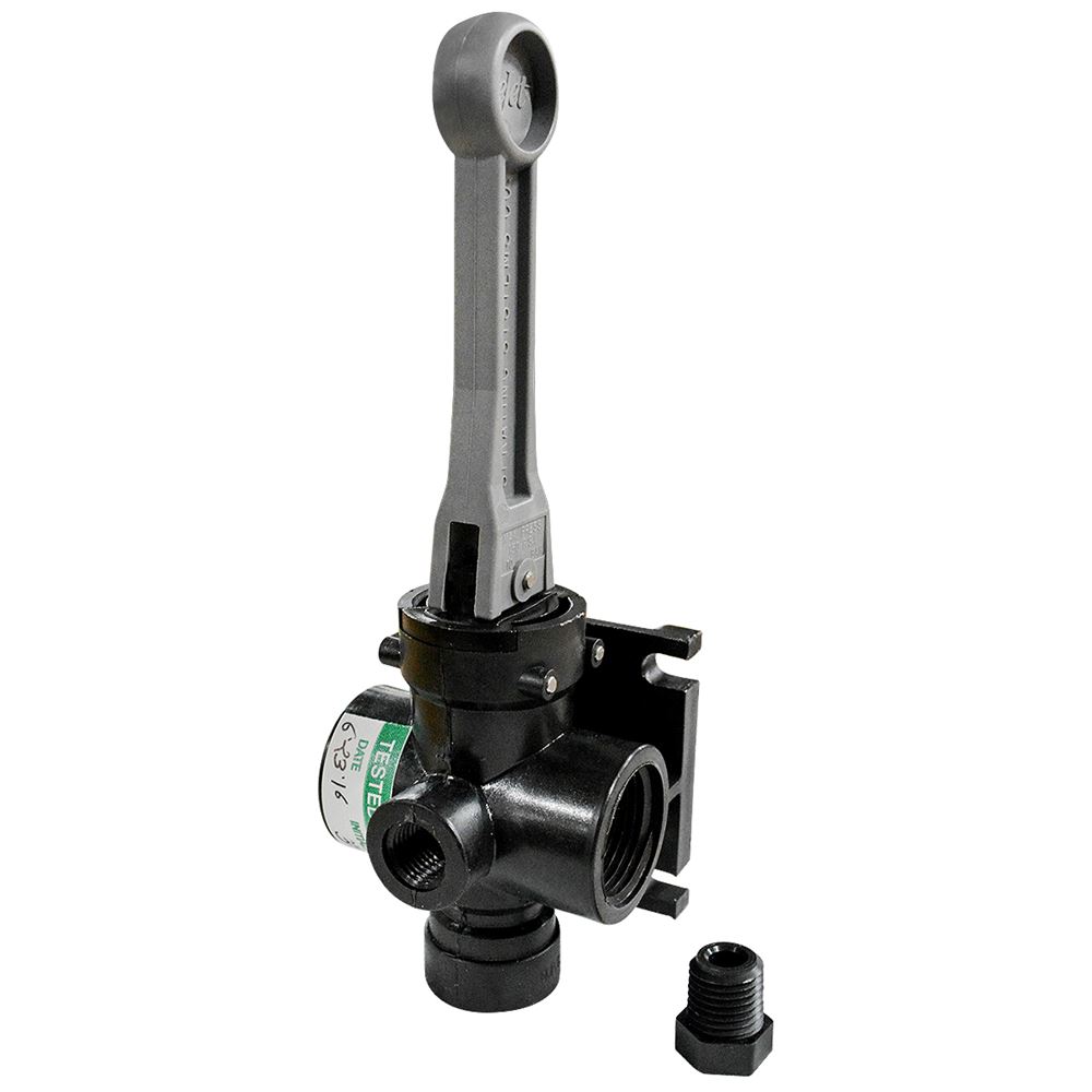

I have two of the manual valves on my 3 pt spray rig, and they would not shut off properly.
I was advised it was a simple operation to remove the "stem" and install a new kit (AA6B).
After removing the stem, I discovered it was different from the diagram ---- as the stem I removed appeared to have an O-ring (#4) and washer (#5) missing.
So I replaced items #6 and #9 from the kit, and did not install the washer in the kit, as my original stem did not contain one.
Has anyone encountered this issue? Is there more than one model of this Manual Direct-O-Valve?
