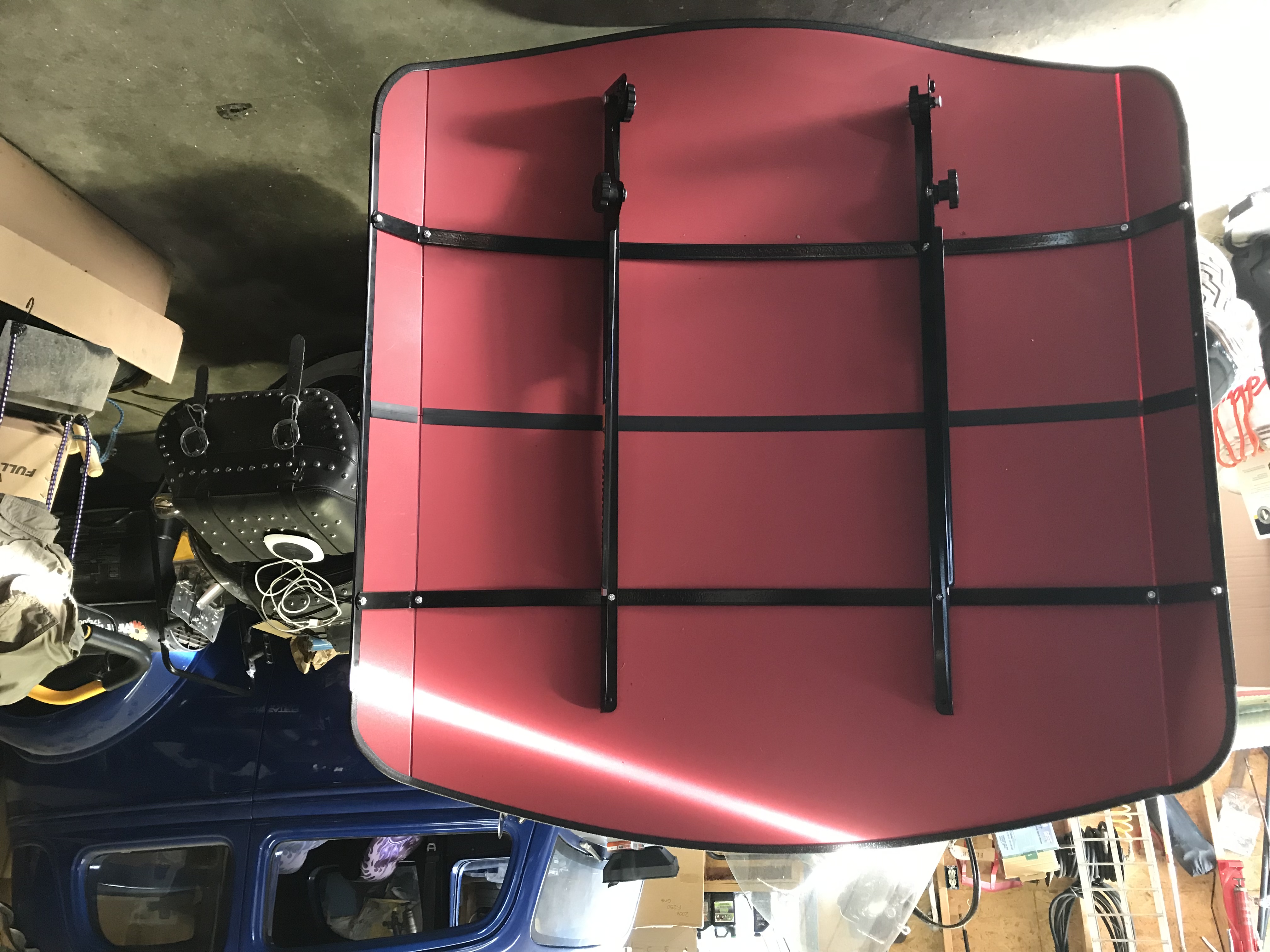

Once the steel was installed I had to get the fiberglass shell on top of it. So I held the fiberglass shell on one hand, like waiters carry big trays, as I climbed up a stool and onto the tractor deck facing rearwards. Physically, this isn't hard to do, as it probably only weighed about 20 lbs. But I'll tell you what turned very very ugly: the bottom side of this thing has wicked exposed fiberglass splinters, and as I shifted my grip or balance a little, I picked up some splinters of the nightmare inducing variety. It took some digging under a magnifying glass, and I'm not sure I got it all. Advice: tape some kind of pad onto the bottom before this operation.
To install this canopy, you rest the fiberglass on the frame and drill upwards through the mounting holes in the steel tubes, then put bolts and rubber cushions through it all. I realized it could make a mess when the drill finally breaks through and chips the top of the canopy, so I went slowly and thoughtfully, but still had a bit of chipping (hidden by their rubber lined flat washer once everything's together). On the second hole I was smarter, and got up higher on a ladder so I could see the top of the canopy, and back way off on the drilling force when I saw the bit starting to break through. By the fourth hole I probably kept the worst chip down to 1/16". Advice: watch the drilling operation from the top surface to minimize splintering.

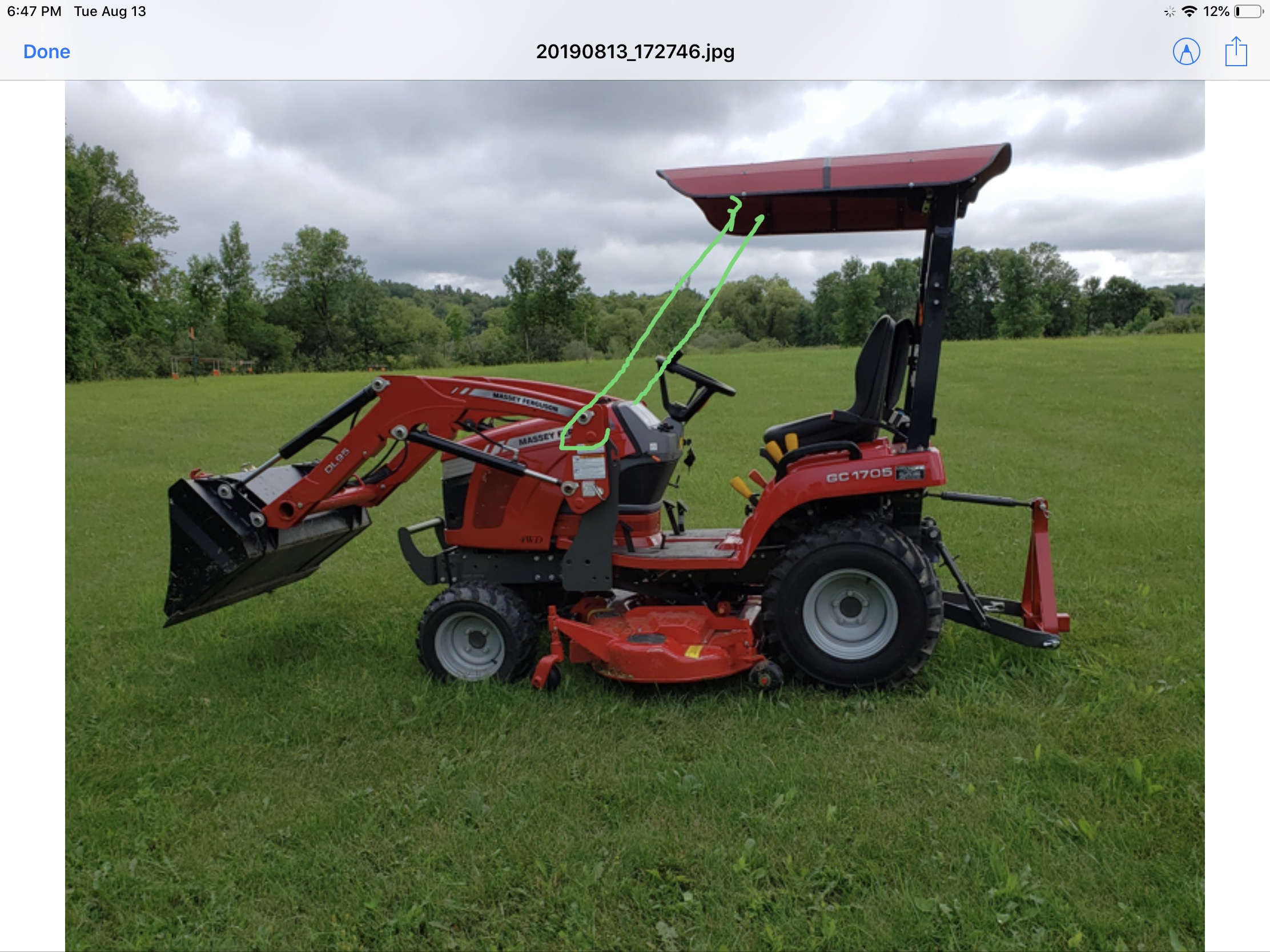

Tuff Top says to fold it down but I think it would become more of a wind blocker, I’m thinking of drilling a hole in each front metal bracket and then using two short tie downs to keep the front from grabbing air, think it would be better then folding it down, here is a pic with two green lines drawn on how I would support the top on a trailer if needed, the top is pretty rigid so it should work.

Yes, if you tied it down on your green lines, I don't see how the wind could grab it. The thing is parallel to the wind, so it's not going to be terrible for gas mileage, as long as you can keep the wind from catching it and pivoting it. That is, as long as its attachment points are sturdy enough. What holds the top fiberglass to its frame? Are there small bolt heads that could get pulled through the material? Do you need to add fender washers or something?

It’s a plastic/poly type top.

It’s a plastic/poly type top and I did use washers on the top and it’s bolted into a metal frame, guess all I can do is try it and if anything starts to go wrong I’ll just slowdown-stop and remove the whole top, it has a quick release type system on it, unscrew 4 knobs and it will come off, you can see them in the bottom of the pick.
