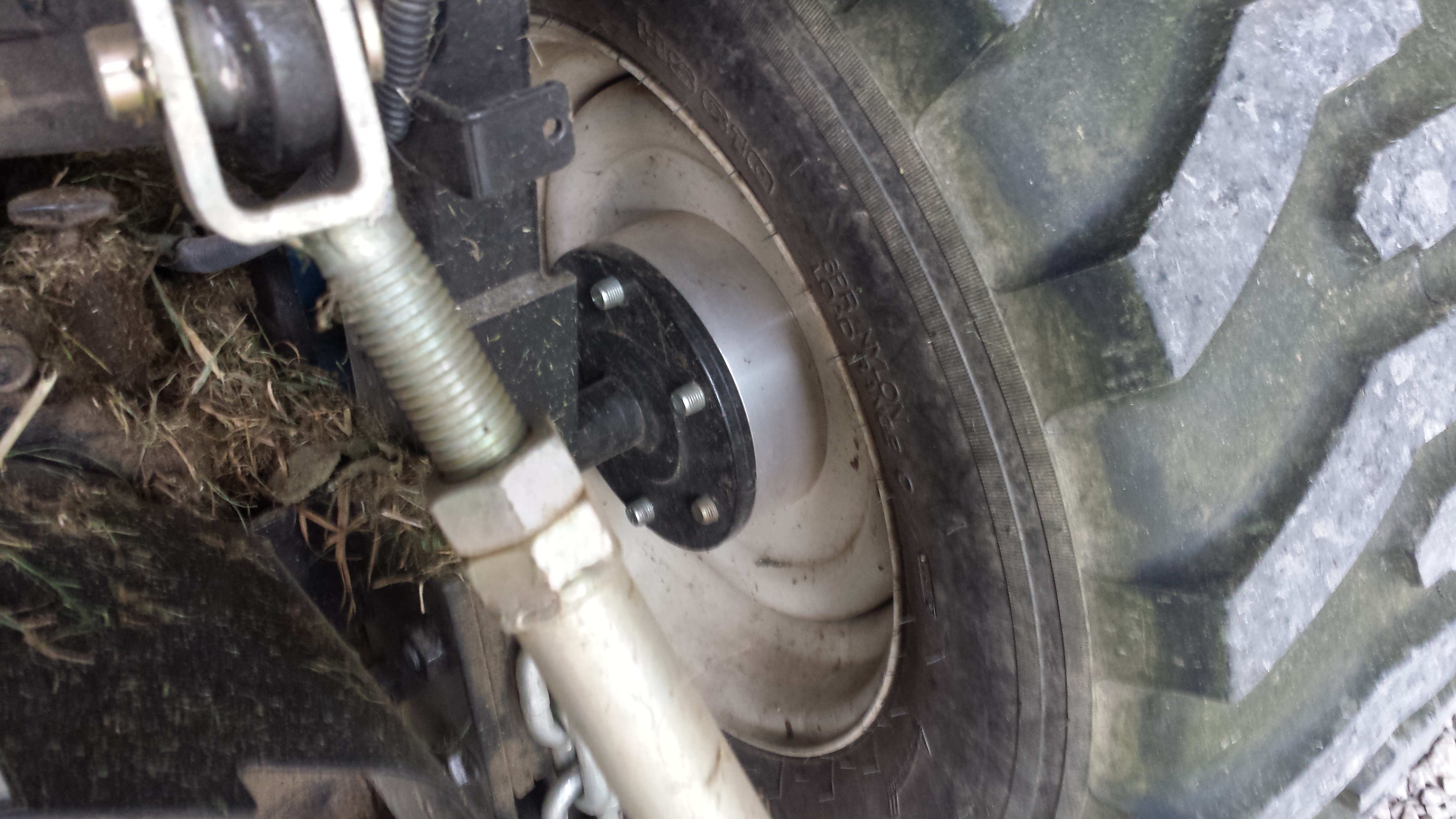

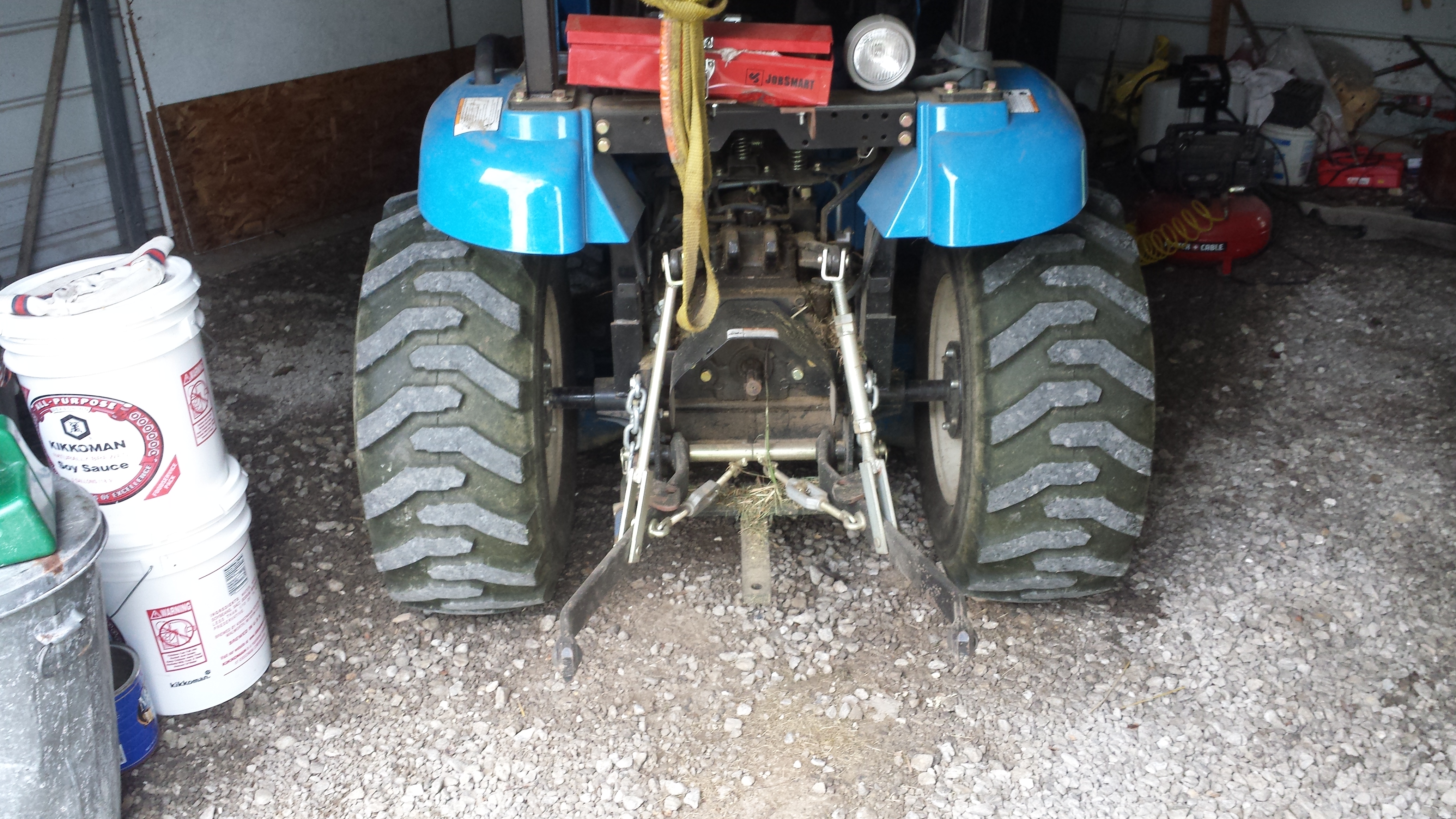

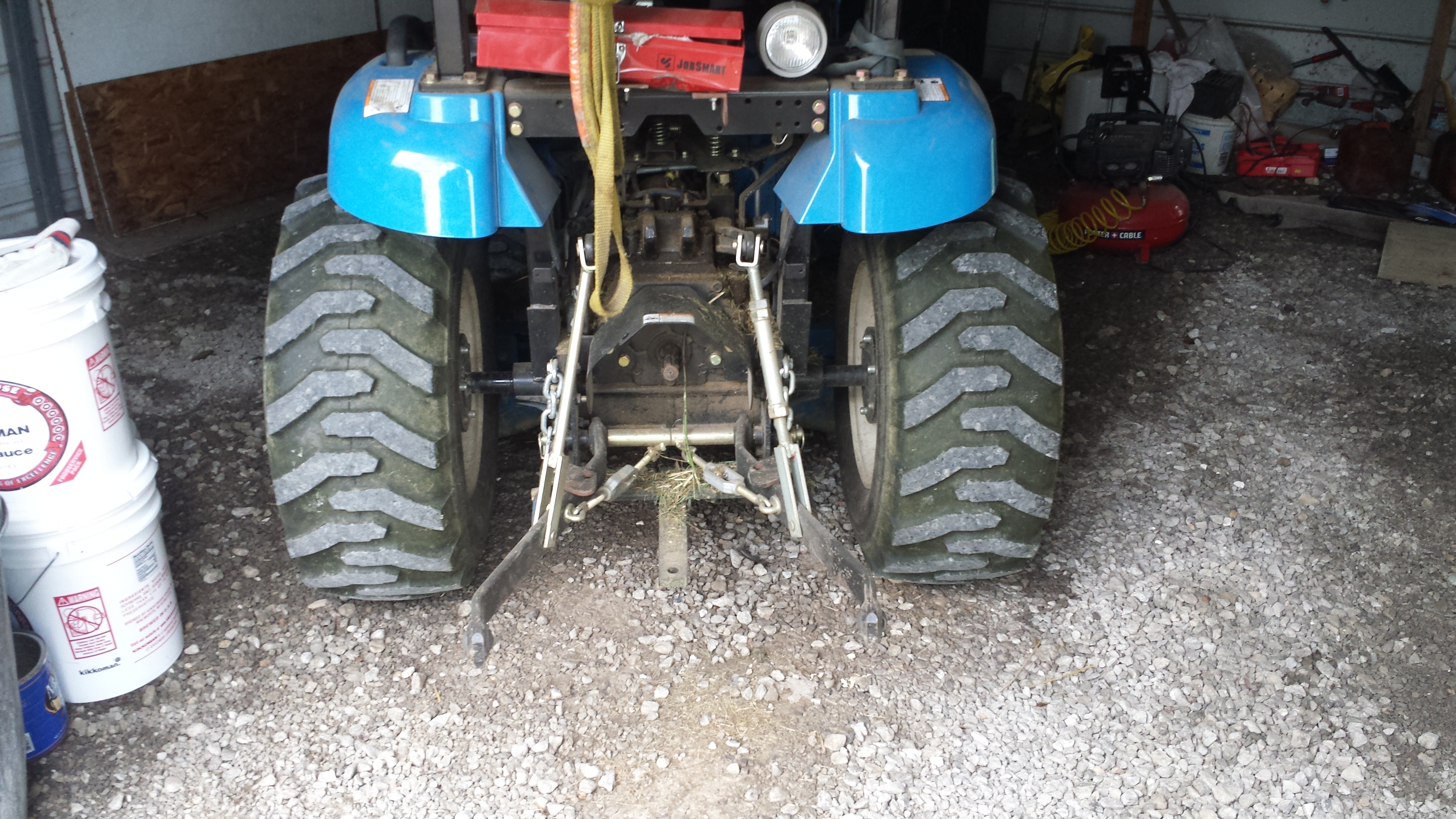

View attachment 465985View attachment 465986View attachment 465987
I installed the 2" spacers a year ago, and so far no problems. The tractor is much more stable now. Our property is very hilly and with the FEL on, the tractor was very unstable. These spacers were bought from Lenny, he is very helpful. The bolt pattern is metric, I had the same problem with the first set Lenny sent me.
Rexdar, you said your spacers had a metric bolt pattern! Reading your info may have answered a question I had. This could be where the problem arose with the bolt pattern and the first set of spacers. When I measured the bolt pattern and spoke to Lenny the first time, I told him the bolts were 6" on center. Lenny said he believed they were metric and couldn't be 6" on center as they have produced many sets of spacers for the LS factory. I took that to mean I didn't measure correctly? Assuming the measurements were straightened out and the order was ready to begin production. Imagine my confusion when the spacers finally arrived, and didn't fit. Not only was the bolt pattern too small, the hub wasn't even close. When I spoke to Lenny the second time, I reaffirmed the bolt pattern to be 6" on center, and the set he just sent me was incorrect!
After going over my original findings several more times just to be sure what I said was true, then confirming my measurements with LS. Lenny produced a second set of spacers in record time. These new spacers fit like a glove. Now, I have to wonder if specific manufacturer date or serial numbers has got something to do with the bolt and hub pattern measurements? Either way, I now understand why there was some initial confusion on the spacer and hub measurements. No one's fault, just a difference in axle design.
