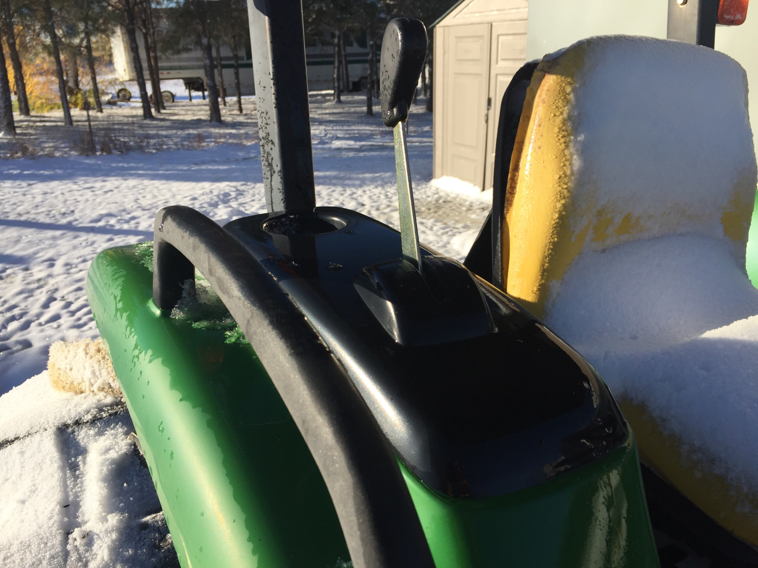

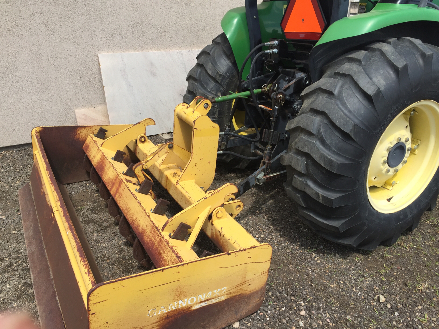

My Gannon box scraper needed a set of rear connections which were not present when I bought the tractor and attachments. One solution proposed were long hoses connected to the quick disconnects for the front end loader.
While it would seem to be a workable solution it's not without cons. One of course is the fact that your tilt on your bucket loader is inoperable while you are borrowing that circuit to the box spreader. For about twice what the long hoses would have cost, I purchased a kit called Selective Control Valve, JD part # LVBM18820. In Colorado it was $280.50 plus tax. By the time I added the quick disconnects and hoses to match the box scraper to the kit the total cost was just under $400.

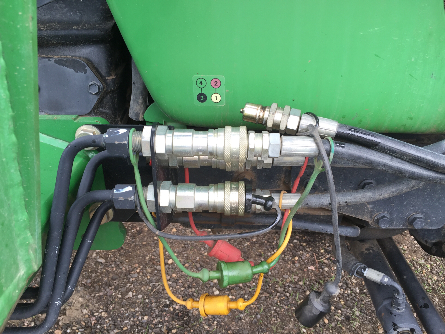

Installation of the kit was straight forward and the instructions were clear. After removing the required floor panels the kit bolts into the third circuit on the hydraulic mixing valves below the front loader control lever. A lever attached to a new right fender arm rest controls the pressure between the two supplied female quick disconnects.
Pay very close attention to the lever adjustment on the control cable. What seemed like my valve was stuck turned out to be a needed adjustment on the control lever cable.
The project was a success and the scarfs on the box scraper work as intended.

The kit used the third valve already supplied with the stock tractor. I simply removed the two plugs on the bottom of the control sssembly and connected the two metal lines supplied with the kit. The control cable connected to the existing plunger at the front of the valve assembly via a bracket supplied in the kit. I retained full use of the FEL.

My only challenge has been to ensure depressurization of the attachment prior to uncoupling the quick disconnects. After decoupling my box scraper without thinking of depressurization it would not couple on next use. I had to partially loosen the line at the box scraper cylinder to release the pressure enough for the male coupling to release the pressure lock ball to allow the female end to snap to the locked position.

Would be nice to have a tool modified to slip over a male coupling end and press that tip to release the pressure (of course there will be a squirt of oil so a good rag wrap is in order).
I wrap a rag around the coupling and tap that tip with a hammer.. most of the time avoid some oil spray but not always.
Removing in cold temps and trying to hook up when warm will create pressure build-up, even if depressurization when uncoupling is done.. I find.
   / Installation of Rear Hydraulic Connections on a JD 4500 #9
I tap the ball end of the hose against a metal object.
Shut the tractor off, then move the valve lever to each position to relieve pressure, then uncouple. Float will do the same thing if equipped.
Great minds think alike and I tried pressing the tip of the male connector to the lower arms of the three point hitch. With all my 175lbs behind it I couldnt get a drop. The last time the box scraper was removed I moved the lever in both directions with the tractor off. That did the trick.
