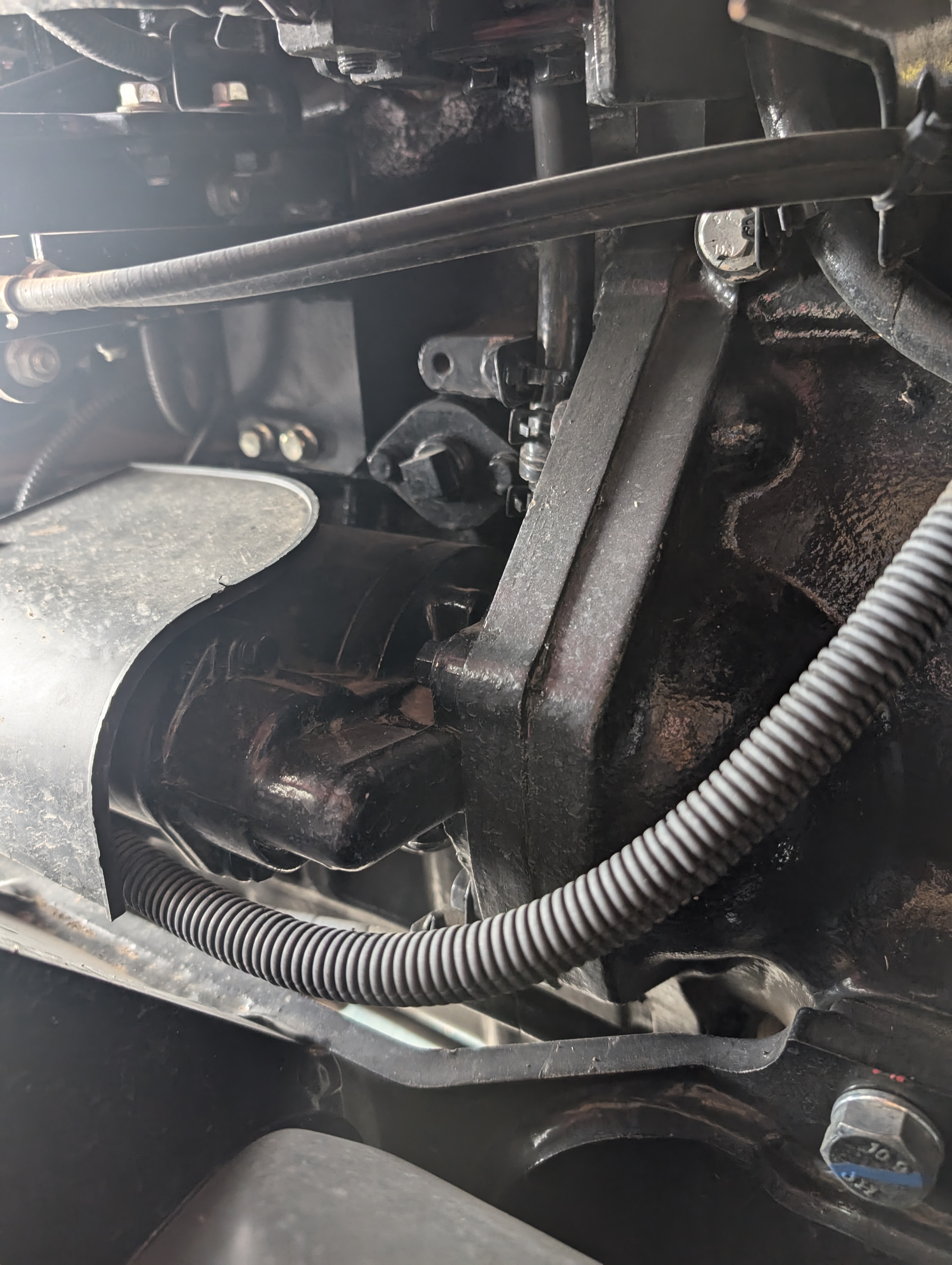

   / installation Mahindra Block Heater #8
This is my 6075 location. Possibly look for something like that? Square pipe plug. Remove them quickly install the heater. Route your wire to a location free of movement and your off and running
