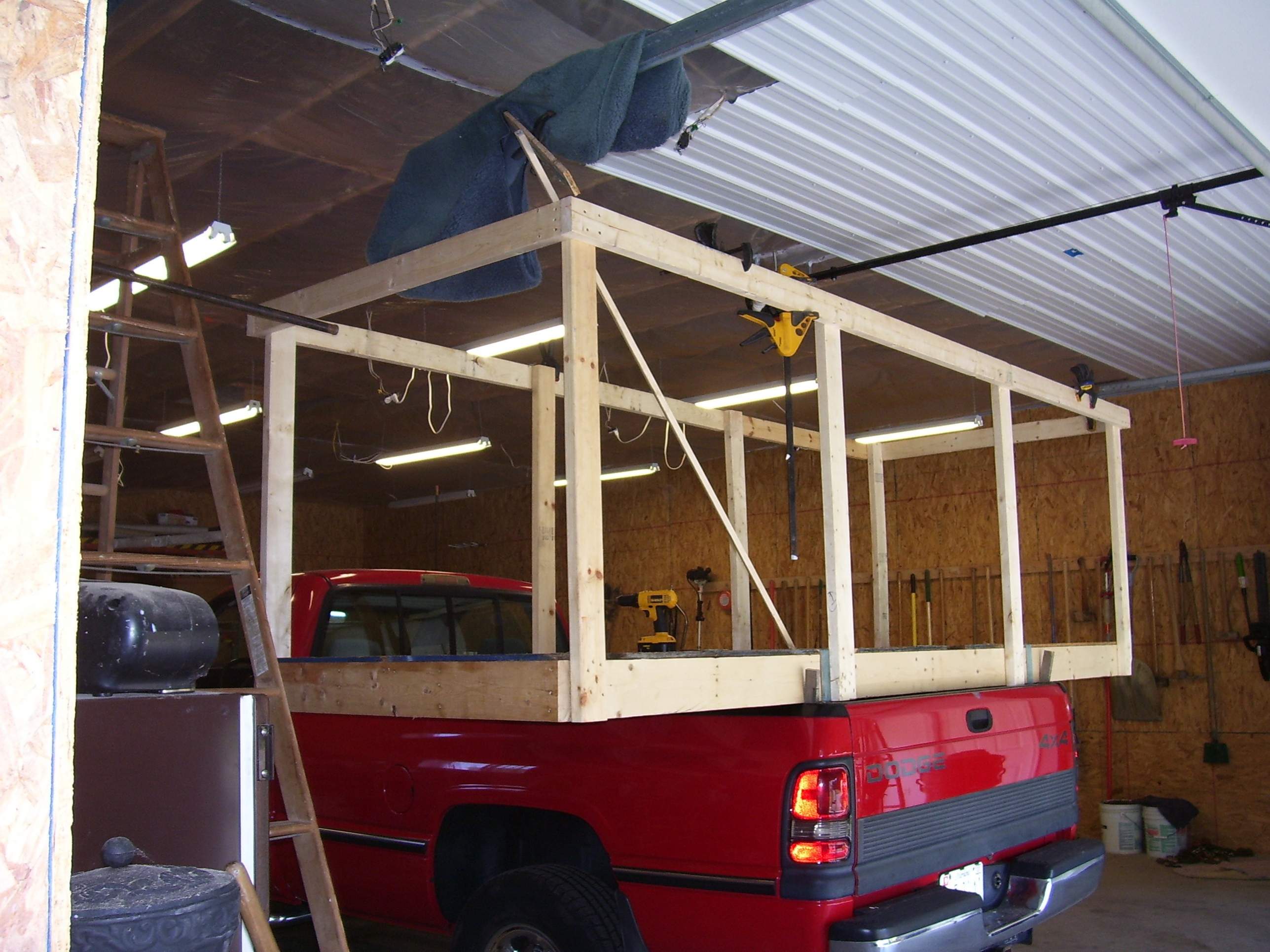

Debo, I used OSB on my walls. The photos show I was in the process of installing a metal ceiling. Here are a couple of photos. As far as insulation I purchased the insulation from Morton Buildings as it is made to fit exactly between the posts. I then installed 6 mil plastic to act as a vapor barrier, then finally the OSB.

I did the ceiling and walls like srs did using white cover sheet metal. A little less per ft. than regular siding. I figured by the time I painted the walls white, to brighten it up in there, it would be easier with the white metal all over. I used 1 1/2" insulation board in between the perlins, and overhead. Made the shop pretty tight, and easy to heat. Did this in '94, and still looks like new, sans a little dust.
