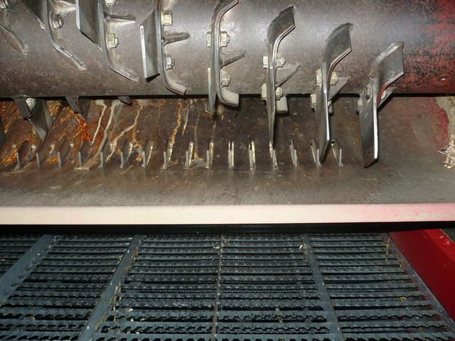

What doesn't pass through the concave is pushed into the chopper where it just beats the heck out of whatever is left over, then drops it to the sieves. The actual blades stikcing through that pan underneath are removeable 9se the next picture):
Me putting the chopper blades in. He does not run the chopper blades when doing corn and we were getting ready to harvest beans so we had to change a few things:

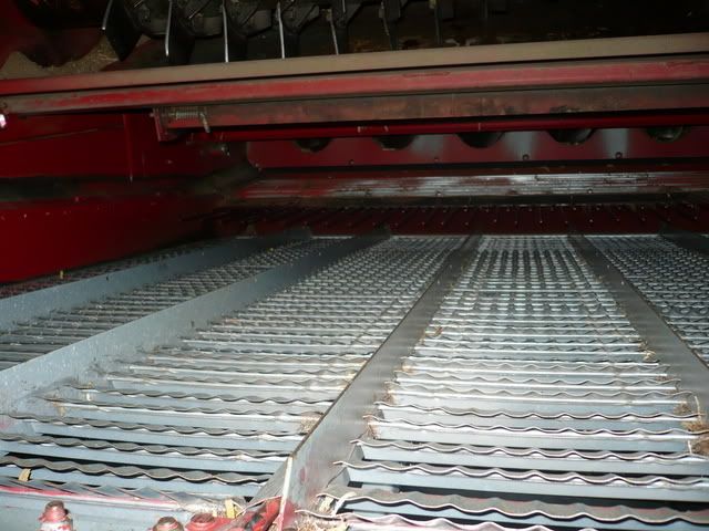

Here are the sieves, there are two big fans in the front of the combine that blow a large quantity of air through these to blow stuff out and let the grain drop through so it can be retained, the sieves are adjustable for different grains and they are not comfortable to lay on:

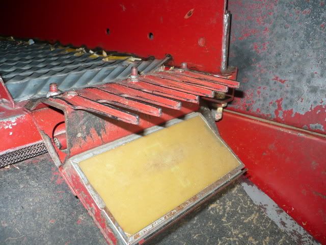

This simple looking doo-dad is a sensor that tells you in the cab how much grain is being lost out the back of the machine, it is mounted at the very rear of the combine where everything drops out and it lets grain drop on it and the impact sends a signal up front to a gauge. There isn't much making it out the back but you'll always loose some.

Fantastic Birdhunter, thanks! I've always wondered how these things work and your explaination is easy to follow. I had no idea there was so much sophistication. Particularly the lost grain sensor at the back. What do you change if you are loosing too much?

BTW hope you had the controls locked and tagged out changin out those knives ! :eek:

I would bet that if there is too much lost out the rear, you would probably slow down to allow the sieves to sift threw everything, correct?

Ground speed won't affect what goes out the back so much as you can adjust the speed of the rotor (the main part that does almost all the threshing), ground speed really only effects ground speed. Running too fast will cause you to plug the combine and you have to dig everything out by hand if you do it good enough. Yesterday the boss man did it on the new 2588 and they (I wasn't there) spent about three hours digging everything out.
If there is too much grain showing as being lost there is a few things you can do but first I'd check to make sure nothing else is hitting the sensor pad, early this year the needle was pegged on the gauge and we went back there and that teeth looking guard on top was loose and hitting the pad. If it were an actual problem you can open the sieves up more, see if they are clogged with something, or are not shaking as they do shake back and forth.
No I did not have the controls tagged out, I trust the guys I was working with. I don't think it would be remotely possible for everything to turn on by itself as there are so many things required to get it running. If there had been a bunch of people there (more than the three of us) yes one of us would have had the key out but since we were all back there or in there we were not worried. Plus even though that one picture looks like my hands are on or near the blades I never had to touch them or really get in the path of their rotation.
