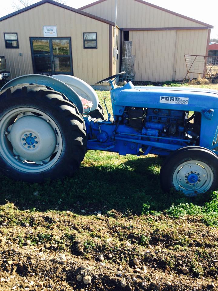

I thought about this Ford 2000 quite a bit this morning, looks like a good clean tractor nearby for a good price at $2400. But it sounds like it has a tranny PTO, and I just can't see messing with that for the next decade or two. The wife says it is different than their 8N, but it sounds like the way my 8N works. The hubby noted that the PTO doesn't have to run for the hydraulics to run. Which is a nice, but not quite enough of an upgrade for me. 12391121_1005657399502004_3276197125752027898_n.jpg
