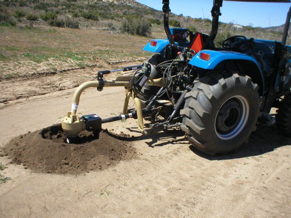

Good day from the West Coast, I'm getting ready to purchase a new post hole digger and augers. I'm looking at Land pride, Bush hog, and Woods, with 9 and 12" auger for sure, but I'm not sure if I should go with a 18 or 24" landscape auger. I have the Kioti DK45 thats rated 38 hp at the PTO. I'm leaning towards the 24" thinking better hole and soil prep for new fruit trees, blue berries and such. The Top Soil around here is about 18 to 24" of a loam/clay mix and then a hard sand pan (no soil expert) any input from experience would be appreciated.

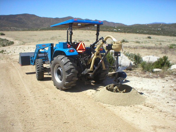

I like the Land Pride PHDs, but then I have PD35 which is their biggest PTO post hole digger. The 24" tree auger works great for plants and trees.:thumbsup:
One of the things that I do is once the hole is dug I will leave the auger in the hole and put fertilizer and dirt back in and mix it up as if it was in a big mixing bowl.
As far as hard ground, get a down pressure kit for your PHD and dig till your heart's content. I had some problems drilling into some ground in the past, I don't have the time to fool with messing with those sort of problems. Bought a down pressure kit, have not had a drilling problem sense. :thumbsup: :D
