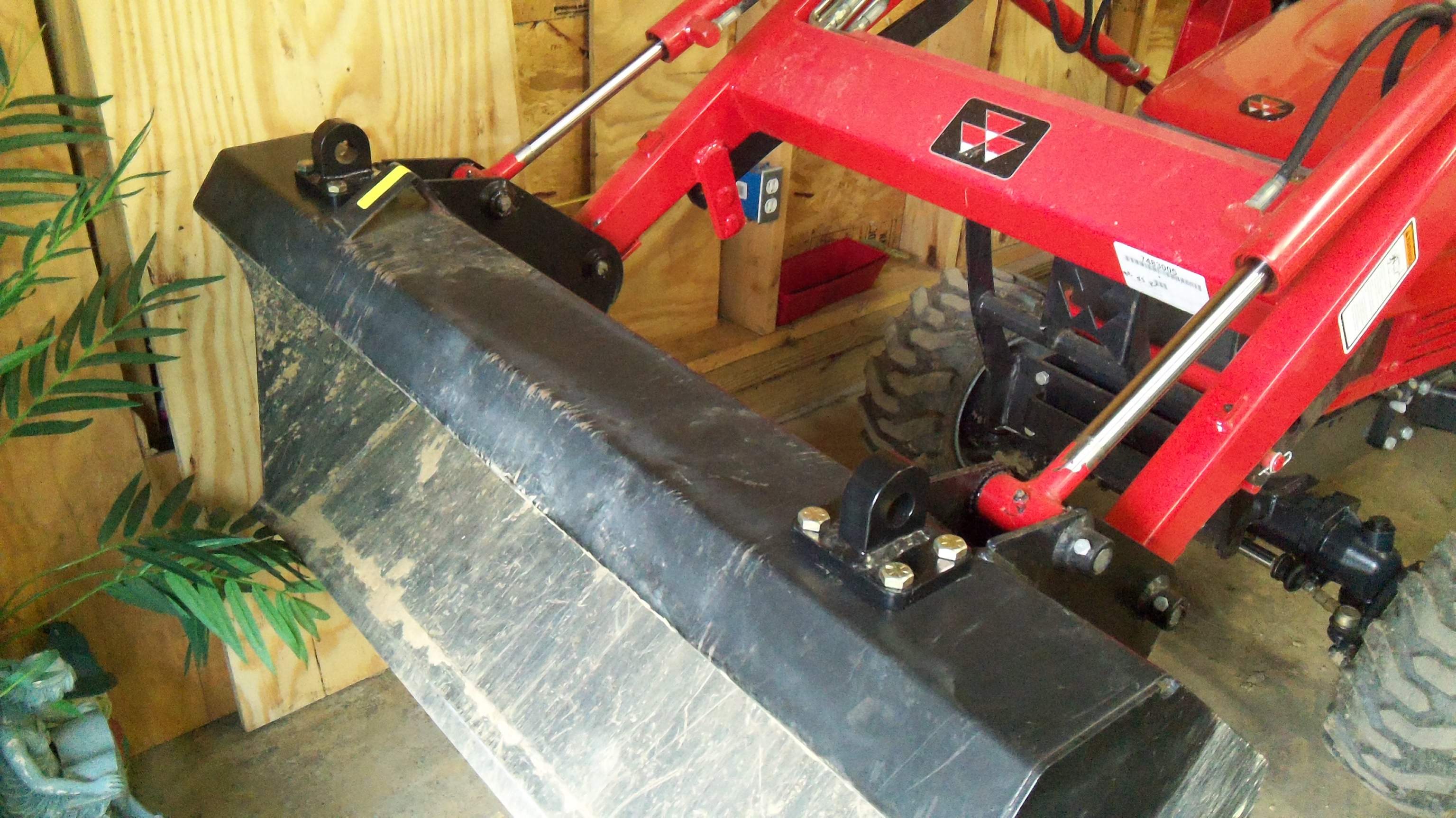

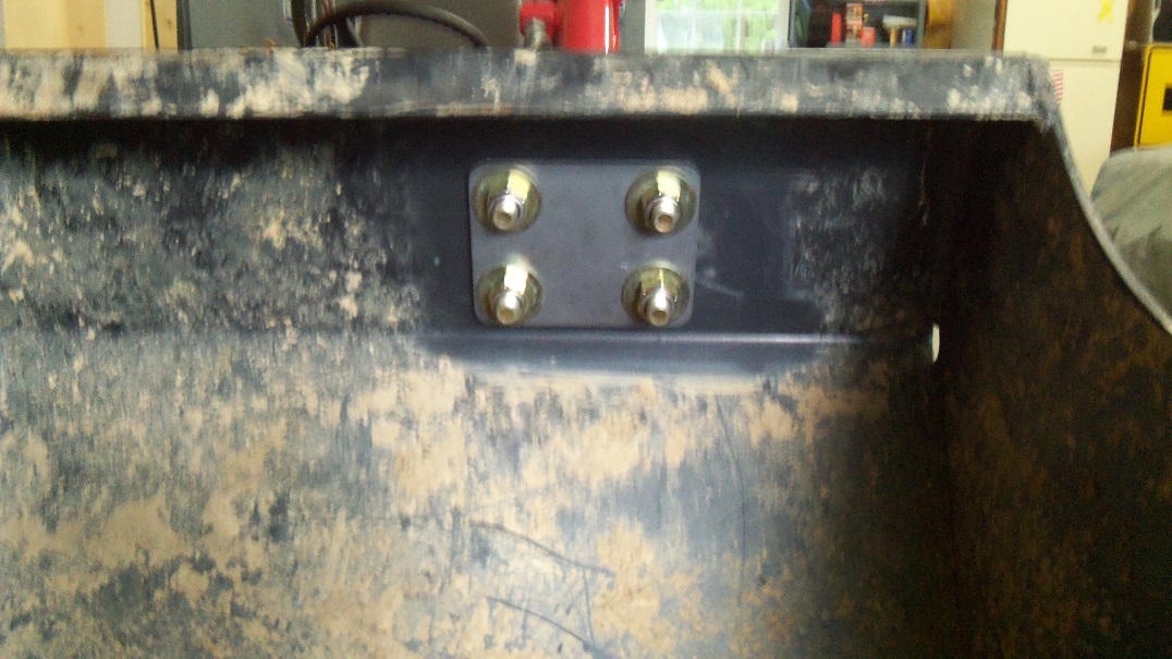

I just installed these on my 2310 today.I have not tried them out yet though. (raining again).
I also bought the backing plates.
   / Input needed on Bolt on shackle mounts for the FEL bucket #7
A few Pics installed.
