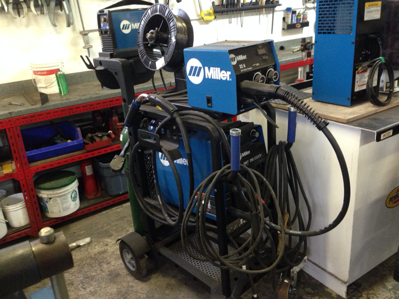

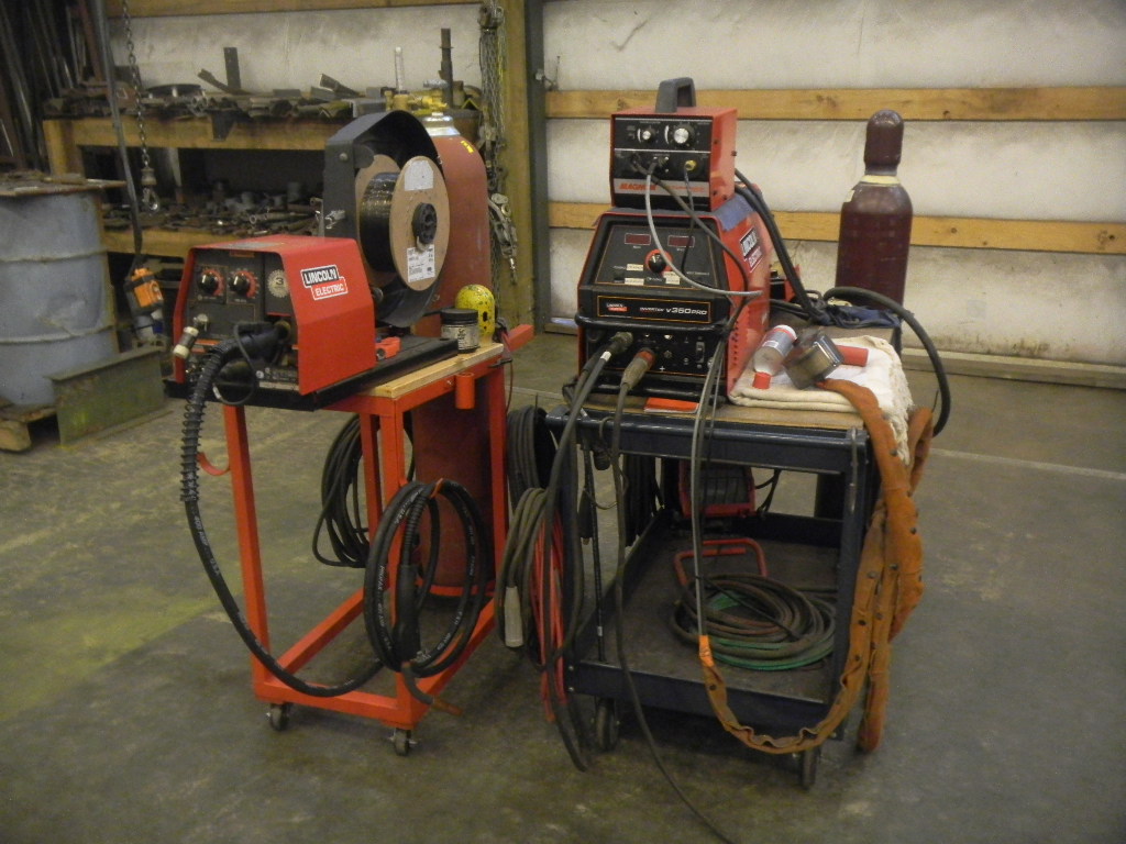

I have a Lincoln V350-Pro, I couldn't be more satisfied with it.
I understand Miller's XMT 304, and XMT 350 are great welder too.

Very happy with my XMT 304. Didn't come cheap, though.
