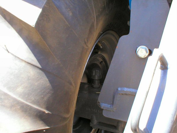

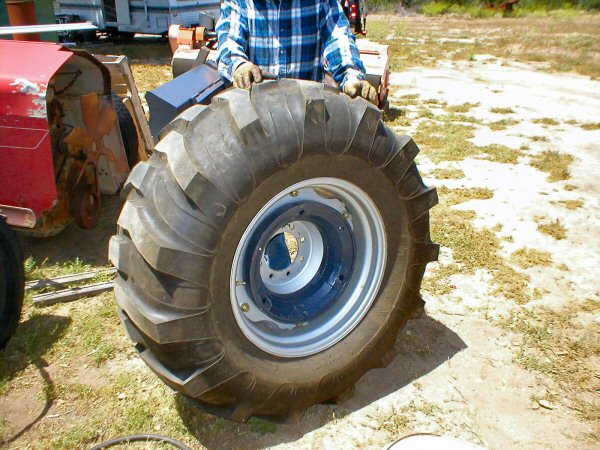

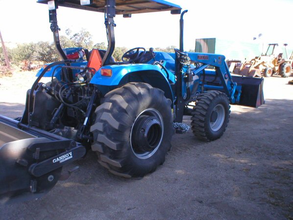

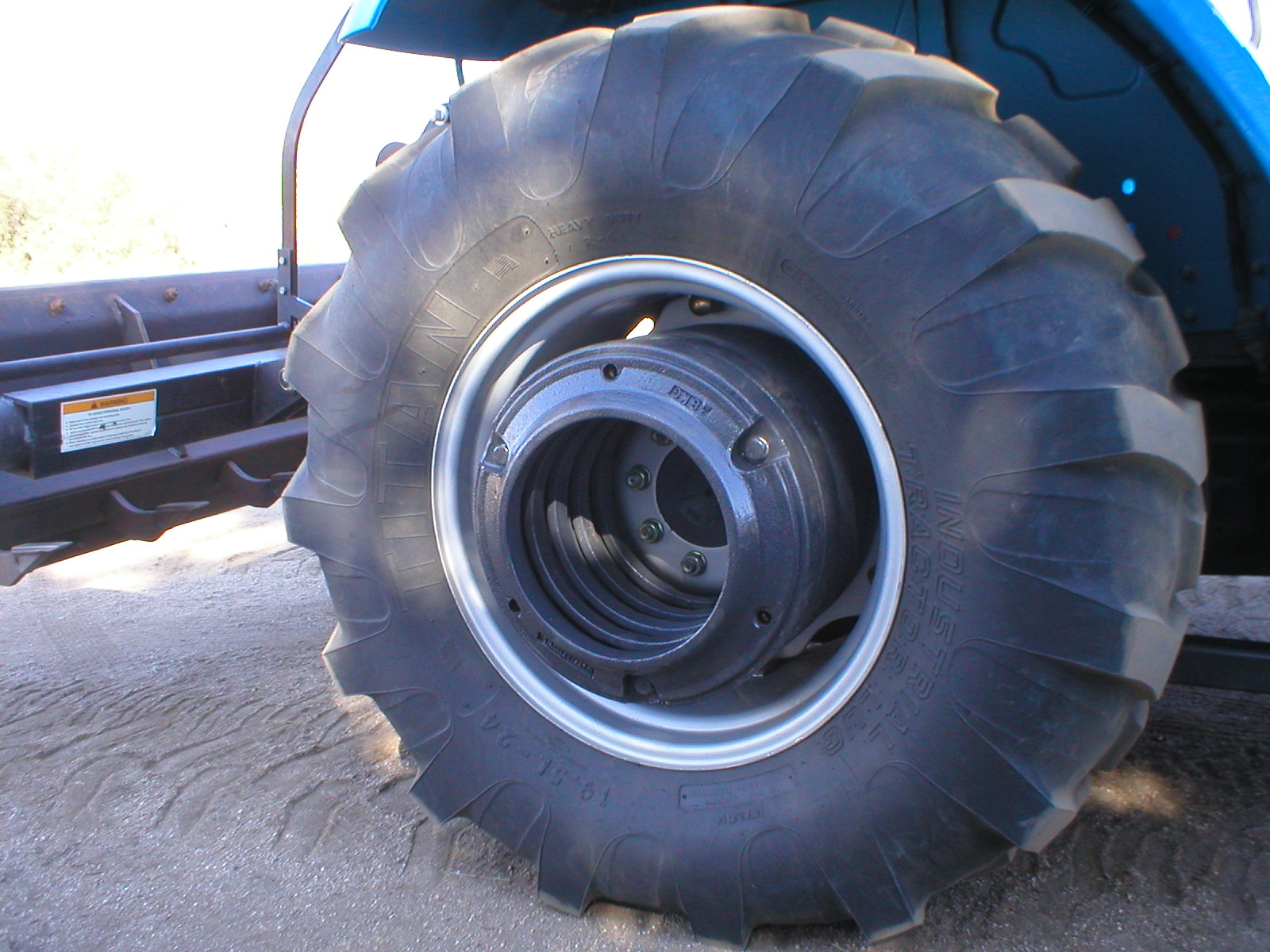

On my 2005 Mahindra 7520, I installed wheel weights on both the inside and outside. Just wanted to get as much weight on as I could without having the weights stick out too far. The first picture is not very good, but you can kind of see that there is not much room left after that weight is in there. ;)

I have wheel weights on my tractor, too. But, it never crossed my mind to mount them on the inside. That's not a bad idea. That way you could double up on the weight. How do the mounting bolts line up with both inside and outside weights on at once?
   / "Inner" wheel weights #6
They just bolt together just like adding more on the outside, just that the rim happens to be in between.
