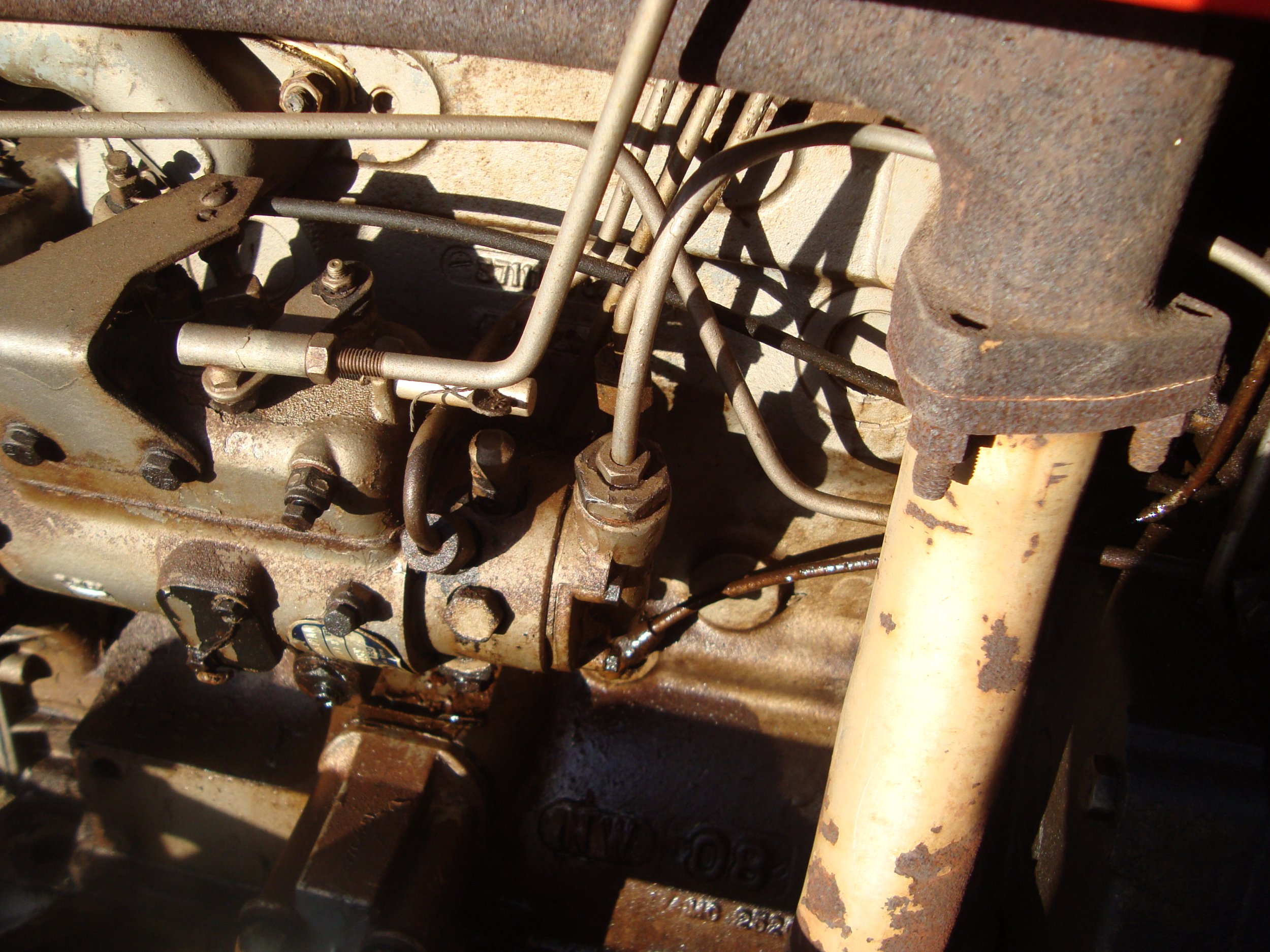

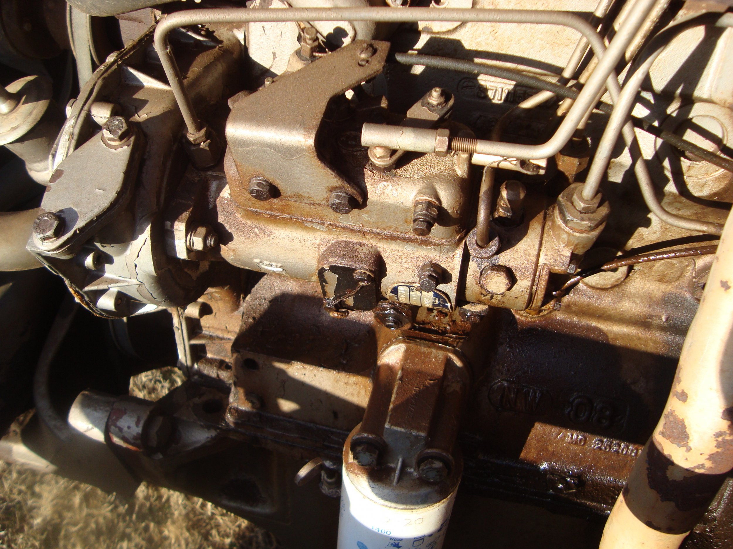

Sorry for the absence. I have had some health issues but I am back to good health now. The issue with the pump seems to be with the part where the linkages connect. Leaks badly but the trractor runs good. My local dealer (50 miles away) says a repair to that area can be made in the field. "we do it all the time". The pod where the linkages attach has 3 bolts that are safety wired. I was warned that these bolts are fragile. tighten them gently?? Is this a simple fix or??
   / Injector Pump Trouble #4
If the pump is a CAV/Delphi..
And your handy with a wrench, follow the instructions above..
There should only be 2 nuts holding the rectangle cover on..& the throttle and shut off are on the top cover..
If it’s a RoosaMaster/Stanadyne pump, there’s 3 screws holding the cover on..& the throttle and shut off are on each SIDE of the pump housing.
When in doubt, post a picture..
   / Injector Pump Trouble #5
I would try to fix the leak without taking the pump off. If it was leaking on the shaft seal and filling the crankcase with diesel, yeah I'd pull it. But, if it runs good and just has an outside leak, I'd try to repair where it is. Then, if you absitively posolutely can't get it, might pull the pump then. Won't it be great if you fix it and don't have to take the pump off ? Work toward that first. I'm proud of you being 84 and even wanting to try, puts wind in my sails.

Here are some photos, not very good but shows the pump pretty good. What do you think??

It’s a diy project for some folks..
Look on eBay/Amazon for:
“CAV Top Cover Seals”
It’s a mini kit that contains 4 orings, the tc gasket and the 2 fiber washers that go under the top nuts..
If u look hard, u can find them for 9.00 w free shipping..The avg price is 9-12.00.
Get the gaskets BEFORE tearing it apart.!!
Good luck
