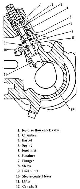

The only part that is lubricated by the fuel is the barrel & plunger, the actual parts that do the metering and pumping because lube oil is too viscous, and besides, would cross-contaminate with the diesel fuel (hence the tight-lapped tolerances). Think of them as a cylinder with a piston that rotates as well as going up and down. The remaining components are lube-oil lubricated.

Just think that there are two distinct sections of a pump; one lubricated by fuel, the other lubricated by lube oil.
