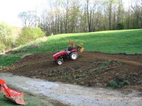

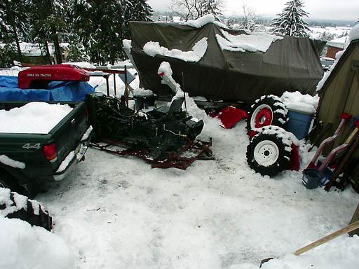

I am happy with my 304 so far. I got mine as a crate tractor and it showed up in January. Put it together outside. Couldn't wait for spring. I have been moving rocks too big to move by hand. Plans are to make a small road up a 20 degree slope past the house to where there are more rocks and then use them down below for a massive rock wall.
I live on a bedrock hillside, so I don't have too many options for landscaping. The tractor has made things a hundred times easier. I have had a few leaks, but nothing major. The only one that I haven't been able to fix is the breather for the hydraulic reservoir. With it filled to the mark, when I start up the grade it leaks out the breather.
The only headache I have is the backhoe that came with it. A YW-6. I got a little action when I first hooked everything up, but since then, nothing. Have had the suction screen, the relief valve, and the pump out, and can't seem to find anything to cause the lack of action. I will probably have to take all of the valves off as I am sure there is debris somewhere.
And the only other complaint I have is that there aren't many of us with the 304. Most have the 200 series or the 354. I got the 304 because in my experience a derated engine lasts longer. Besides, this thing has way more than enough power for what I am doing.
