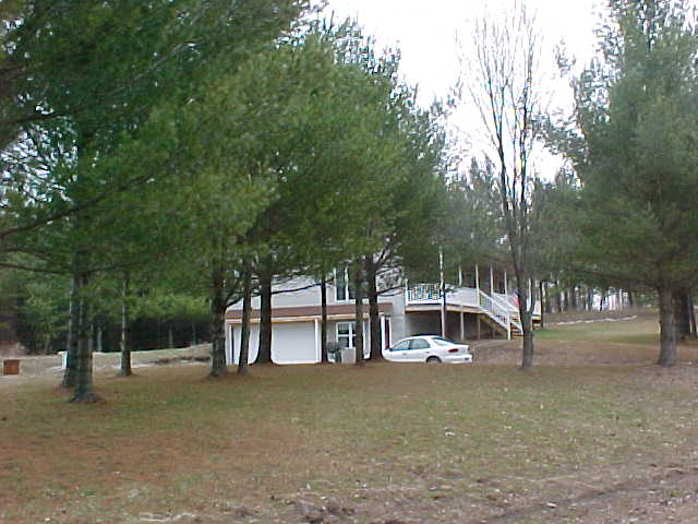

I've had my 2 446's for 6 years. Mow around many trees and find the turning exceptional, gets close enough so I don't often have to go back with the string trimmer. Like I mentioned in your other post "they're tanks". I'm including a pic of the area I mow through (not right now of course) it's still set up to plow. The reason I picked up a second one was to keep one for the gardening chores and one for the mowing chores.

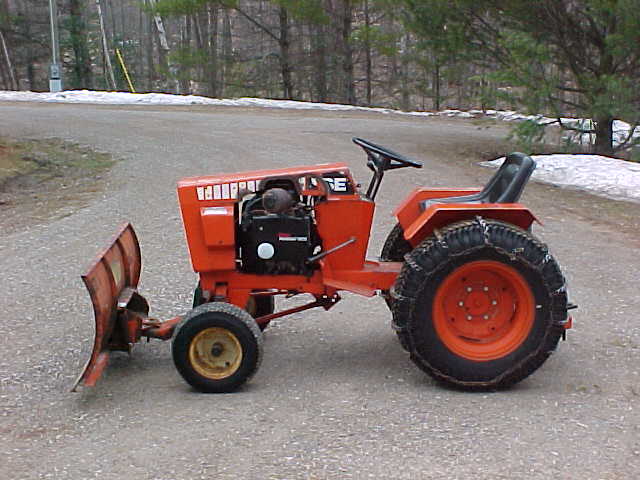

Here's one of the machine!
