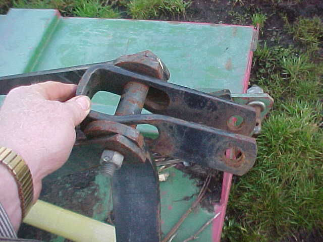

I have had several different tractors and this float thing on the 3pt is something that I've never heard of.
To keep from tearing up the ground I use the lift arms to regulate height. I also welded on a 4 inch shoe on the front of either side so it wouldn't dig in so bad. If I weren't in rough ground so much I think I would put a wheel up front on both corners.
Does you mower have a link that swivels where it hooks up to the top link? See att. If not, using a chain for a top link is a good idea.
Without the swivel or chain, the tire of the mower is packing the weight of the mower and anytime the tractor goes into over a hump or hole it will affect the mower to a much greater degree.

thankyou for the picture,no my new kingkutter did not come with one of those top swivels but after reading some other related topics i am not sure if they work on some situations. i e-mailed kingkutter about thi and havn't heard from them.i may try and call them or a place that sells parts. thankyou richard

I think I read where your cutter doesn't have the swivel connection where the top link attaches? That is most likely your problem. Try not hooking the top link up at all and see if it still drags. The only real purpose for the top link with a cutter is to raise the back for transport.
   / INFORMATION ON HOOKING UP A BRUSHOG
BILLY,ITHINK IF YOU TOOK THE TOP LINK OFF THE BOTTOM FRONT WOULD DRAG BUT I'LL CHECK ON IT. TODAY THERE IS A POSTING CALLED CHECK CHAINS AND ON IT THERE IS AN ATTACHMENT PICTURE OF SOME CHAINS FROM TRACTOR TO PINS ON BRUSHOG WHICH COULD BE WHAT I NEED TO DO THAN I COULD LIFT IT ALSO.THANKS RICHARD
