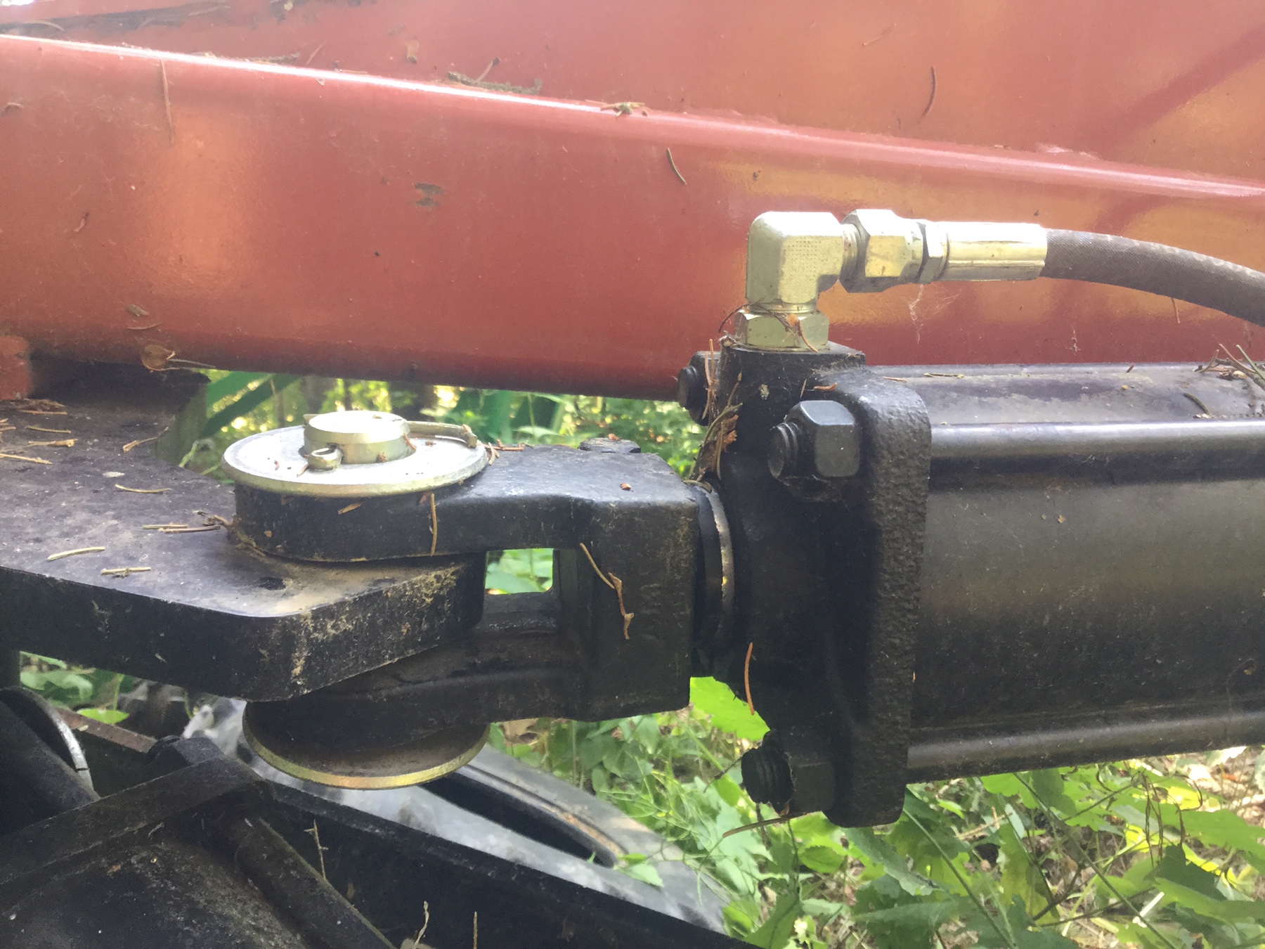

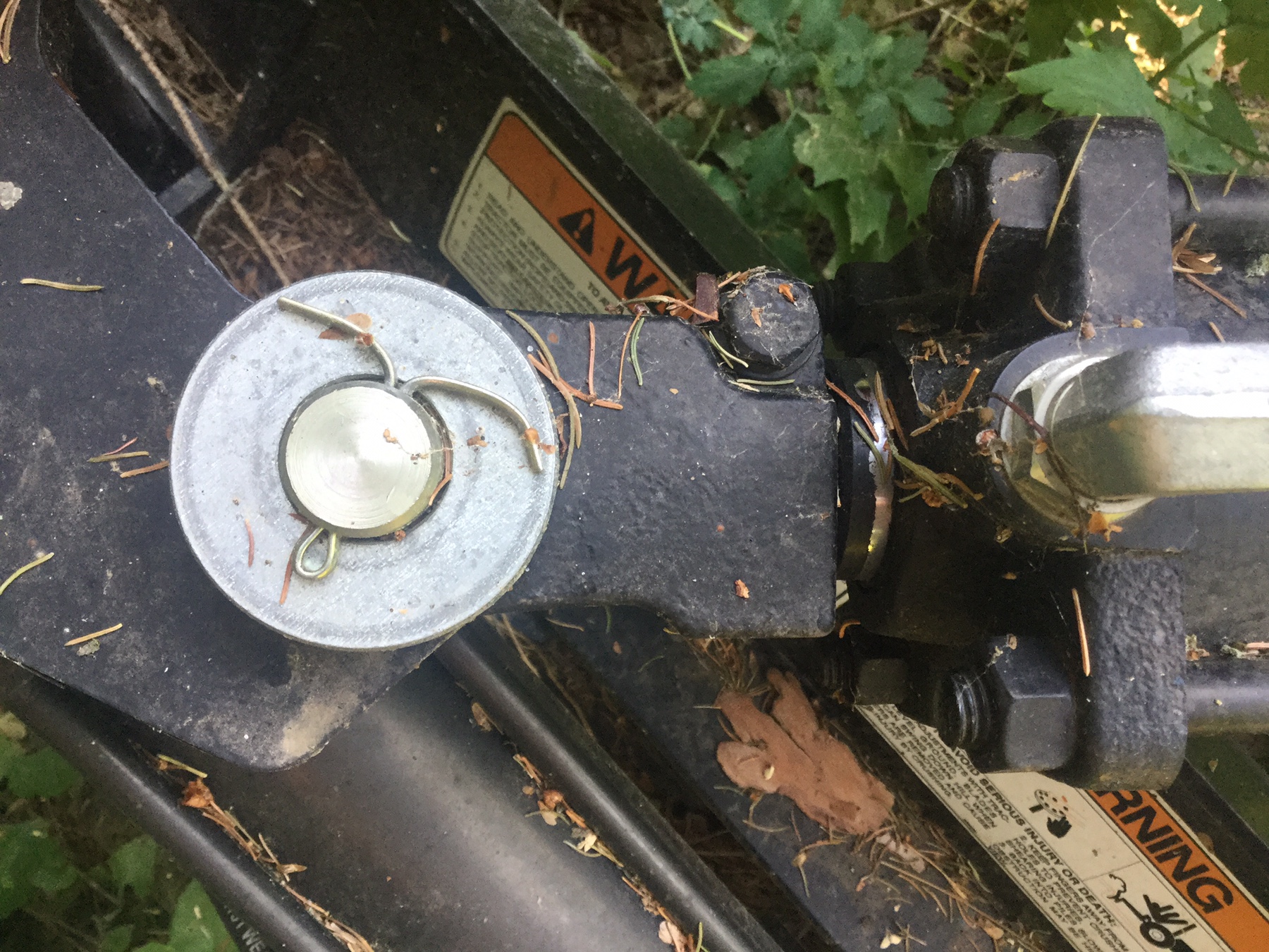

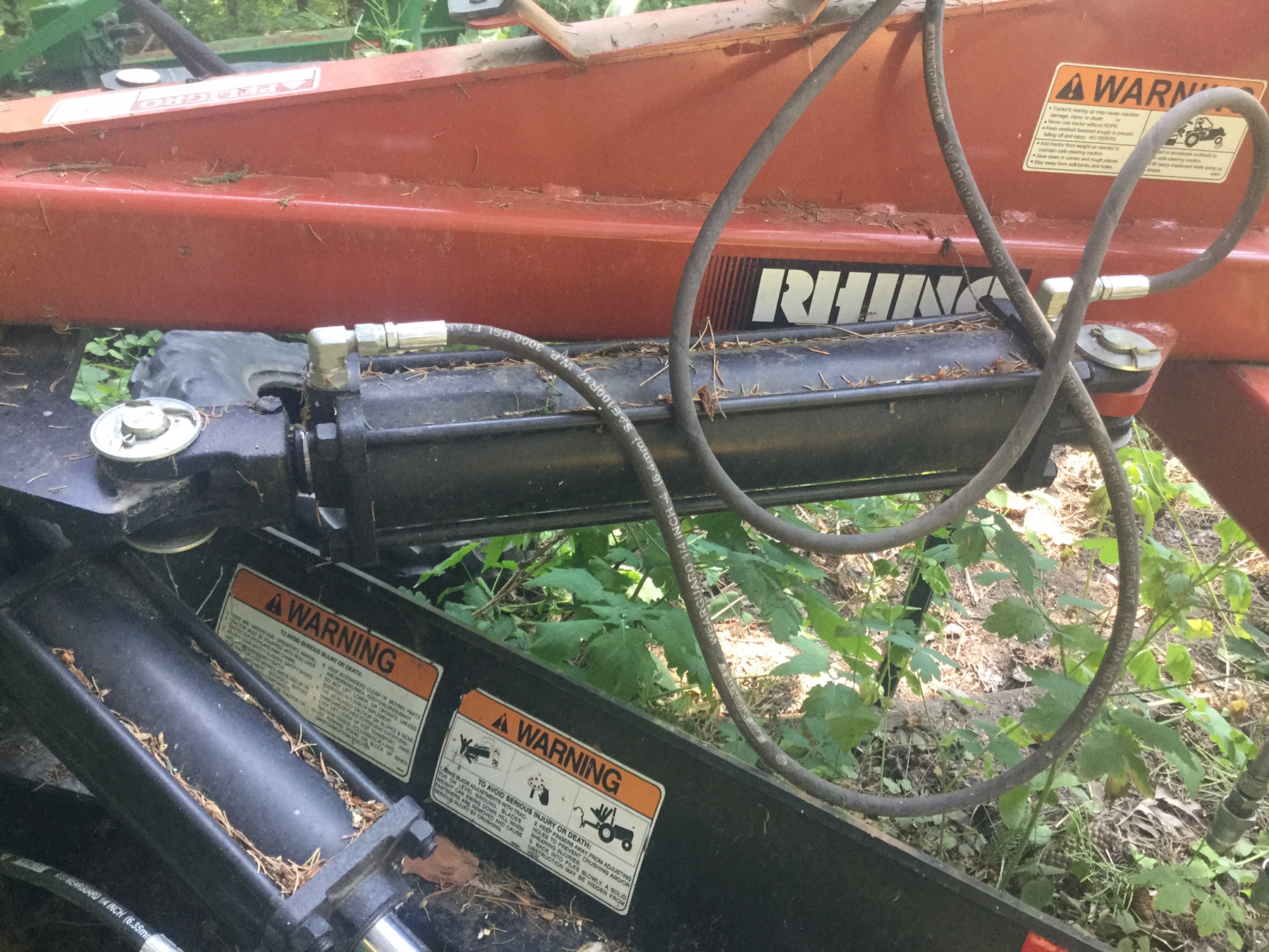

I have a Rhino 850.
I just went and looked, but can’t find any identification on the cylinder.
I can measure the retracted length as that is how I park it. But I have no plans on hooking it up and extending.
Bore size? - No clue. Any way for me to find out (without disassembly? Lol.) I assume this is only important depending on how “loaded up” the blade is when you try to change angle? Dirt or snow?
Pin size? - excuse my ignorance, but what do you mean? The diameter and length of the pins at both ends that attach cylinder?
Here’s a couple pics

I think you could "eye ball" the cylinder tube with a tape measure, then subtract 1/4". I am guessing 3"-4", probably 3 1/2"
You could measure the rod size of the other cylinder that is not fully retracted. I'll guess, 1 1/2", or 1 3/4"
For extended length he could just add 16" to your retracted length measurement. Probably 31 1/2"
I am guessing for pins, he wants diameter and working length. Probably 1" diameter x 2 3/4"

Total cylinder length is 26-1/2”, from pin center to pin center “as is” retracted, (my cylinder might be extended 1/2”, see above pics)
Cylinder tube length, from inside end plate to end plate is exactly 18”.
The SS cylinder that extends/retract is 1-3/4” diameter.
Pins are: 1” diameter, 3-1/2” total length, cotter pinned on both ends, pin hole is probably 1/8” from each end.
