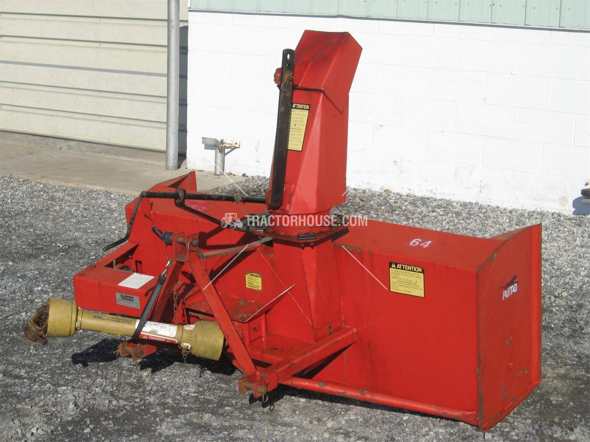

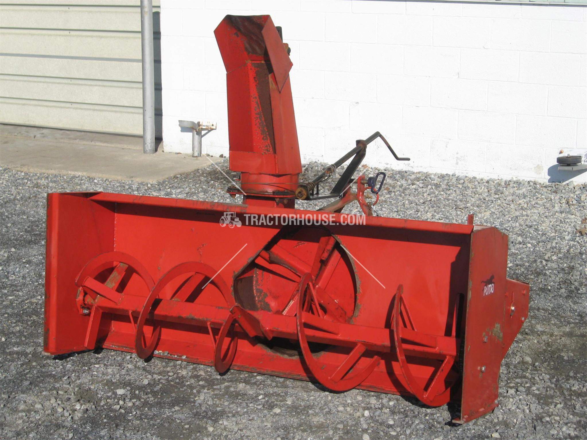

Dave, I saw videos of snowblowers like you described. Mine is a baby compared with them and uses a more conventional chute. A used farm equipment dealer about 1/2 hour away had it for sale. They deal mostly in larger equipment and didn't seem to have any great love for what they kept referring to as "that little snowblower".
I had them connect it to a tractor and rev it up to check for bad vibrations. It ran smoothly and they accepted the $1,400 I offered. It looks like it has a lot of life left but needs repainted. I've been gathering parts and pieces to make remote controls for the chute turn and tilt so I can stay in the cab. I'll post some pics when I get started on it. Again, thanks for your help. Here are 2 pics the seller used in his ad:

Looks like a good solid machine with only paint damage.
Copy other companies chute rotator designs is easy and inexpensive.
The remove valves are the expensive parts.
