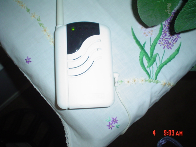

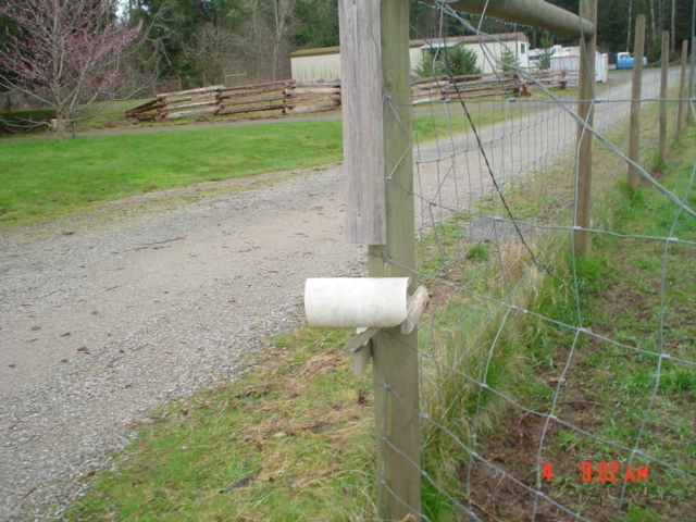

For our needs we use a wireless Optex as it is close to the house. Have two receivers, one in the house and one outside the barn. That way if we are outside in the backyard/garden or the barn area we know if someone is there. :D
Pics are of our wireless unit. Put the transmitter unit on a post inside a pipe to help keep snow/rain off. This wireless unit is only good for about 250-300 ft from transmitter to reiceiver.
