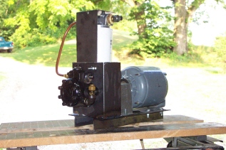

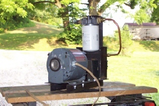

Put together an inexpensive filter cart using mostly used parts. The pump is an old 1725RPM Sunstrand J model fuel oil pump used on old oil burners. A used 1/3 HP blower motor. Misc. fittings, steel angles etc. New 3 Micron filter assembly.
I have used it once and it worked well. I'm working on a quick attach system with flex hoses to hook it to the tank quickly.
The fuel unit pumps about 25 gal an hour.
