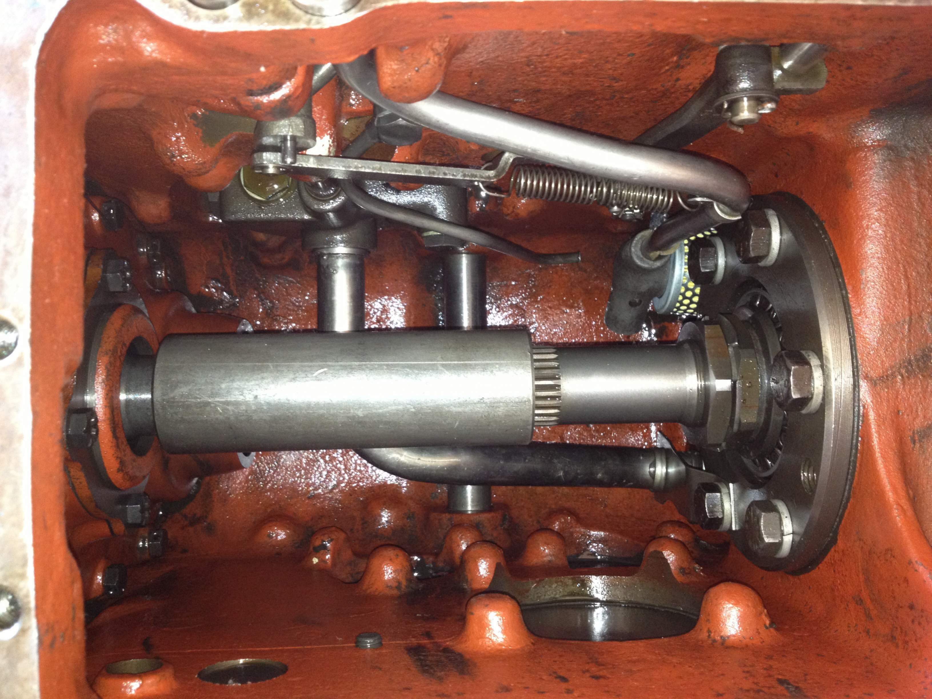

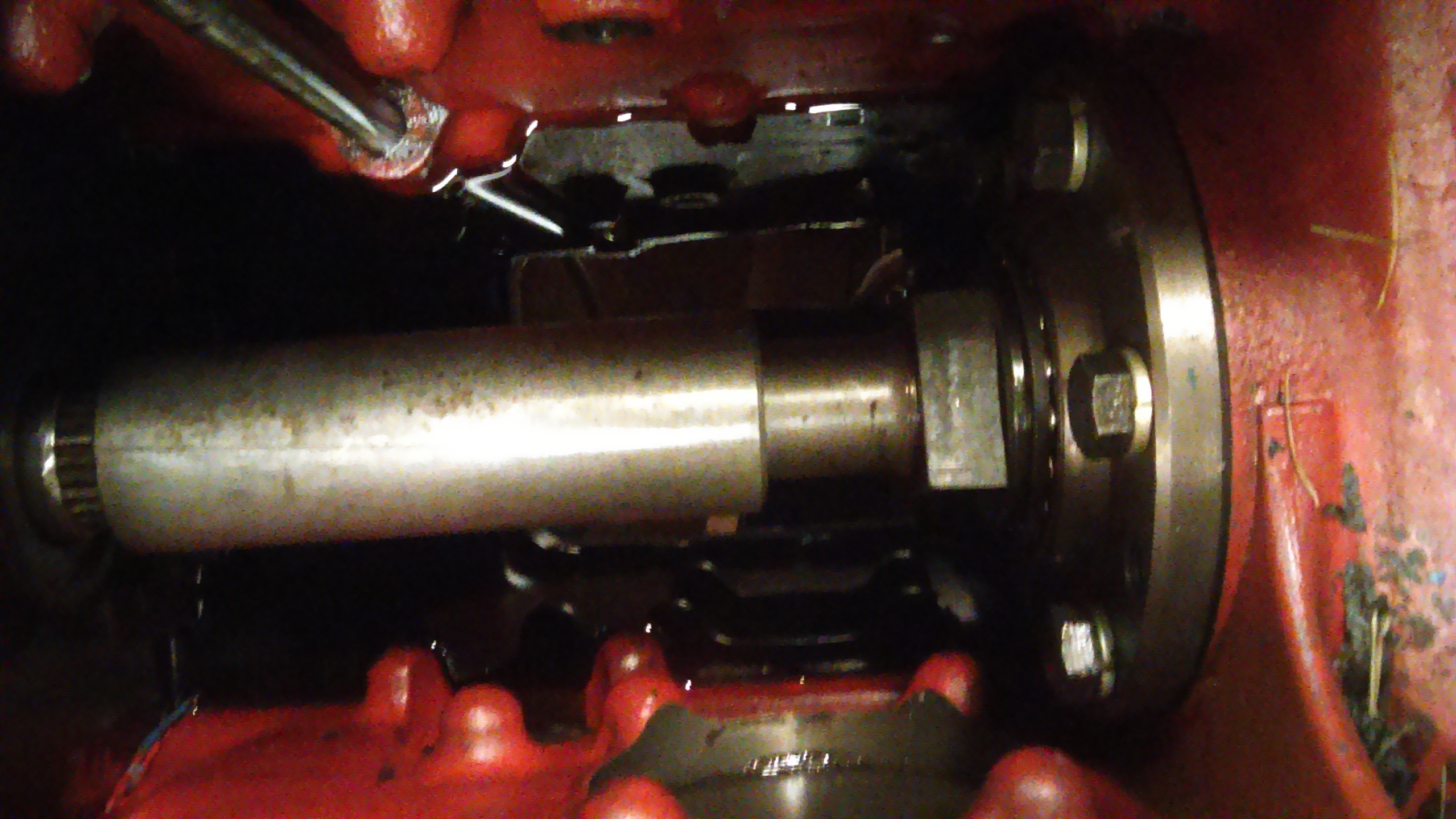

Hey fellas. Been awhile since I posted anything, because honestly the tractor has just been sitting. But now I need it so it's a big push to get it up and going. I will be using this thread to hopefully document some of the things I've been doing to help others as a visual guide. Keep in mind that I am not a tractor mechanic. I'm a diesel mechanic, but tractor work is new to me. So far, it's all been pretty self explanatory, nothing too head scratching. I'll try to round up some pics of what's going on and what i've done. Right now it's blown apart into a bunch of pieces, not split apart (next time it will be) but doing a general run through on the systems. I do have a question that I was not able to get an answer to from the manuals I finally received today. I noticed a lot of play on the pinion bearing for the rear end. If I turn an axle shaft, the bearing actually moves in and out of the race, I see that there is an adjustable nut that is split with a lock bolt on it. Parts diagram looks like there is supposed to be a thrust washer between bearing and nut. Has anyone else run into this before?

Thanks for the heads up city farmer. I checked them out, but it turns out that amazon is actually cheaper than they are. Motion would be 130 just for two cups and cones. Amazon ended up being about 80. Both are timken. I'm an amazon prime member so two day shipping is free. FYI my particular numbers were 382 and 387. They DO NOT have an "a" or "s" after them. Those particular bearings are easy to find, they fit a gm corporate 14 bolt carrier but are a little different. I'll definitely keep them in mind later on though. Have you had a peek at your pinion bearing before? I think I'm just going to pre load it a little for now and call it good. Find thrust washers when I split it apart for the trans work later.

Here's a picture of mine when I was in there replacing the filters.
Edit: I thought that was going to help you. That's a picture of my 4400 and not the 3000.

Hey that's alright. I can see that there is a thrust washer in there and you don't have 1/8" of endplay like I do. Thanks for taking the time to post. Tore apart my ripper cylinder today, rod is shot, end of it was full of goo too. The list continues......
