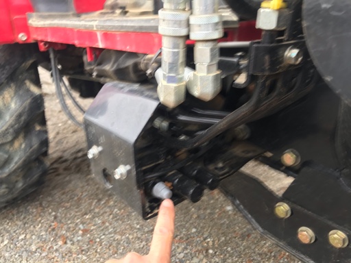

Has anyone tried to increase the hydraulic pressure on their 1500 series by adjusting the relief? When I had a 790 Deere there were shims that could be purchased from Deere and added under the relief spring to increase the pressure. I'd like to get a five hundred more pounds of lift when using the fork attachment on my loader.

Is there an adjustment in the valve or shims to increase it? I do have a gage but have not checked it yet. Next step..
Simple adjustment- remove cap on loader control valve. It will reveal something like a 14mm jam nut and screw. Loosen the jam nut and turn the screw in to increase pressure.

Put the guage on it yesterday and it read 2000 psi. Service manual said the pressure should be 2205 psi. It didn't take much adjustment to get it to 2400. Have not tried the pallet of feed yet but I've noticed some improved gripping capability with the grapple. Thanks for the help RNeuman. 100td thank you for looking out for my safety.
