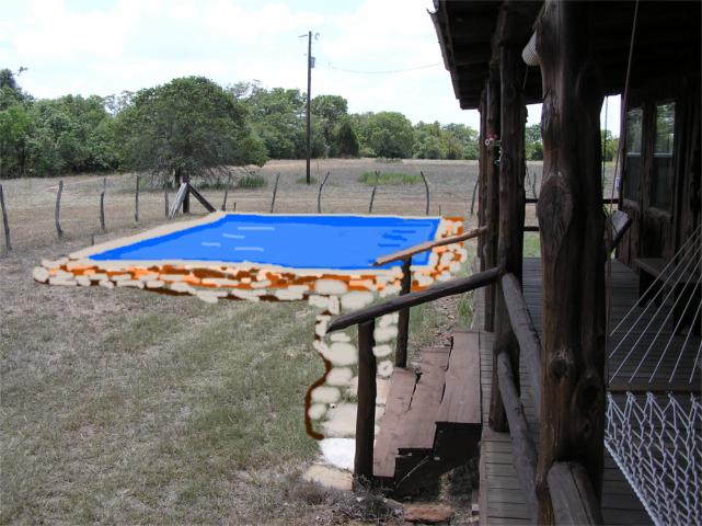

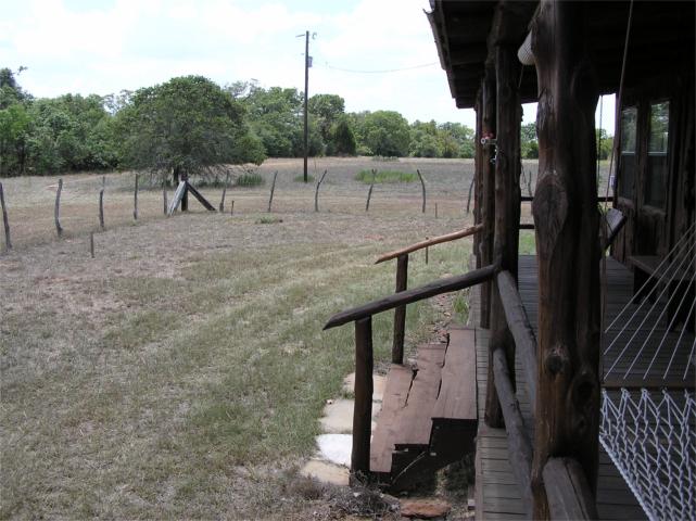

I see my backhoe, I feel the heat, I see a nice place for a pool, Can I do it?
There is a group of friends who meet weekly for a fierce game of water volleyball. I can see the use for the pool 7 days a week for about 5 months a year. The in ground vinyl pool kit is about $7,000.00. with decking etc... I figure 10-12K.
Has anyone installed an in ground vinyl pool? Any suggestions welcome.
Any one have the perfect size and depth for a volleyball pool?
I really feel the heat.........

Don, I think a pool where you put it would totally wipe out the ambiance of your cabin. Then again...ambiance won't keep you cool in 105º, so what is it worth?:rolleyes: :)

Jim, with the right pretty little cedar rustic shade structures and landscaped with cactus like plants, and native rocks etc...
I agree the ambiance would change from a remote, woodsy, hill country, desert, ambiance to a more oasis feeling (I hope).
We are thinking about building a house in front of the cabin instead of the more westerly hilltop location because of it's central location. The cabin would then loose all ambiance and just be the pool house.
One think for sure, I'm not building in the Summer again.:eek:
Jim, Thanks for your observation, We will think and re-think before we dig.
I do think the 20' by 40' is the best size. The depth should be about 4' on the ends going to 5' in the middle.
