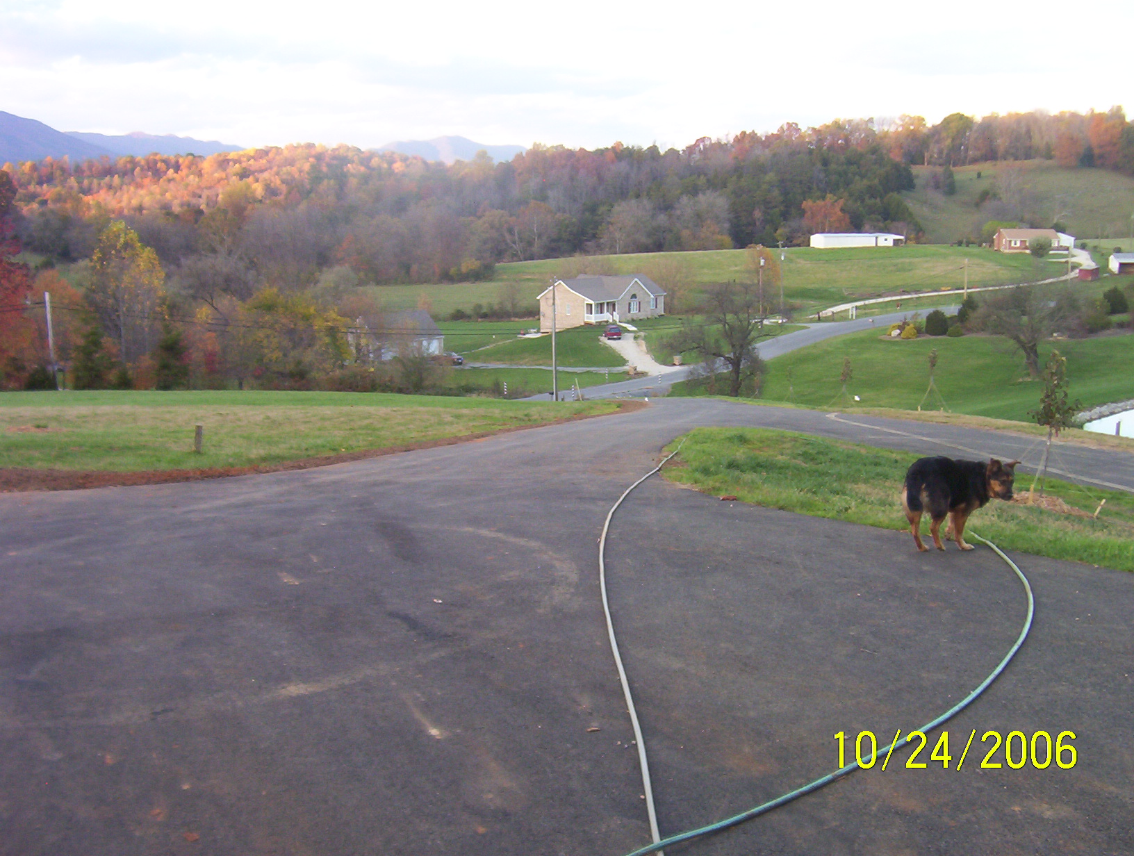

I recently bought a TZ25DA. I also got a Back Blade. It is suggested I use the back blade for snow removal. I have a new drive way (asphalt) and I just think the blade will tear it up. I am considering of going to a local machine shop and asking them to make "shoes" that will keep it off the ground. 3 shoes one middle and one on each end? Now how much height, my incline is very steep, 15 to 30 degree incline. I was also told just raise the blade using the middle bar above the ground. Still on the incline it may rub into the asphalt? I know because I did not have it raised all the way by accident and it gouged it already going from flat to incline.
I can post a picture if that would help. I currently have 25 hours on it, should I change any filter, fluid before the winter? Standard delivery grade is 10-30 in the motor.
Suggestions and experience would be greatly appreciated.

The shoes are pretty common, although I don't use them on my gravel drive. They should work just fine with only two unless you have a high crown on the driveway. Set them high at first and make a dry pass to see how low the blade rides all along the driveway. Lower them until you are comfortable with the clearance and remember that you will be leaving that much snow on your drive.
If you want the whole thing cleared down to the asphalt, use the rubber edge trick.

Here is a picture of my drive from the top. It does not show as bad as from the bottom. I guess I should stay with the recommended filter, change sequence. I am considering of going to Synthetic but not until I hit 200 hours. I like the idea of wood, just not sure how to support it as my bottom piece has a bend in it. I need to see about getting the rubber, that should form to the bend and be just below the edge. I think I am going to wait for the first snow fall to see if I need chains, hopefully my turg ties and 4 wheel drive will carry my up as I blade down hill.
Thanks for all the tips and help.

Widest picture I have ever seen on TBN. I had to scroll from side to side to see it all :)
