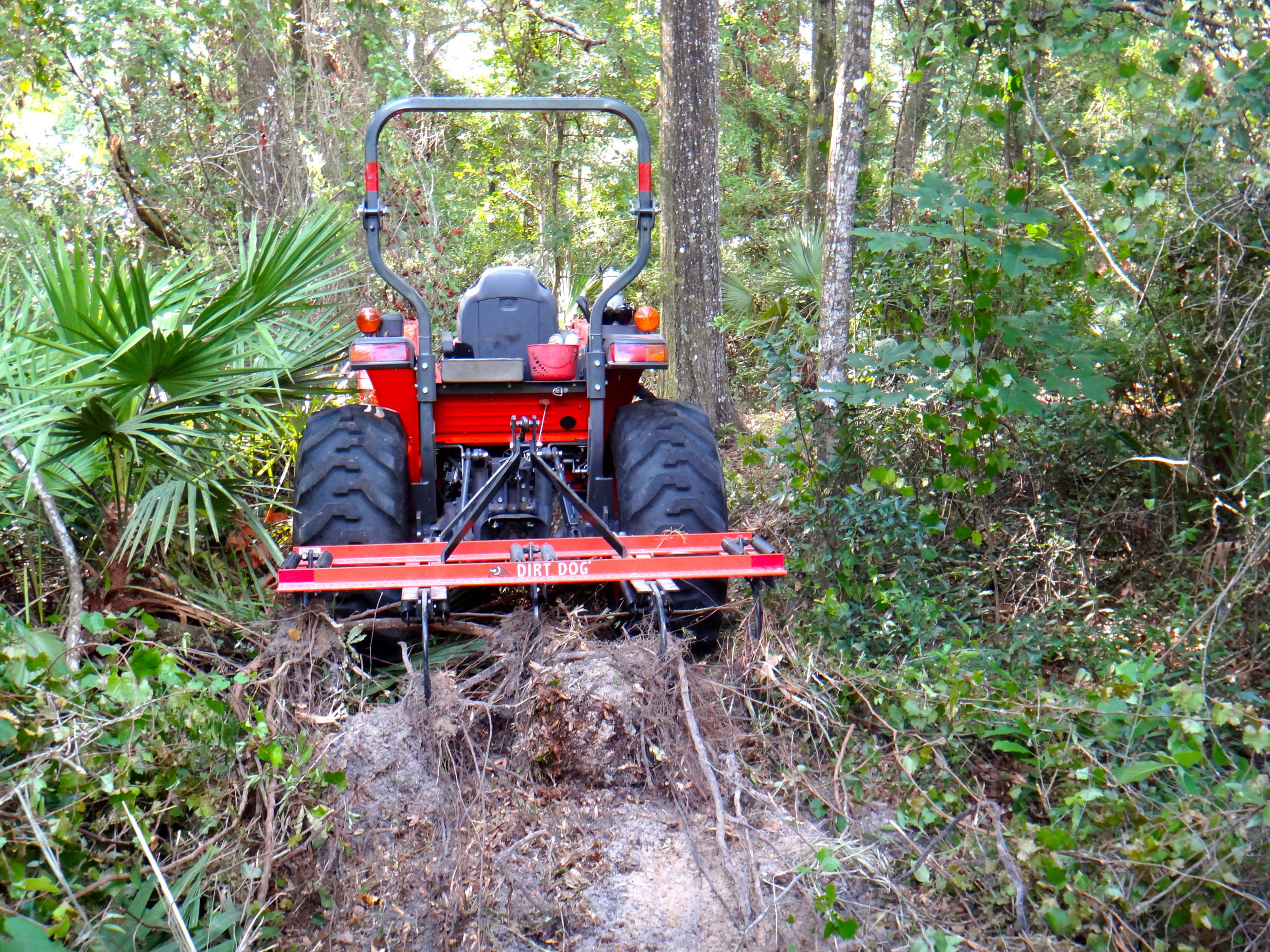

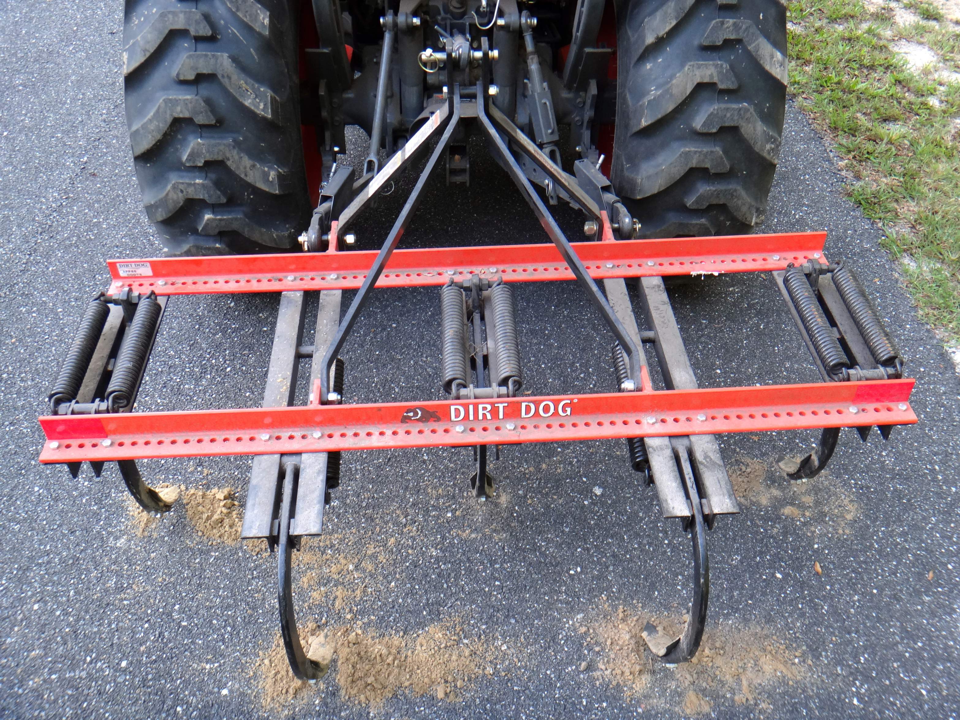

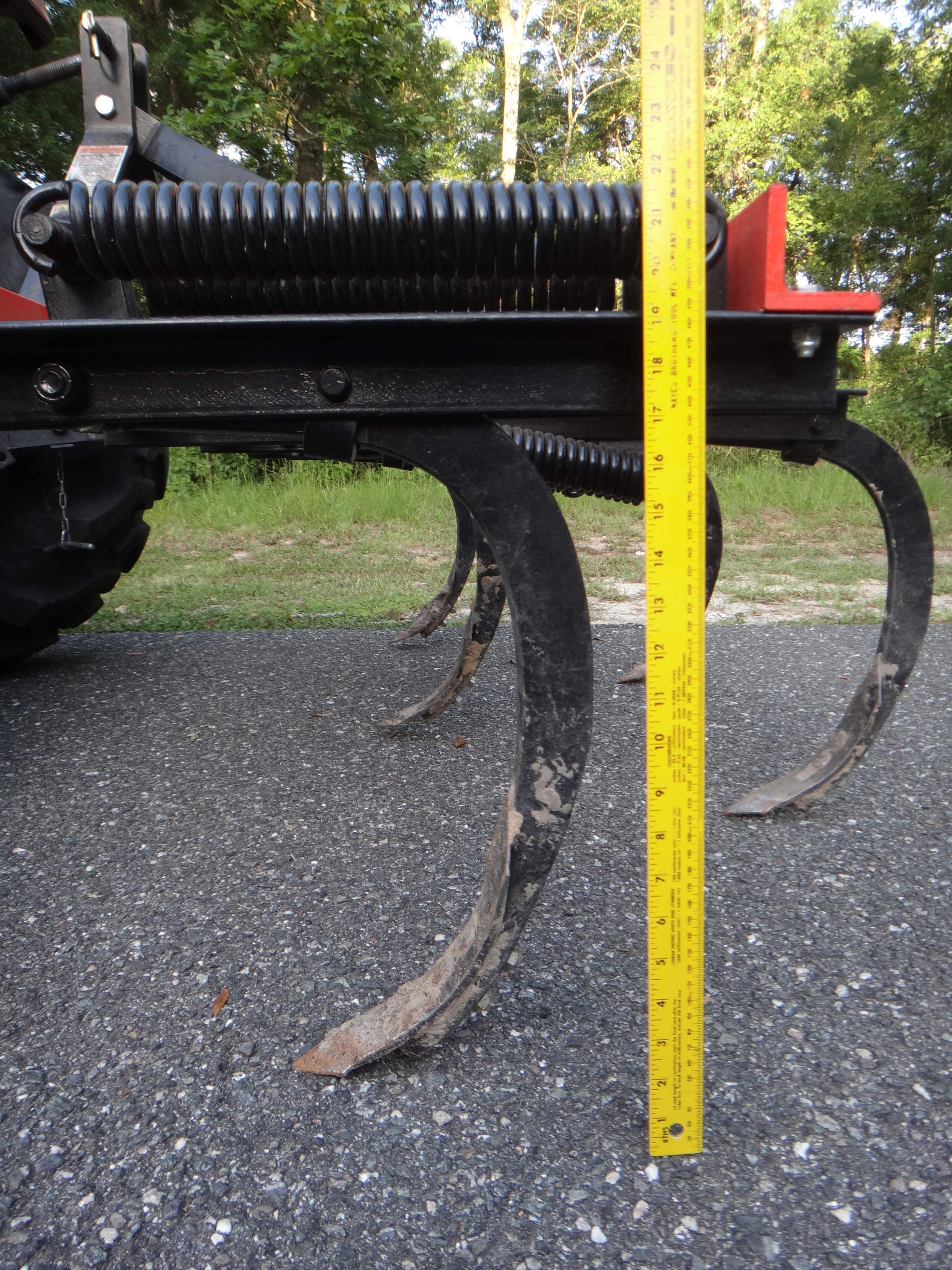

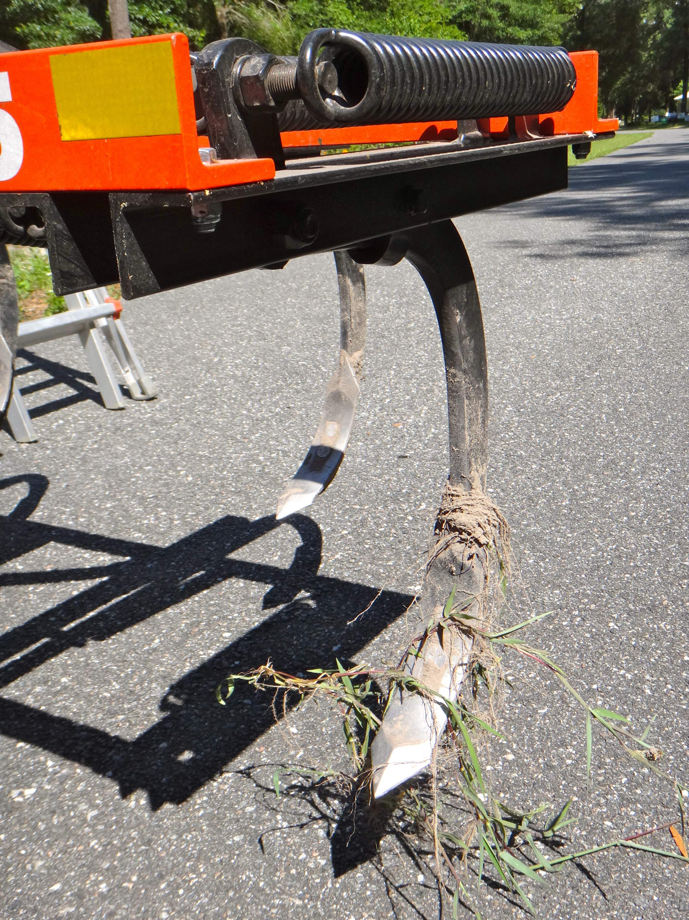

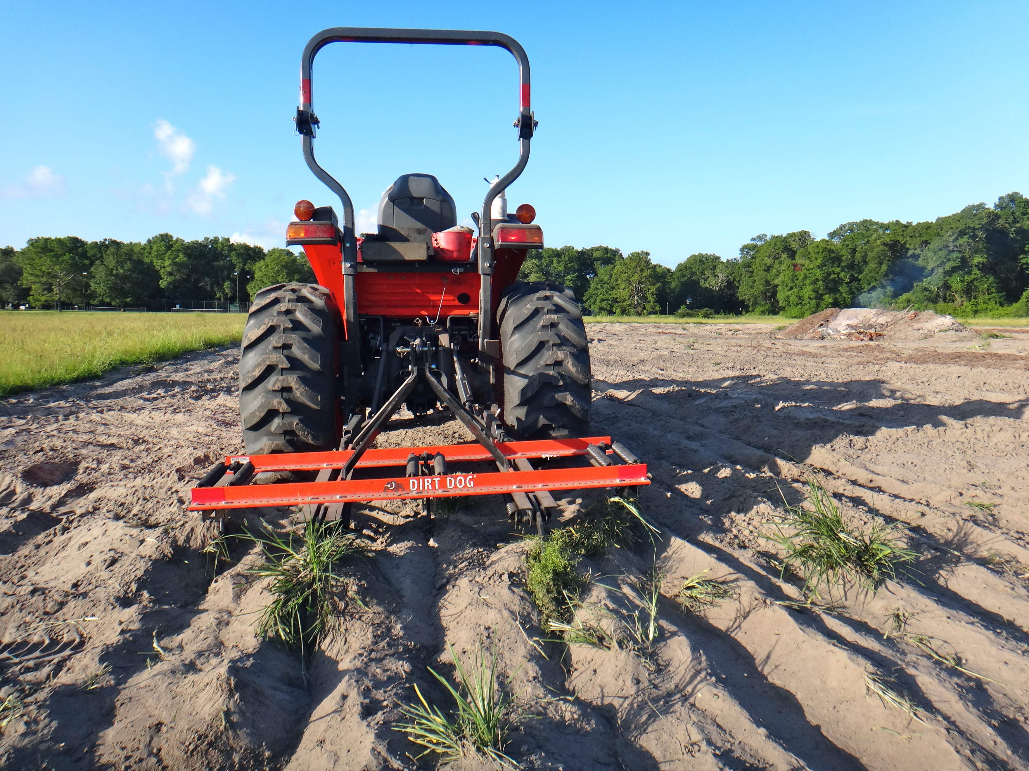

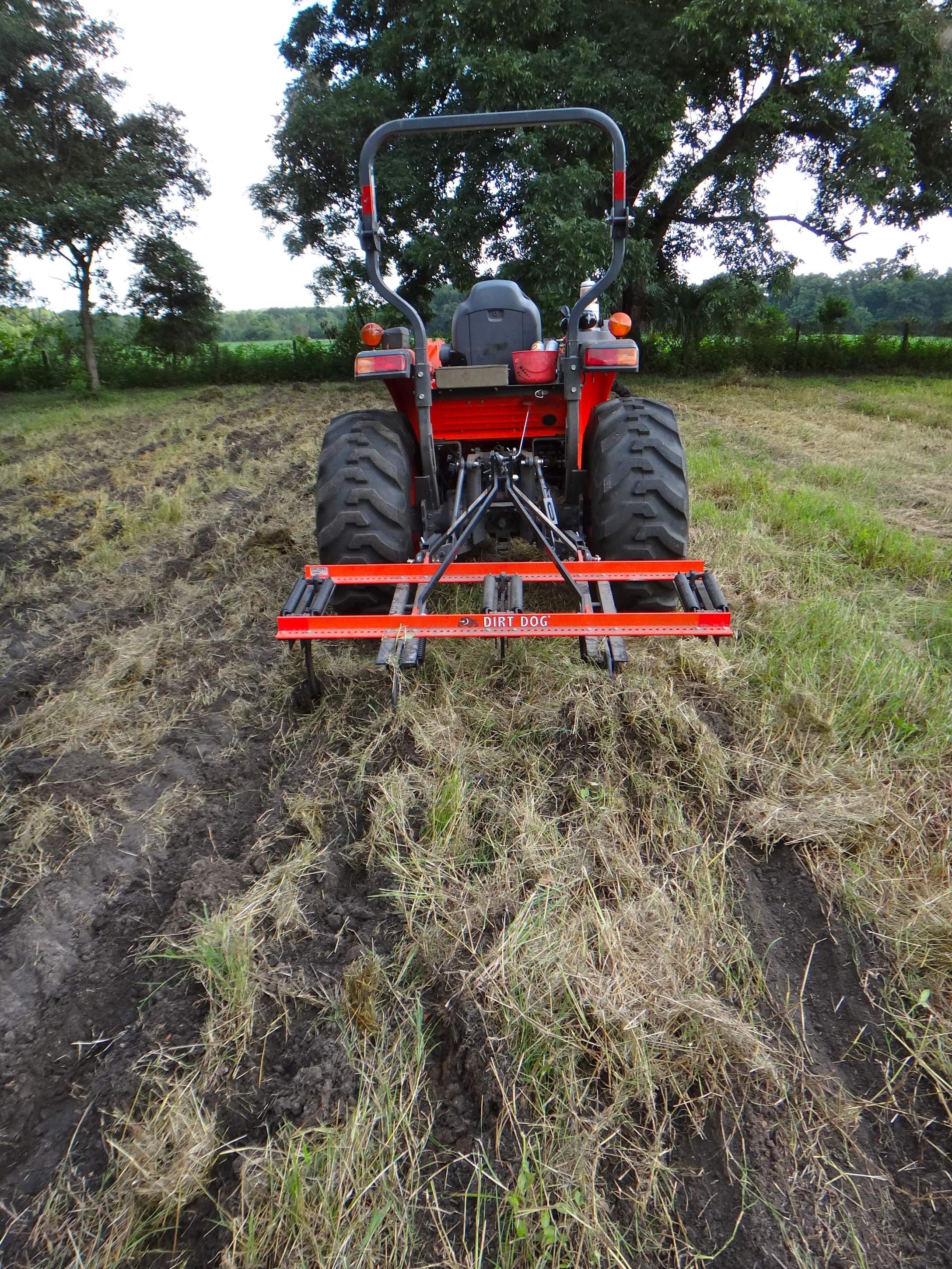

I expect an offset disc with 20" diameter pans, probably all you can pull with the Deere 3520, will penetrate 4" on the first pass and 7" on the second pass. Will this be enough? You do not want to mix less fertile subsoil and more fertile topsoil together.

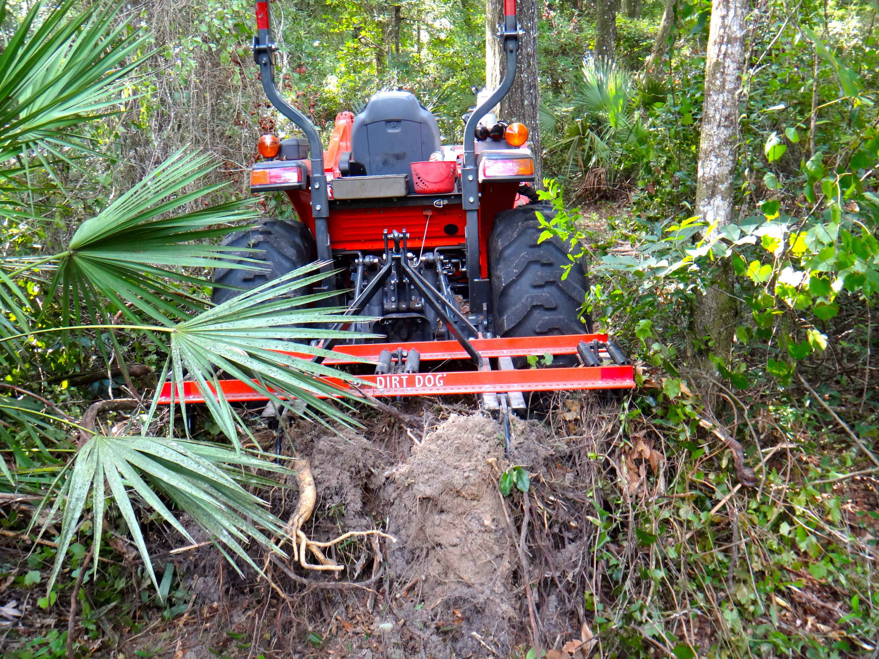

A Field Cultivator, which is a light duty Chisel Plow, will penetrate to 10", aerating and loosening the soil, while leaving soil layers intact.
The two brands of currently manufactured Field Cultivators suitable for your Deere are Fred Cain and Dirt Dog. You may find used Ford/Dearborn and Bush Hog brands. Your tractor can pull a five shank, 66" wide Field Cultivator for sure = $900.
Also search for pasture aerators. There are many types and designs all somewhat like Field Cultivators. Generally speaking, pasture aerators penetrate only to 6", Field Cultivators deeper.
EverythingAttachments Video: https://www.youtube.com/watch?v=3R-8ZhFlO5Y
Field Cultivators on eBay (2): Field Cultivator in Heavy Equipment Attachments | eBay
All Purpose Plow in Heavy Equipment Attachments | eBay
You do NOT want a so-called Field Cultivator with S-tines.
