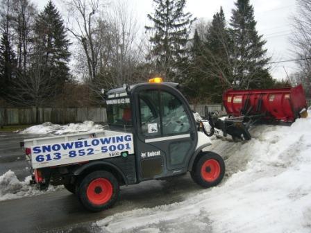

I like mine for snow. It does about 150 residential drives and a few condos every snowfall up here in Canada. I have a blade, blower, bucket, ice scraper, pusher and sweeper for it.

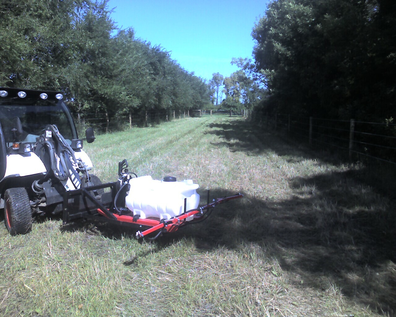

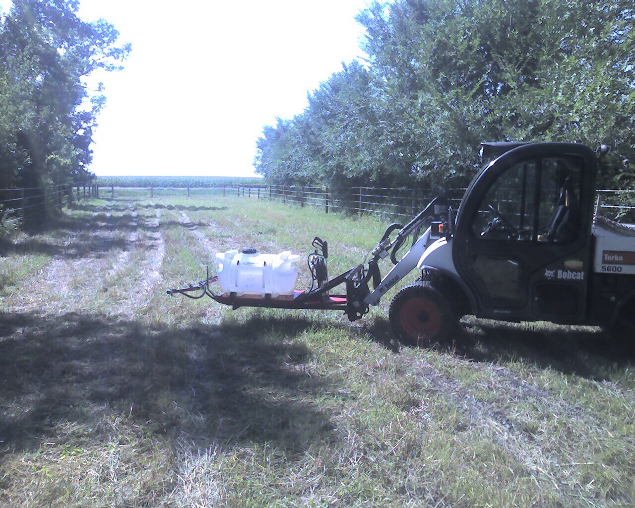

I have found a convenient sprayer and a convenient spreader, both for ag use on pastures. I took a tow behind sprayer and put it out front, where I can see it, and have far greater control of it. (It does get stuffy when spraying since I don't run the air.) I can drive in to get hard to reach areas.
The spreader I purchased at Fleet Farm, and plugs into the receiver. Information is available on it from Northern Tool at
SpinTech Seed Spreader &#151; 100-Lb. Capacity, Model# 100SFTV | Lawn Spreaders | Northern Tool + Equipment This is the 100 lb size. There is a bigger size.
I have a great little gaget which is a 2" receiver that clips on the lift arm, for moving trailers. I put that on the front, and inserted the spreader into it, so could again have better control.
Had a plug put on the lift arm, controlled by a switch inside, so could turn the sprayer on and off from inside. The spreader came with a long enough cord to plug into power inside, and in-line toggle switch.

thats pretty cool. does it bounce much?
/ Impressed by the Toolcat. #14
I haven't had any trouble with bouncing. It is all bolted together as a unit, and my fields are pretty smooth. The same thing could be done by mounting a sprayer to a pallet and carrying it with forks, but that might bounce a bit, or one might be more prone to catching a corner of the pallet in uneven ground.
