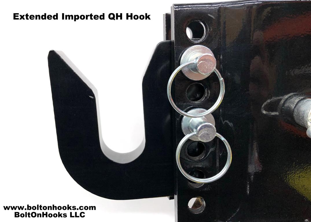

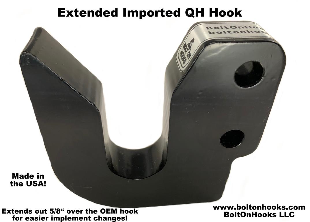

KBOGH/BoltOnHooks LLC is proud to introduce the Imported Quick Hitch Extended Hook for the Harbor Freight Quick Hitch and other similar systems with the adjustable top hook. This new hook extends out 5/8" over original hook making implement changes faster, easier, and in some cases even possible. The hole spacing is 40mm (1.575") center-to-center, the hole diameter is 12.7mm (.500"), and the hook is 1" thick.

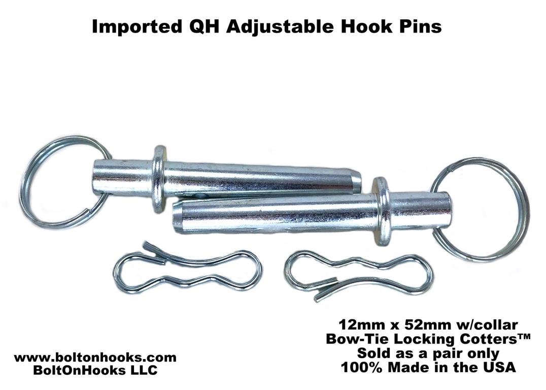

We also have Imported Quick Hitch Adjustable Hook Pins. These pins will allow you to remove the existing bolts that hold the hook onto the quick hitch frame to facilitate easy height changes with no tools required. These pins also add in a bit of extra "slop" or "play" that will let the implement attach easier in most cases. 100% made in the USA of the finest materials available and zinc plated to resist rust and corrosion.

I was surfing your website just this morning and saw the HF retrofit extendo hook that you now have! Unfortunately, I modified my hook 2 years ago before yours came out. The pins, however are something that I don't currently own.

I've made 3-4 of those already & they make the QH so much more usable. Both the extended hook & the pins. $40 is a bit steep, but worth considering, especially if you dont have a welder or the other tools to make one. I'd have likely bought one back before I got my welder.
