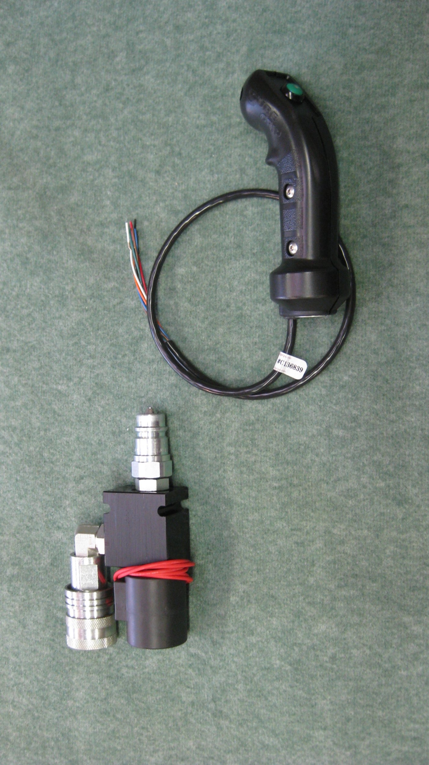

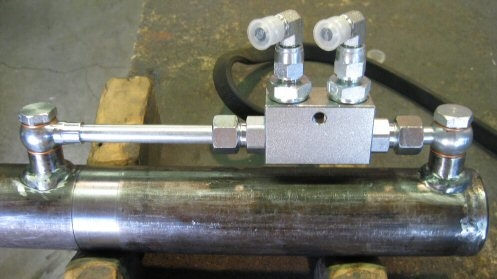

The easiest thing is an on-off valve at the coupler. These can be manual or electric. Or an actual check valve mounted on the cylinder itself.
Just to be absolutely clear, the issues are with the cylinders on the mower, not top & tilt cylinders on the 3pt hitch? The electric valve setup is about 2-3 times the cost of the other options.
If this gets adjusted very often, I would be looking at the direct mount check valve for your application.
Do you ever need any of those cylinders to float so that the mower follows the ground? If so, then the electric on-off valve would be the way to go as long as you have a control valve with the float feature. ;)

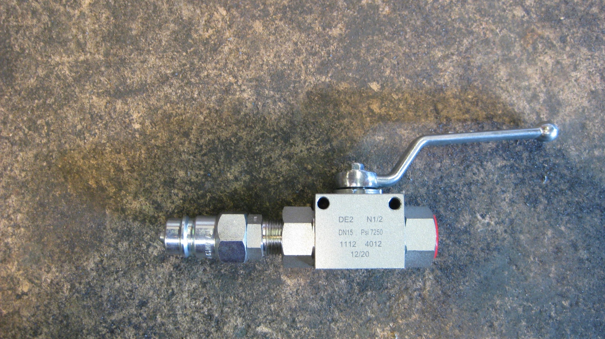

I had the same problem, bought this miniature ball valve at the local hydraulic shop. It was $5 five years ago, afraid to guess what it costs now.
