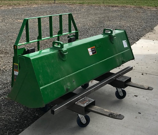

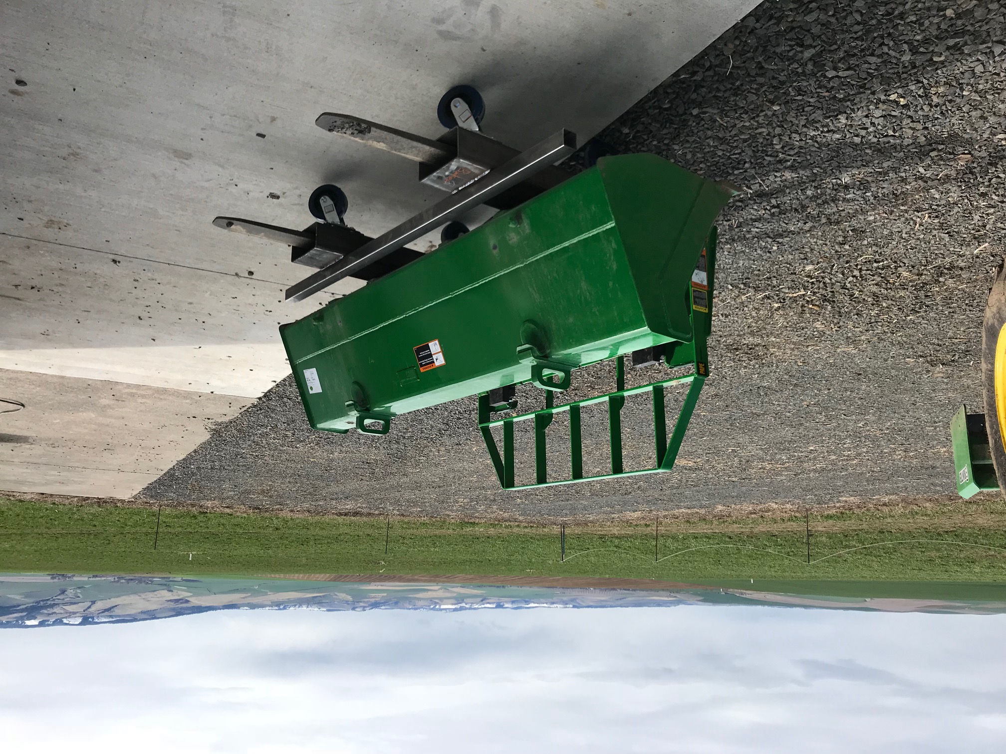

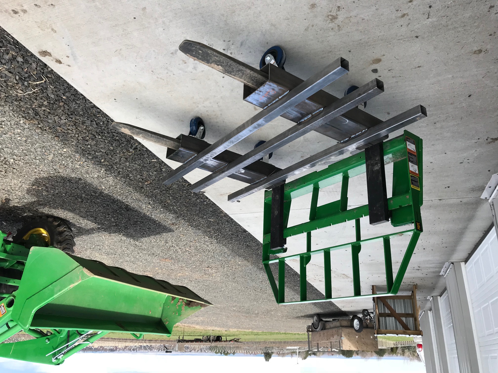

I guess I missed out on being included in the beauty contest for "Best Home-Built Tractor Add-Ons". Here is my entry- an implement dolly that will simultaneously hold a front bucket and pallet forks. I modeled it after a product from Artillian, which I thought was elegantly simple. I upsized the Artillian design for my larger implements. I think I built it from 4x8 and 2x2 tube steel and casters from Harbor Freight.

Nice job, rugged and simple.
   / Implement Dolly #3
I like that a lot. 2 for 1 with mobility.

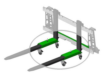

Yep, the picture from Artillian is in my Projects File:
Yours is an improvement and could even be done with out a welder: :thumbsup:

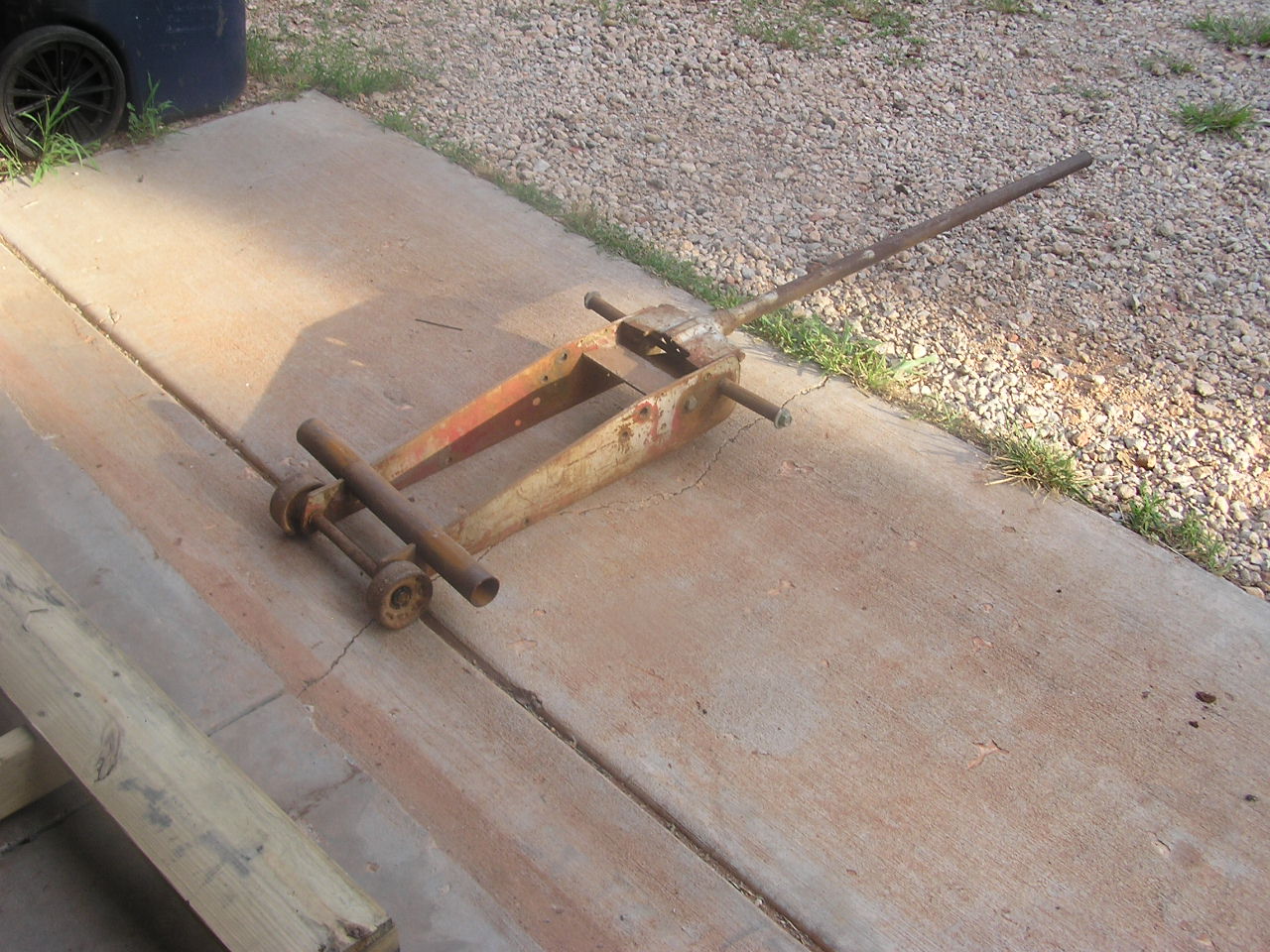

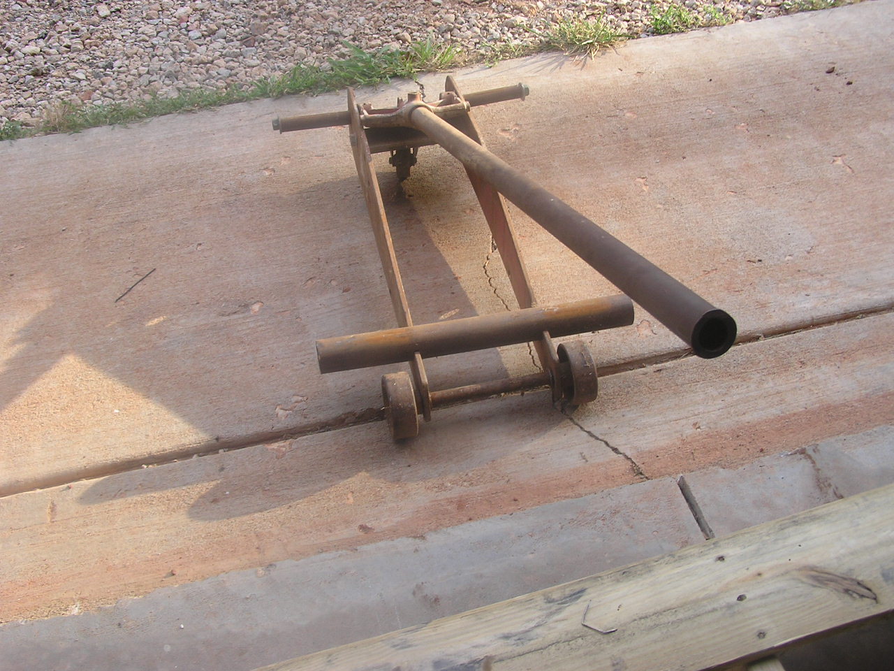

I have two sets of pin top forks, so the set not on the attachment plate is stored on an old modified floor jack turned into a dolly:
