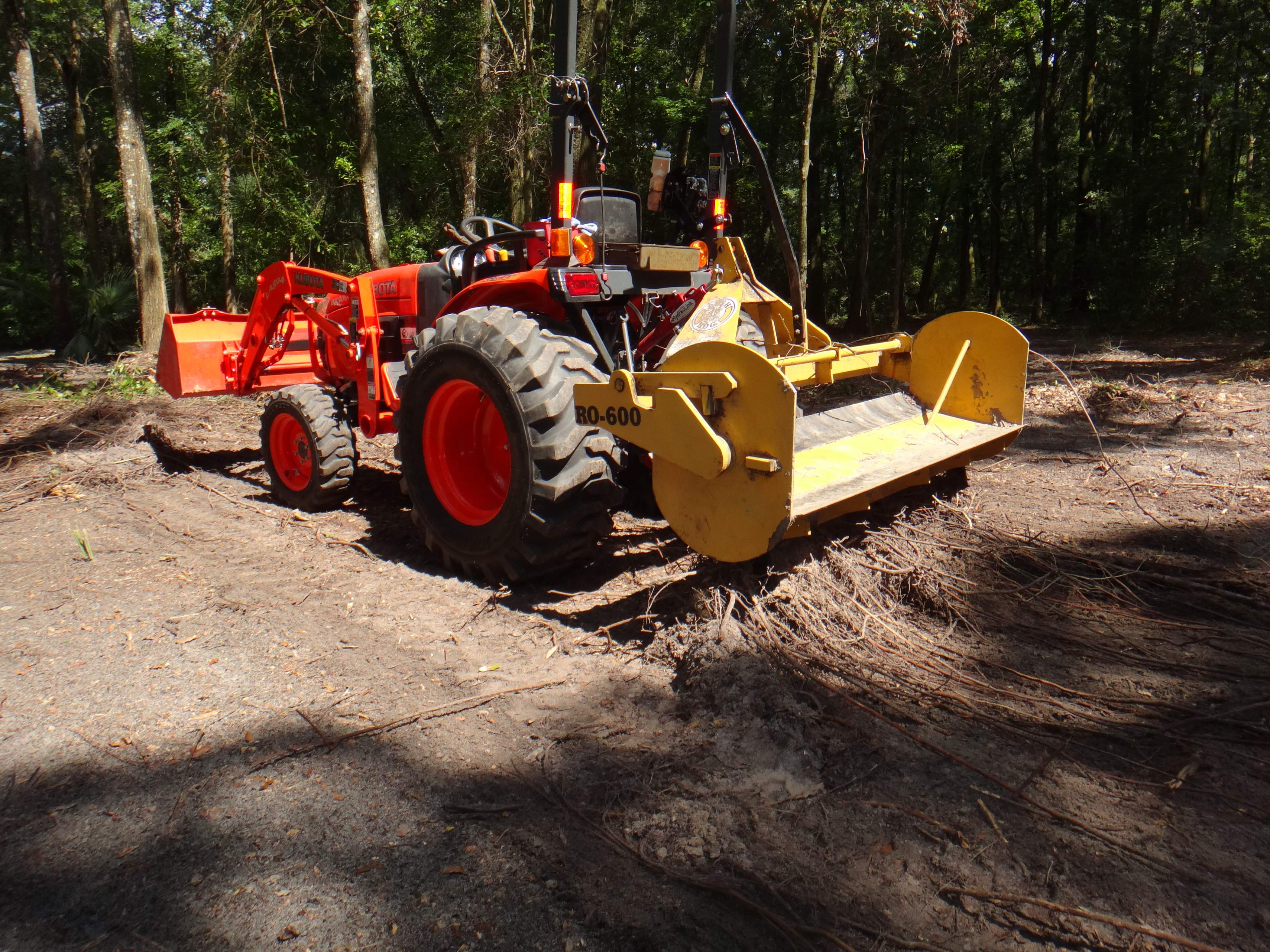

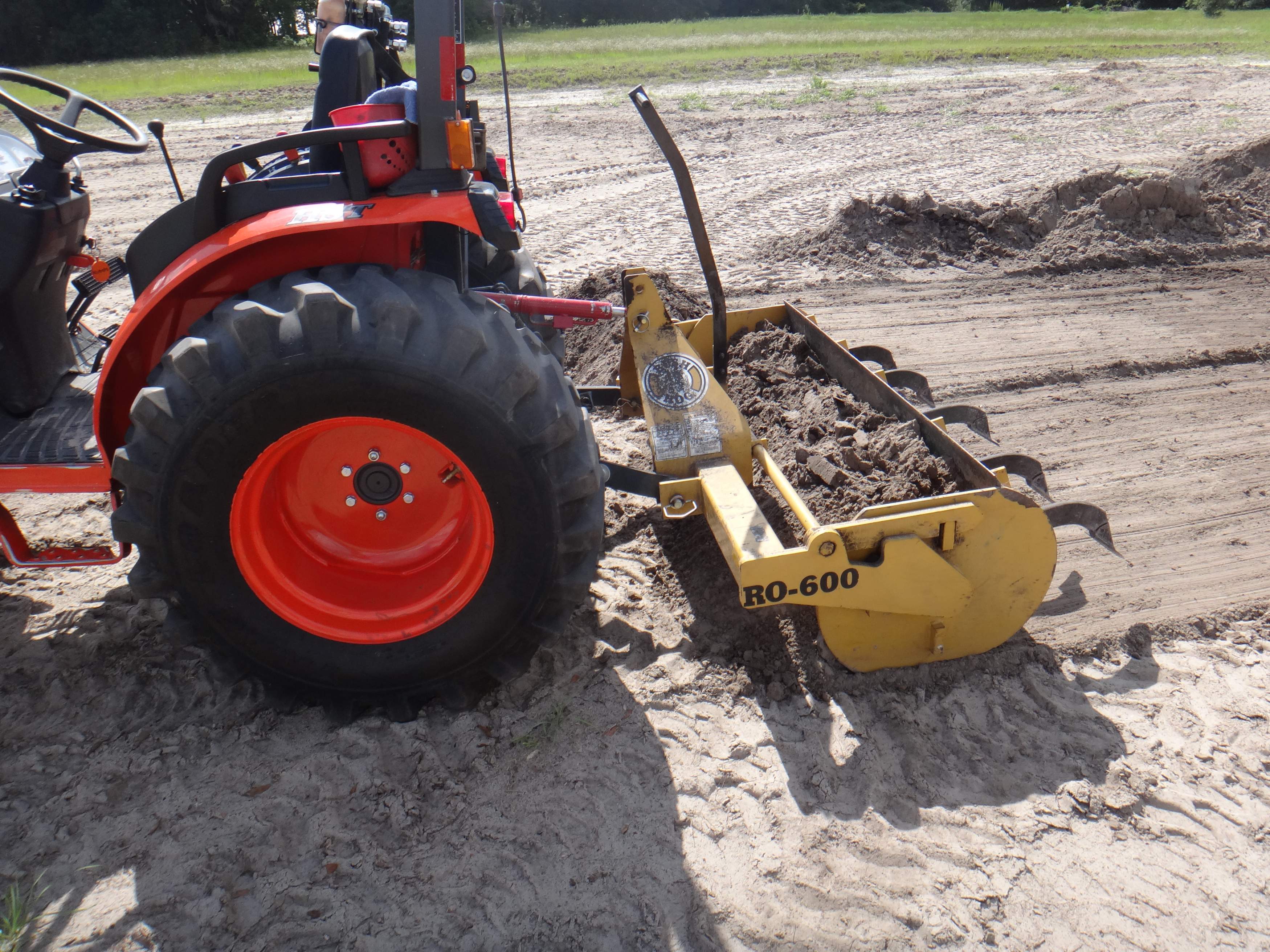

I pull a Bush Hog (brand) 60" wide Rollover Box Blade weighing 630 pounds = 126 pounds per foot.
My soil is typical of Florida: sandy-loam.
