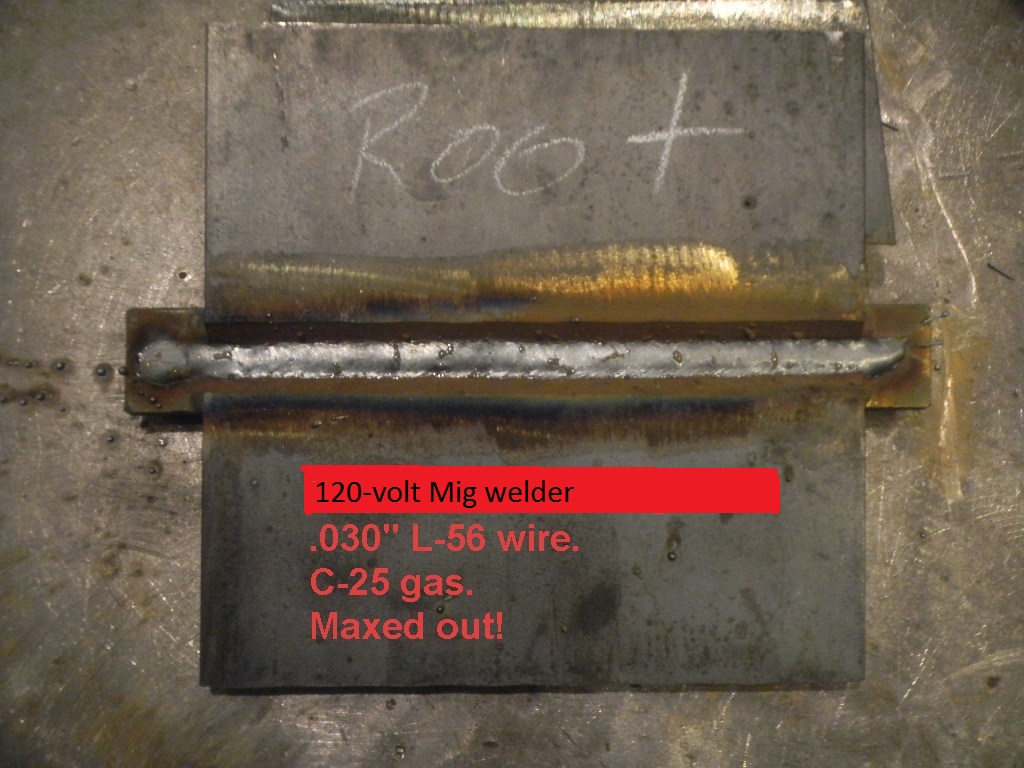

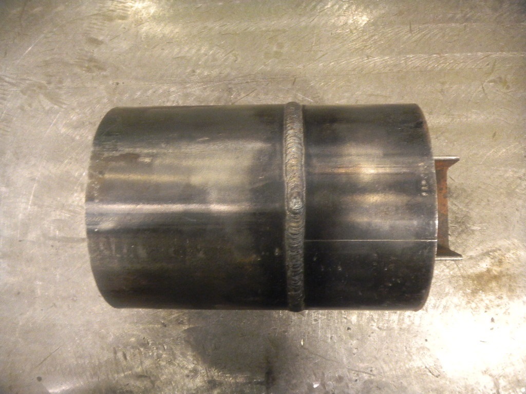

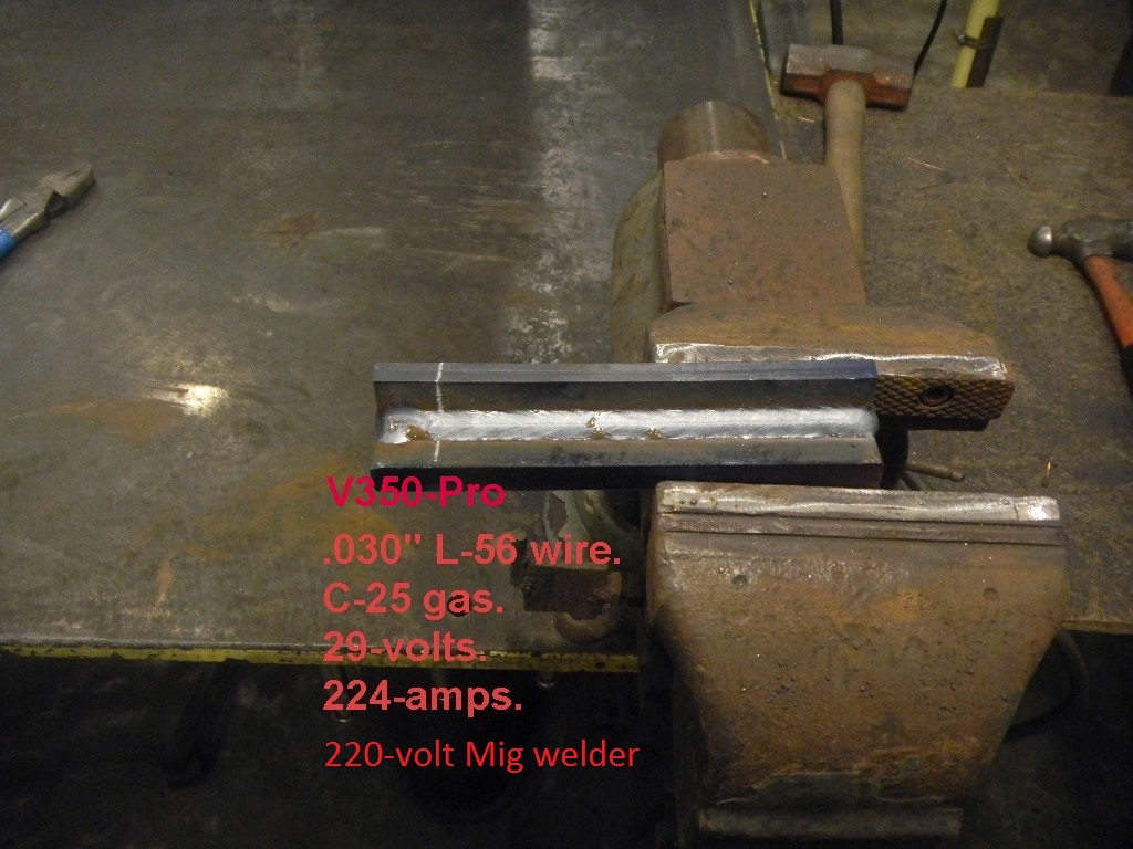

When you make out your material list, and go out for pricing. You'll find, you cannot build a trailer cheaper than you can buy one.
With any welding project, proper joint prep is crucial! With any wire feed welding, there is no substitute for power! Mig welds can look great, but not have any penetration to them at all.
