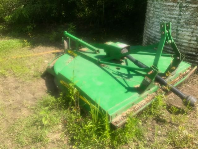

I have a 2007 MX6 cutter. My issue is the top link connection on cutter to the iMatch Q.Hitch?
As u can see in photo the top link connection bushing on the MX6 slides back and in not in vertical alignment w the 2 bottom bushing lift arm connections on the MX6.
i have to manually pull the top link bushing forward to hook up the imatch.. let it go and it just falls back outta position?
any clue on how to keep the top link bushing on the MX6 FORWARD for easy vertical hook up w imatch??? tx n advance

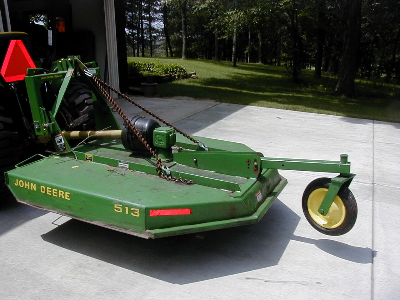

I just pull the top pin on the iMatch back a bit, and flip one of the link straps over that pin, and put the latch pin back.
Furthermore, I have chains in place of the 1" bar straps to support the rear of the deck. The chains connect to the other link strap. Pic attached.
They only need to work in tension, and the bar straps will bend if put under compression... as I recall.

This is a floating hitch, and it must float to allow use with a quick hitch, w/out a floating hitch you would have to use chains for the rear arms as stated here. Maybe play with where you locate it when not in use so that there is some forward gravity to keep the linkage from flopping back.

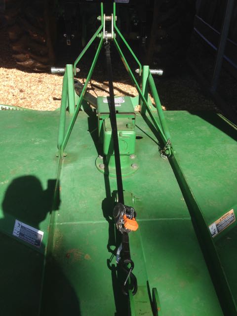

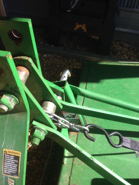

   / IMatch to MX6 Top Link Connection??
#9
i added this ratchet strap. at hook up it placed top link connection right where i needed it. problem solved...
after hook up w/ the QH i take it off. thanks for the help....
   / IMatch to MX6 Top Link Connection?? #10
Glad you figured out a fix, looks like it will work fine.
