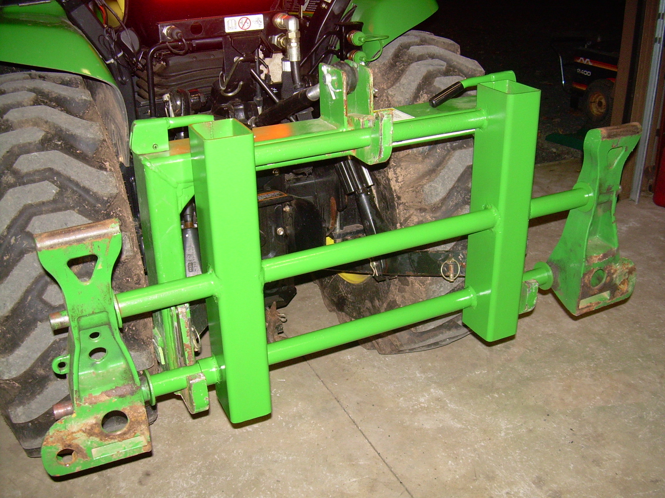

I was thinking about making an imatch that could fit on the loader of a 3720 johndeere. I know that I can order the attachment system from johndeere for about $50 and an imatch for $225. What is the best design to use to do this. I want to put my boxblade on it so I can push dirt and till the arena + more. I know it might take a while since I need to but 2 bearings+bearing housing+4 bolts, and pay for welding and painting on my 3 point forks. I might even install a 2'' reciever to move horse trailers around. what is your advice?:confused:
   / Imatch on loader? #2
I've only seen a few and I think they were bought models, you would have to start with a plate with the JD QA pin and hooks on one side then the 3 pt configuration attachment on the other.
I'd just but one if it were me, that would be alot of work to save just a little money.
I made this contraption, don't ask why, but it didn't cost me much at all since I had the loader adaptors for free. Would work great for putting loader forks on 3pt, but I already modded my forks to mount to imatch without any additional adaptor.
JB.
