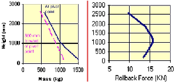

Well... instead of spec numbers, as they say - a picture is worth a thousand words. Not real good resolution, but here are the lift and rollback charts for a 430 mounted to a 4310. The left hand chart is lift - the solid line is at the pivot pin, the dashed line is 550mm forward (basically the front of the bucket). Note the values are metric, the height is the vertical axis, the horizontal axis represents lift. As you can see, even a mid-sized loader can boost a lot off the ground.

I thought for a minute that you had posted the growth chart from my 410k from last year /forums/images/graemlins/frown.gif

LOL - no I posted mine! That's the red bar in the middle! (Now is it going up or is it going down...) /forums/images/graemlins/tongue.gif
