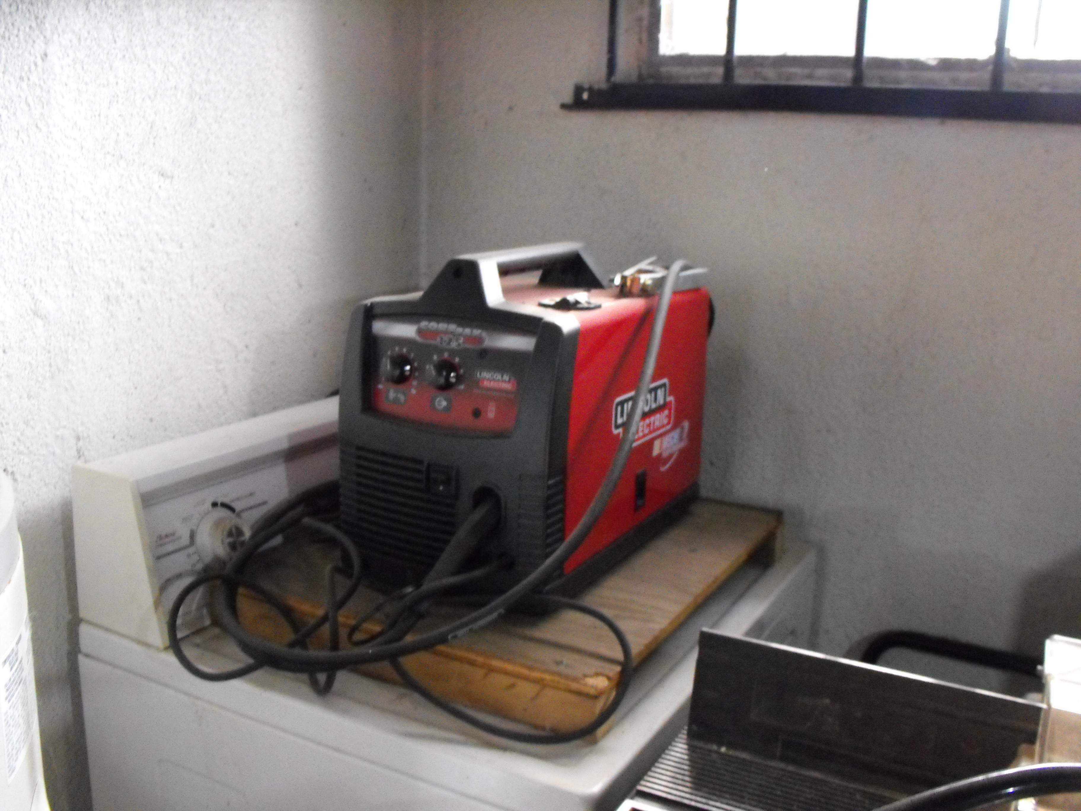

I'm wondering if my little 125 LINCOLN 120 volt will weld 1/4" stock to 1/8 "

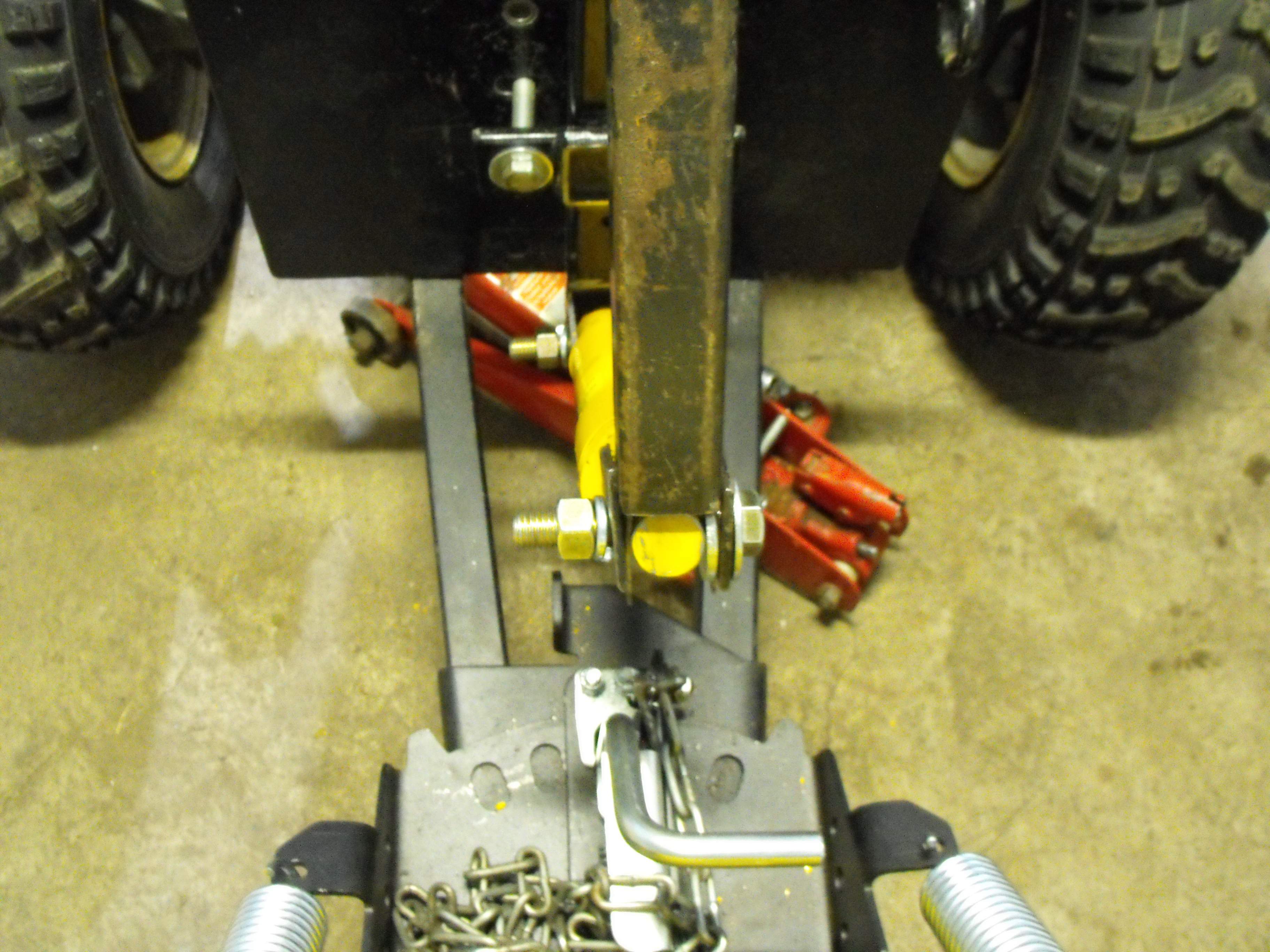

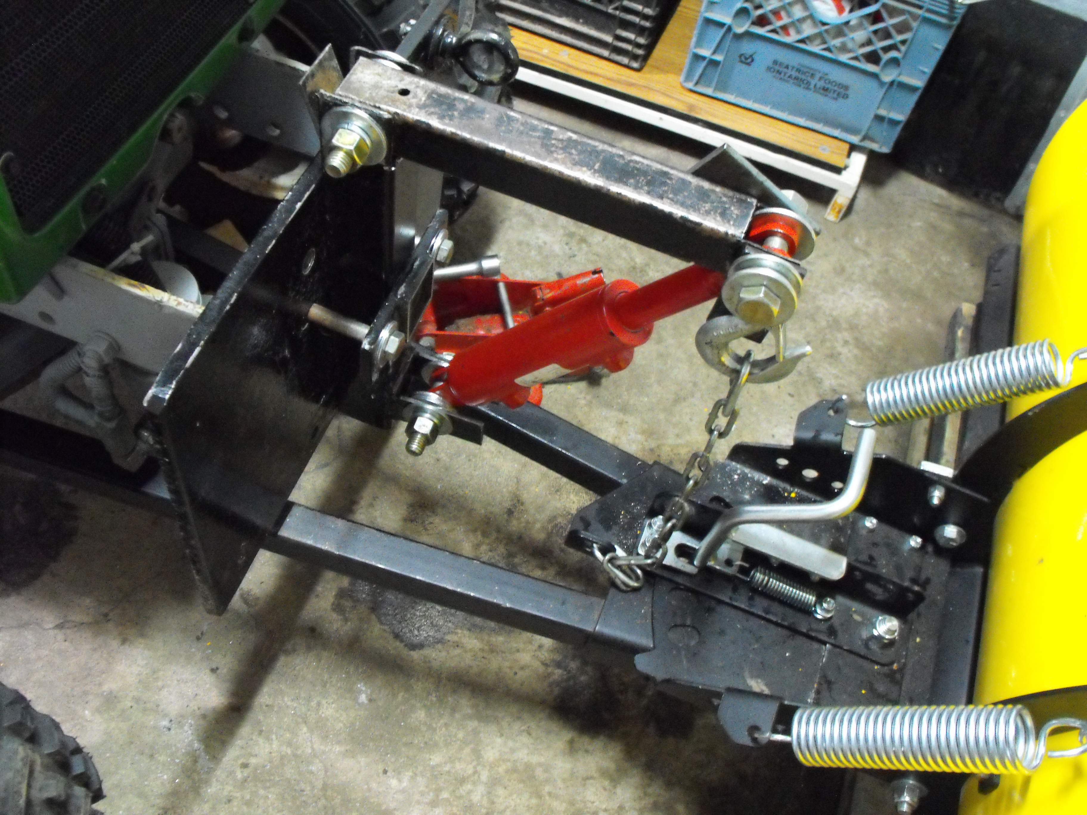

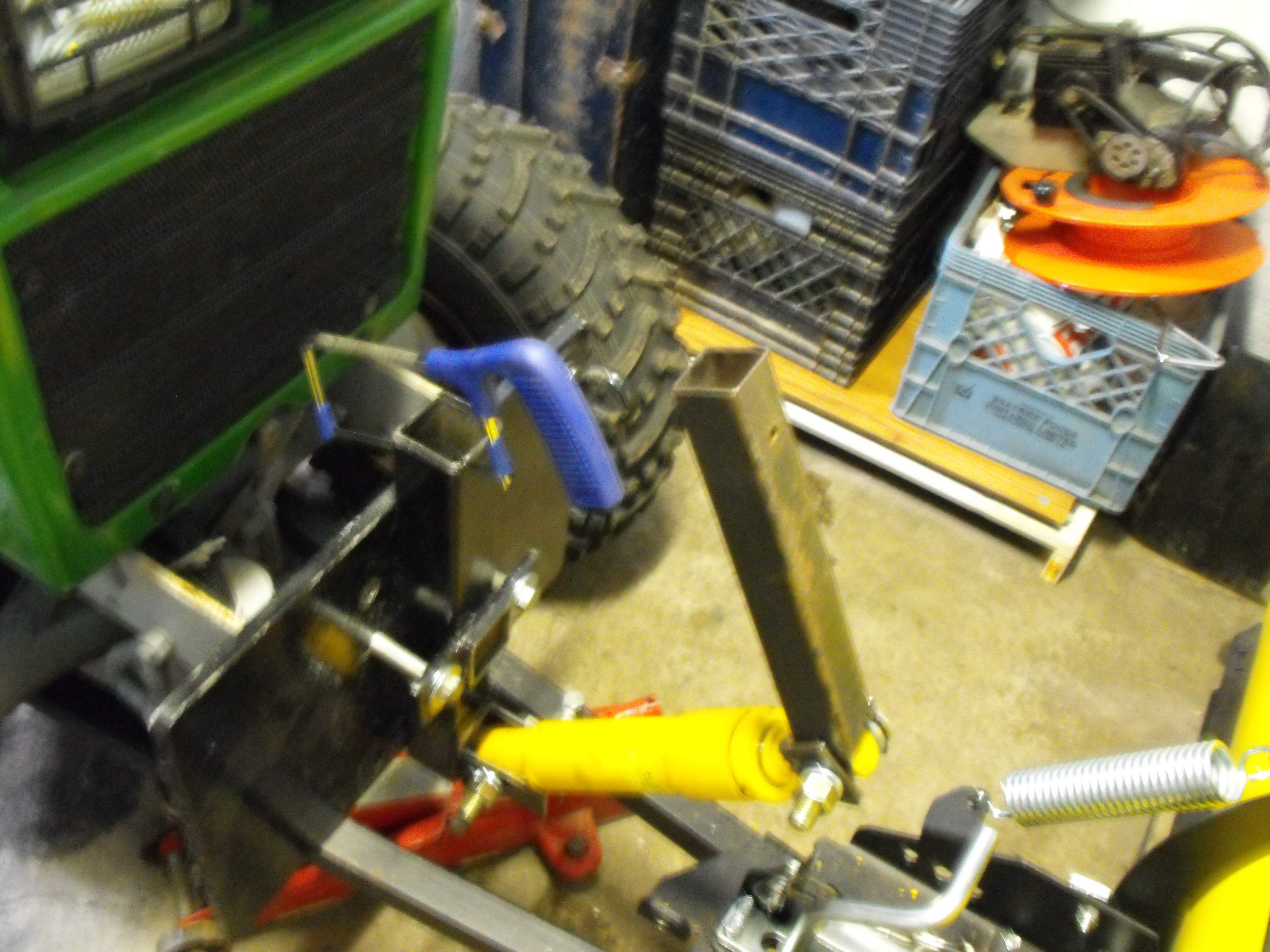

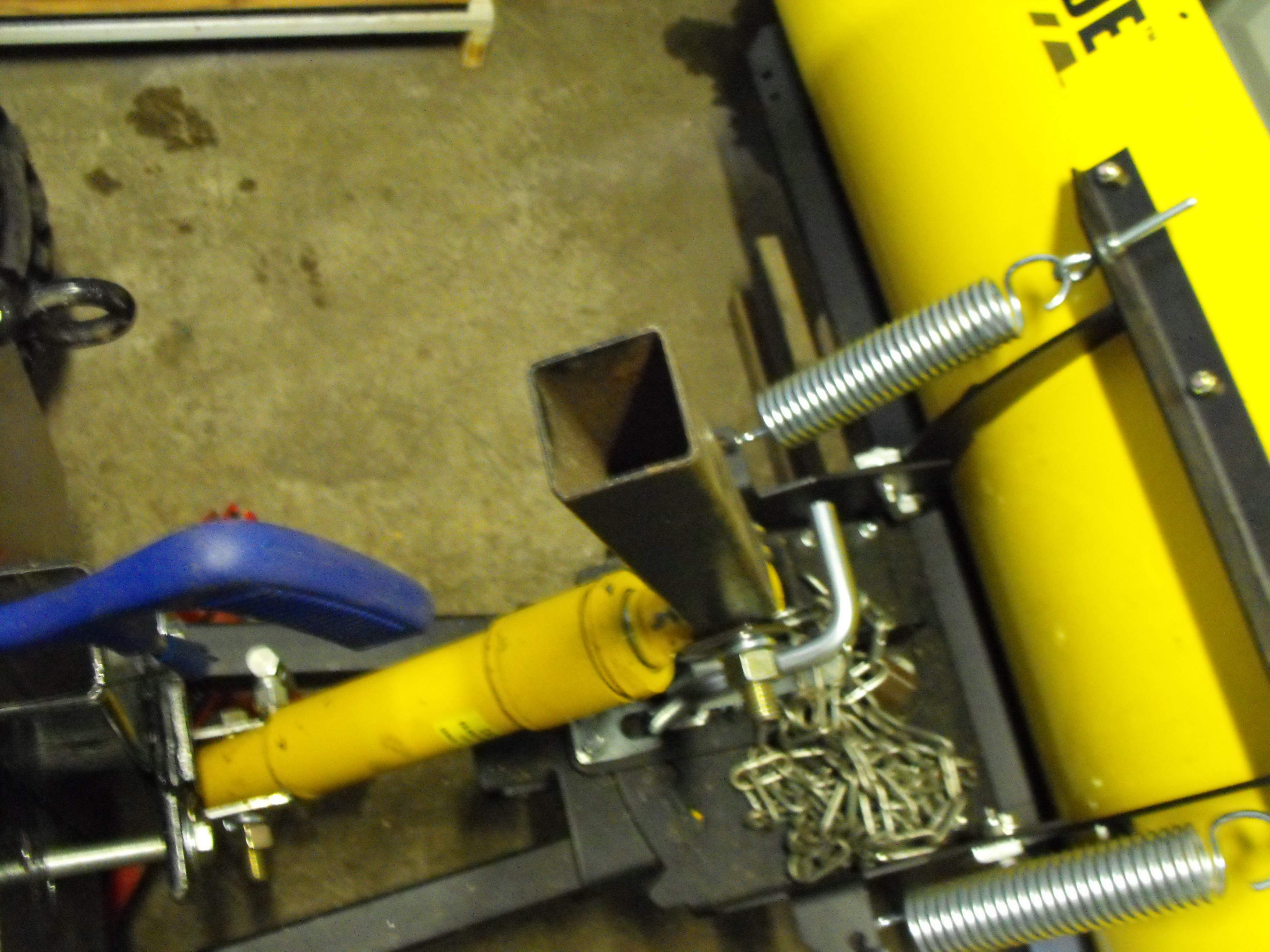

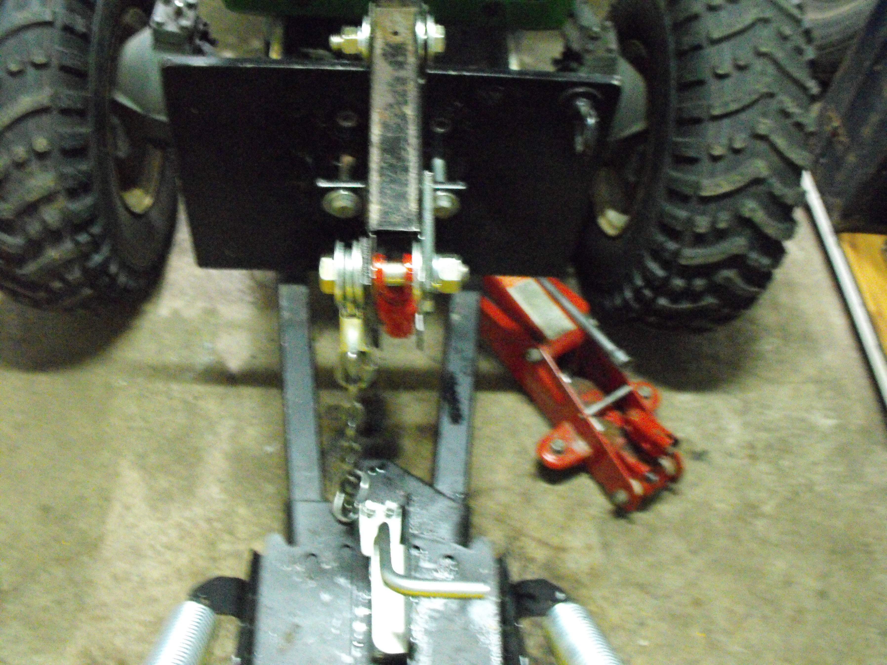

I'm gonna' include a bunch of pics of what I'm doin' here....I'm tryin' to build a kind of hoist affair....I'll be attachin' a U type eyelet hook to the bolt of the hydraulic ram..... then usin' a chain from the attachin' point of the hook to somewhere convient on the "A" frame of the snowblade....I needed something to be adjustable....and this setup seems to fit my needs to a "T".
I got this idea from an OP's snowplough setup on his John Deere tractor from a past post....I've been tryin' to use up any used metal I have kickin' around the garage...got to clean up the garage and a storage area that will be my workshop/new metal work bench and all my machinery.....so nows a good chance for me to use alot of it up and make room.
So far some made up parts are okay but some need to beefed up with either 1/8" or 1/4" leanin' more towards the 1/4" stock.... My new Lincoln is set up for wire only( flux wire core only)....I've heard that the flux core welds better but you don't get a nice clean bead like you get with gas........anyhow guys please view the pics and tell me if I'm goin' about this the correct way.
"Yes" that is a mini hack saw I'm usin' to split the metal down...for the boom to ride in.......I could use my 4" grinder slap on a 1/8" thickness 4" cuttin' disc..... but it makes too many sparks and cuts out too much metal.

Should be no problem. I have an older SP-135 and I know it would do it fine. I always run it hotter than what is listed on the chart. You will need to grind any paint and mill scale off so you get a good clean weld surface. You should probably practice a little on some scrap to get the settings that work best. You'll need to direct the heat primarily into the thicker piece.

I agree, it should work. Just be sure to concentrate the heat on the heavier/thicker metal a little more than the thinner stuff.

If you do not feel comfortable making the weld, you may TACK the 1/4 and 1/8 pieces together and have them welded.
Try a couple of welds on a T joint to get the hang of it. The fillet will have a triangular cross section, with each leg equal to the thickness of that piece, 1/4 inch leg on the 1/4 inch stock and 1/8 inch leg on the 1/8 inch stock.

Here's a two pics of my welding project....had to install a double acting ram/cylinder as the Myers ram was only single acting and required the weight of a plough(gravity to lower it)...the 48" snowblade I installed is designed for an ATV..... the blade is only about 1/8" thick....where as a 4x4 pickup truck blade is approx 1/4" or more in thickness besides bein' from 7'-8' in length.and weighing approx 300 lbs or more......Ampa

Well,if your machine works as it is supposed to,than yeah you can,,,it generally boils down to the person using the machine though,can you make a solid weld between 1/8 and 1/4 inch thick steel?

If I was just usin' my torches I don't use no eye protection goggles...but the electric wire feed....I wouldn't want to chance it.... just today I went out to Beach Road Steel Sales and picked a 18" length of 1/2"x1/2" 1/8" square tubing for the boom section.... that will do the job without any reinforcing it may even be a bit thicker than 1/8"....it's the same as the up right piece you can see it in the pic I posted.....I should have done this in the first place...only cost less than $6.
