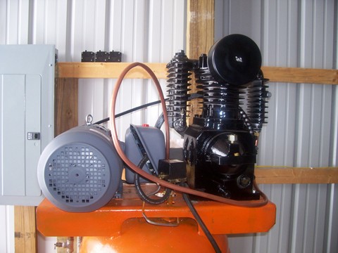

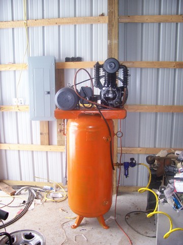

I built my compressor using a pump from the above link. I have however learned an expensive lesson about electric motors. Prior to my rebuild I started off with a 15 amp motor on a 11gpm pump it burned up in short order. I replaced it with a 21 amp motor and again it lasted another year. By then motors had gotten expensive but I upgraded to a 21 amp heavy duty motor. Eventually that pump was swapped out for a New eaton and after about 3 hr run time the front bearing went out of the motor. Recently I bought a 22 amp farm duty motor. 110lb as opposed to 22lb of the 21amp motor. I also went to a mag starter and a 1750 rpm unit. Ya, I am tired of burning up motors. But as of now this thng euns like a dream... If I had bought the bigger motor out of the hat I would not have had all the issues or down time and saved signifiganr dough....
Now your situation,,, being able to return it no questions asked,,,,, Well if ya have time I guess it would be fine. For me I need the equiptment working not working on it,,,
You will need a small pulley like 3in for that 3600 RPM motot as speed kills these pumps.
Will you be happy with 11gpm pump for sandblasting? My 11 gpm never shut off sandblasting and there was alot of down time..
Good luck, Pic of my reworked compressor is attached. Still needed to add the starter in this pic.
