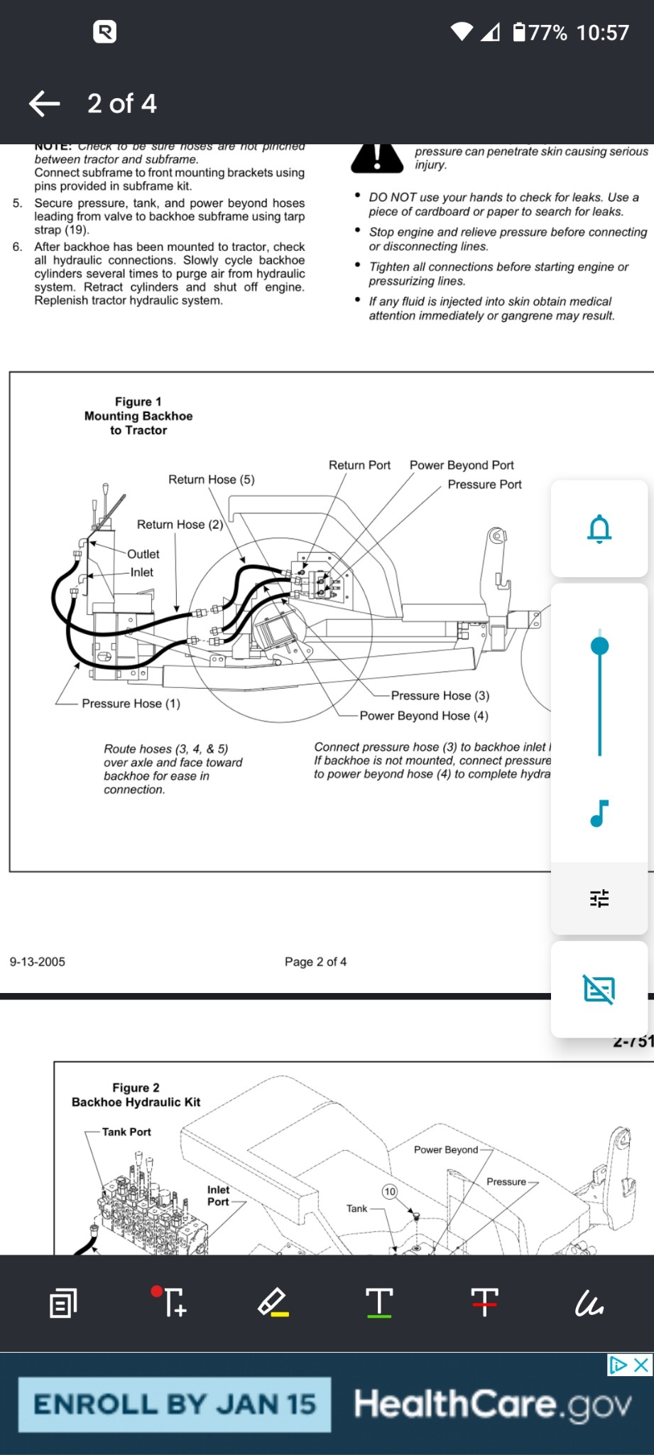

The back of my tractor has 3 connections, Pressure, Power Beyond, and Return. The backhoe connects to the Pressure and Return with nothing connected to the PB.
If I take the backhoe off, the instructions say to connect the Pressure to the Power Beyond port. I have a small hose that does just that. My question is, why wouldn't it be Pressure to the Return, just as the backhoe is connected? Instructions says to "complete the circuit" but why wouldn't pressure to the return do that?

Power beyond supplies oil to the 3 point hitch.
Most back hoe valves do not have the power beyond feature so you want the return going directly to tank.
   / I'm sure a simple hydraulics question...
So the 3 point hitch has it's own return? With the backhoe on, there is no oil to the 3 point? If so, I think I have the flow figured out in my head. This is a snap of what caused my confusion.
Correct with backhoe mounted you do not have flow to the 3 point.
Thank you sir, it all makes sense now.
