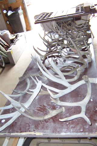

I picked out the largest ones for the bottom. There is one large five point antler shed and several realy good 4 point sheds.

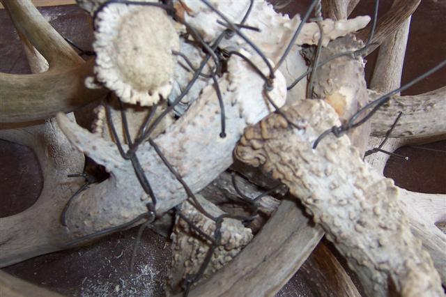

I scratched my head for a bit on how to connect them. Bolts didn't seem very practical and screws seemed like they wouldn't work either. I looked around and saw a roll of rebar wire that I never use for anything.
Easy to cut, it twists tight and it wont cost me anything to use it.
I just lined up the anlters and drilled a hole through them. Cut a piece of wire, then fed it through the hole and twisted it tight. As I move along, I cut off the excess wire, but only after the next row of antlers is on. I've found a few line up with the previous holes.

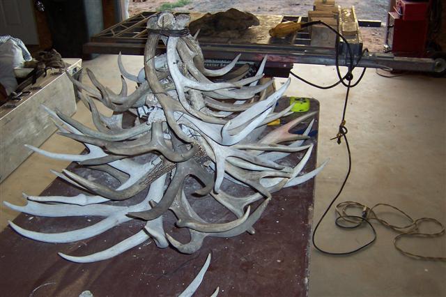

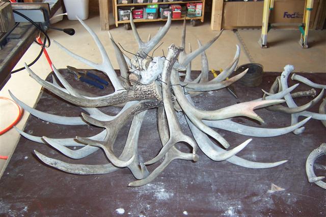

Here's the basic look of the chadelier. I wanted it to be bigger at the bottom and get smaller as it got taller.

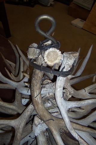

This is a hook off of a nylon ratchet tie down that got cut and ruined. I saved the hook for an unknown reason that turned out to be this.
I also wrapped the ends over and over again to get a certain look I wanted. Then I did the same with the hook. I'm hoping it all ties together and looks good when I'm done.

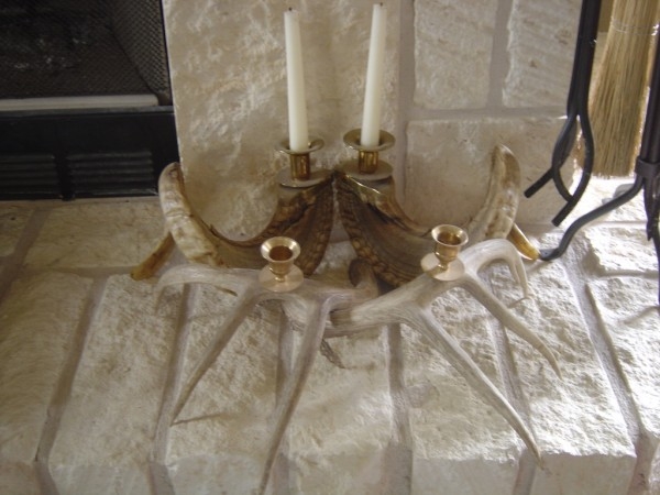

You need to make some "redneck" candle holders (that's what my wife calls mine) to go along with your chandelier and dress up your dining room table. Here's a photo of the two different ones I have.
The set of sheep horn candle holders I bought at a gun show from a guy that needed money. The deer antler pair I made. I clumped them all together for the photo, there are 4 separate holders (a pair of sheep and a pair of deer).
BTW: Rub the antlers down with "Old English" to get the color back in them.
